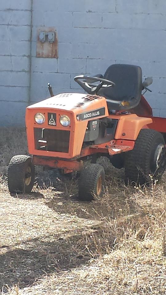

I just purchased an Agco Allis lawn tractor with the mower deck, snowblower, and tiller attachments.  I have 2 questions.
1) The model number is pretty much rubbed off of the sticker.  Any other ways of identifying what it is?  It's old, orange, 2 round headlights, 18hp briggs & stratton motor.  Here is a photo.
2nd, I got it running pretty easily and noticed the belt had come off between the the engine and the "transmission."  Got it put back on easy enough but now when I start it, it just clicks.  I just put a new battery in it.  I'm thinking it may be the starter though the "TPO Disengage" light keeps coming on as well.  Any suggestions?

Looks like an Allis Chalmers 800 Series with different stickers. The Agco and KHD stickers don't match each other and the wheels are white like on an AC. The deutz and Agco tractors would have had silver/gray wheels.

This is just a good guess.
That does look like an Allis Chalmers 800 series.   T-818.
Should be pretty much the same as a Simplicity 6200 series.  6218
For parts your dealer should be able to help you with these manufacturer numbers.
Allis Chalmers  1690698
Simplicity         1690695
