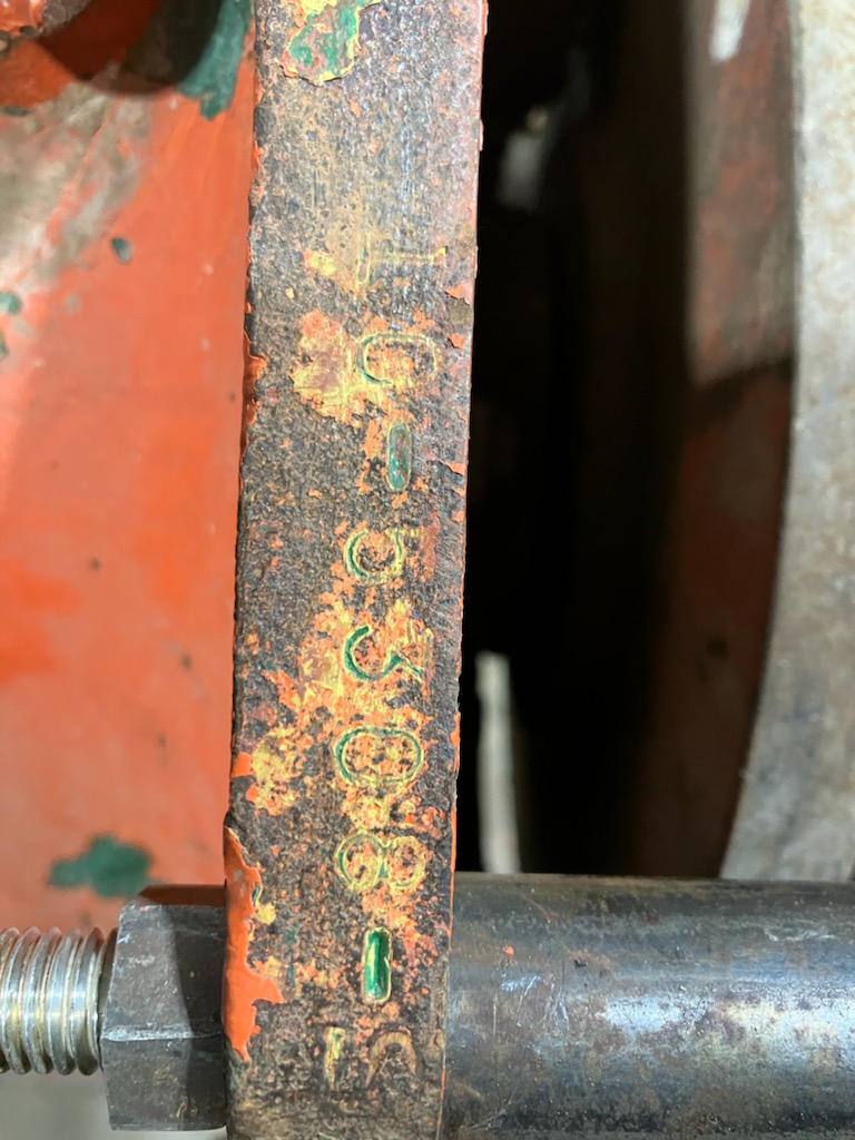

D-10/ 5308 serial number should make the engine a G-149 cubic inch power plant. G-138 cubic inch was prior to D-10/ 3501.

what is the dash backwards 2  or5 on the end of the serial number ?  will this fit in a B or a C ?  i  bet this was one of those backwards tractor forklifts

The serial number is 10- xxxx not D-10, This makes it a 138 engine. The tank when the engine was installed in a tractor was used for the non draft sensitive live hydraulics.

If that stamped number (5308) is the chassis serial number, effective 10-3501 was the start of the G-149 engine. So, unless there's something I don't unnerstan, 5308 is newer than 3501.

tonight i will measure the bore and stroke the was allready off it  but i do have the pan

Stroke is the same 138-149-160. The bore is different between all three.

3.50 bore , now will this bolt in my c
