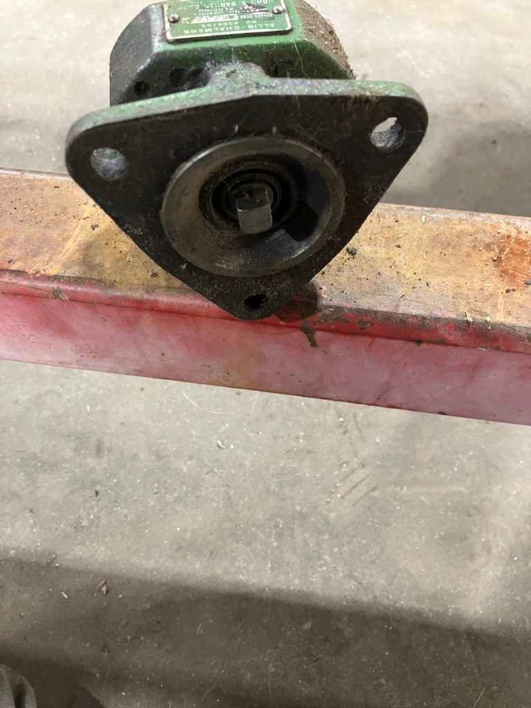

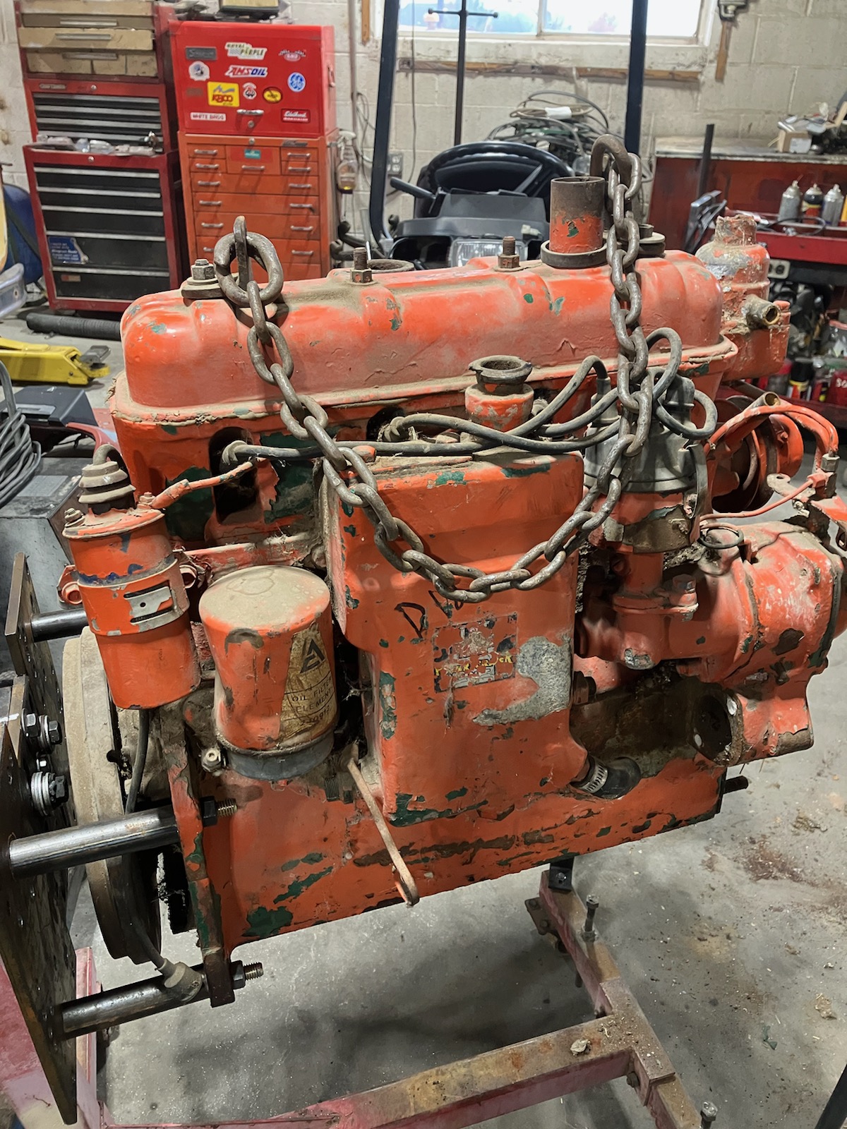

i picked up this engine and pump with some other parts pump dosnt fit that engine   , what is the engine  and what is the tank on it ? also it has a oliver looking color green paint that is under the orange.   will this fit in my c ?  was this some military spec. engine

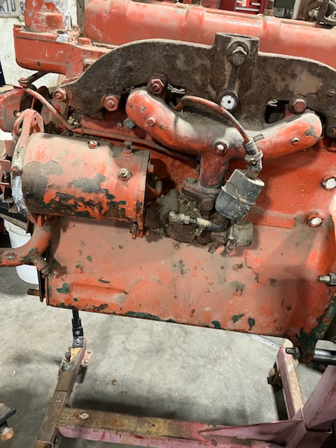

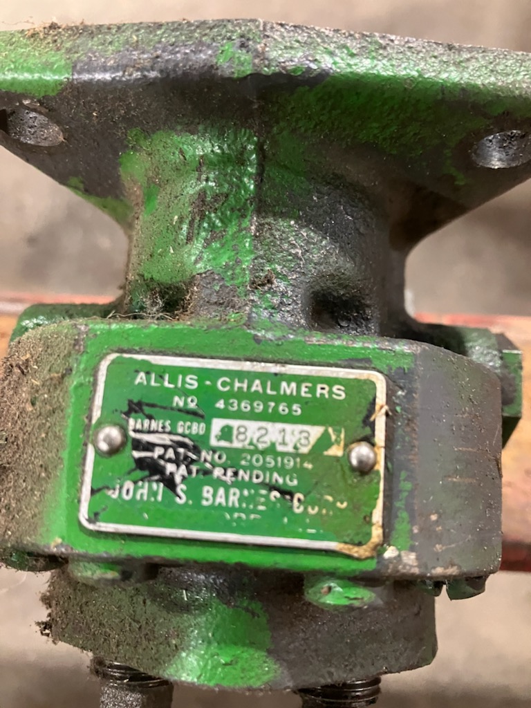

There should be a s/n stamped on the engine behind the carb or on the left bell housing flange lip.  The engine looks to me like a G-138 or G-149 to a D-10 or D-12. The Barnes pump has a diesel p/n on it. So, maybe a WD-45 or D-15 diesel ? The square drives shaft looks like an old Detroit diesel engine, but the p/n is clearly Allis-Chalmers.

Very early series 1 D10-12 engine.Is it for sale? Thanks, Tracy

that pump does have kind of a detriot color on the other side
