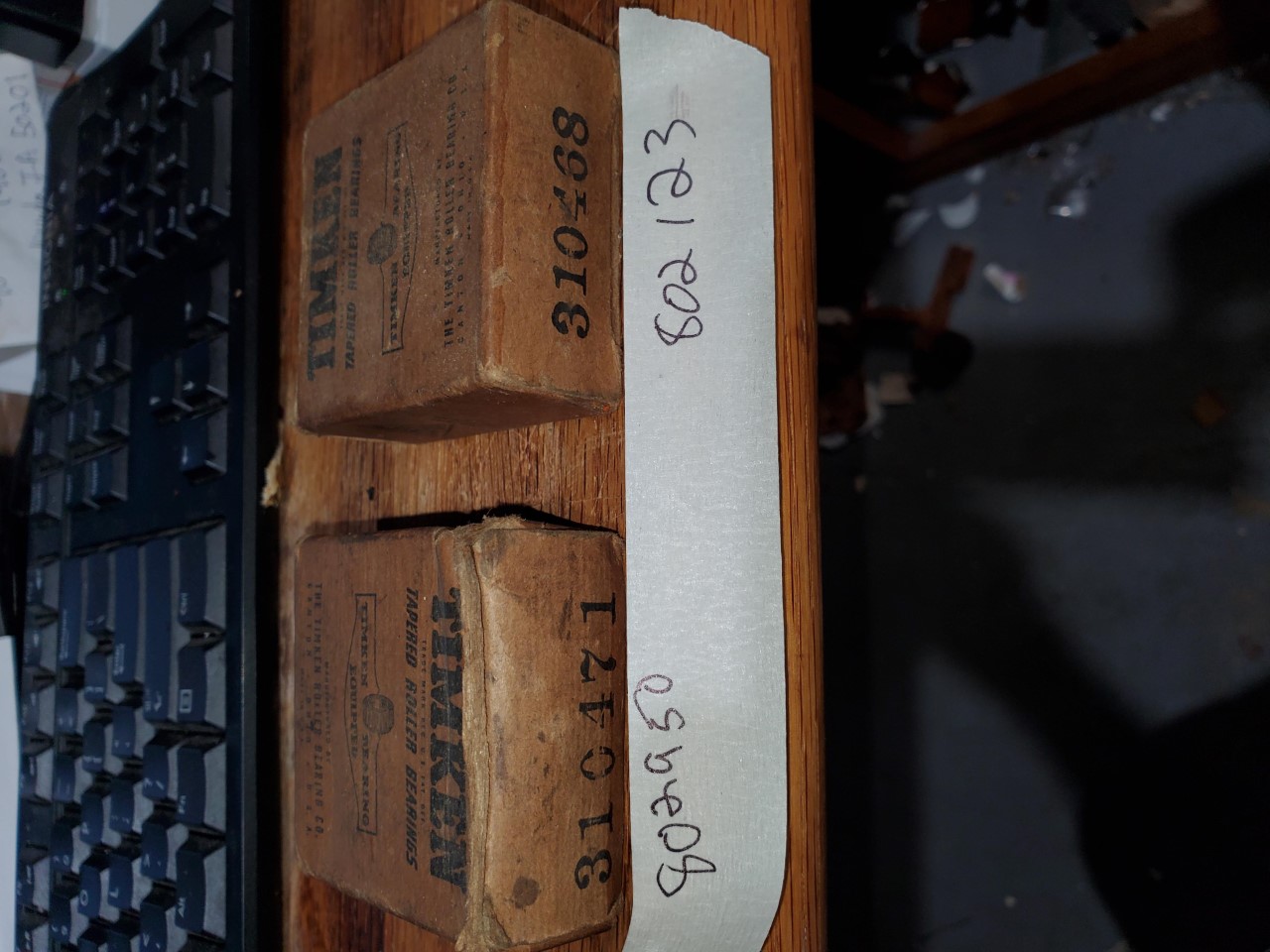

So I got a bunch of NOs parts I am trying to ID....
Got these bearings...cross over to a 8xxxx number, but lost after that.
Any clues what they go on to?

802950 is B/C/WC/RC mower
802123 fits #3/4/5/B/C/B industrial mowers

They are bearing cones used in the tubes of the Pto drive shaft and the pitman shaft/tube of the older mowers....3/4/5/B/C/WC  etc...Dale
