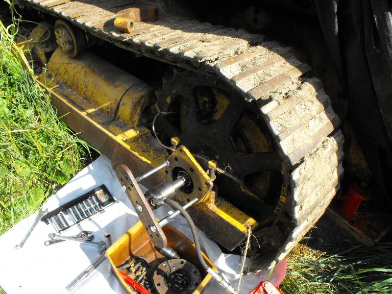

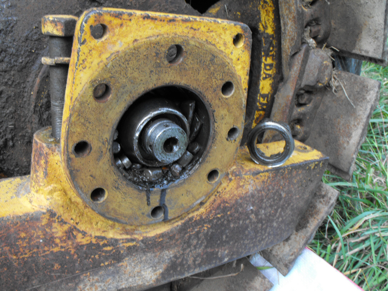

Last time I used my HD6G I noticed final drive oil on the sprocket.
It shouldn't take long to replace the outer seal RIGHT???
I need both internal and external Nu-Thread. The hex nut doesn't have 6 points it is sorta rounded.
Is there any way I could cut another thread and fabricate a special nut?
Any suggestions???
Enjoy the pictures

Post Options Post Options   Thanks (0) Thanks(0)   Quote DiyDave Quote  Post ReplyReply Direct Link To This Post Posted: 27 Aug 2014 at 8:17pm
You could re-thread it smaller, but you gots a whole heap of dis-assembly and inspection to do first!  Bearing surface is prolly buggered up, too...
Points: 55299
Post Options Post Options   Thanks (0) Thanks(0)   Quote DiyDave Quote  Post ReplyReply Direct Link To This Post Posted: 27 Aug 2014 at 8:44pm
If the bearing surface is OK, Here is what I would do:  Put a bushing in the center hole, and take a new hole saw, and cut off the old threads, then re-thread it.  Important part is sizing of the hole saw, and finding a standard size fine thread die.  I'd try them out on a sacraficial piece of aluminum scrap shaft.  Still gonna be a bugger to get it started straight...
Points: 55299
Post Options Post Options   Thanks (0) Thanks(0)   Quote DiyDave Quote  Post ReplyReply Direct Link To This Post Posted: 27 Aug 2014 at 8:47pm
Oh, and get the new bearing and seal, and possibly a speedy sleeve, if the seal surface is buggered... Have them on hand, prior to any cutting/sizing decisions are made...
Location: Gallatin,TN
Points: 10937
Post Options Post Options   Thanks (0) Thanks(0)   Quote Tracy Martin TN Quote  Post ReplyReply Direct Link To This Post Posted: 27 Aug 2014 at 9:03pm
It can be threaded and special nut made. Needs to come out, take pics and post. Might be a nut close enough that you can just rethread the shaft. Might be cheaper to get a used part. HTH Tracy Martin

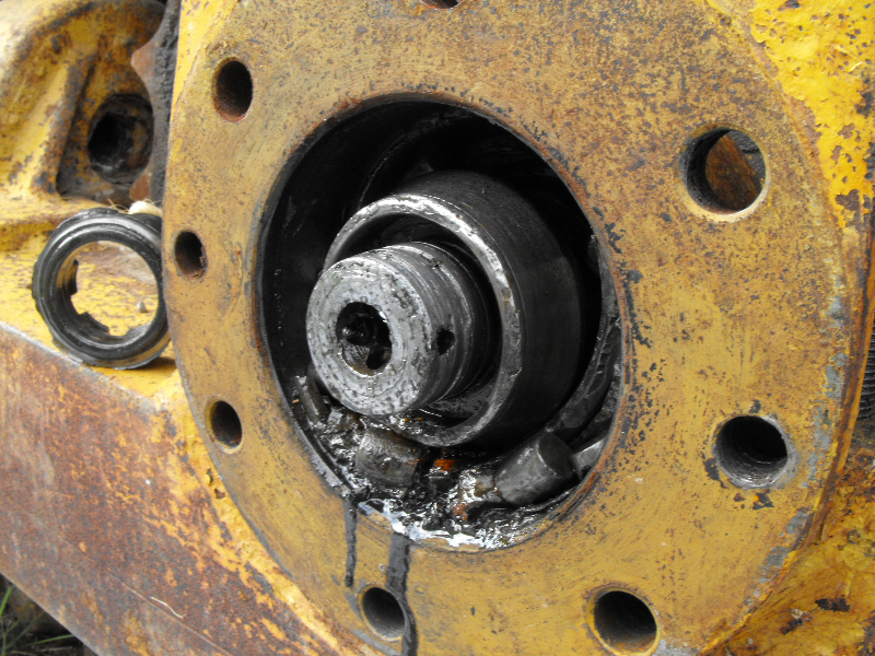

More pictures: Today I removed the outboard bearing cage. The bearing surface on the sprocket shaft is not damaged. The threaded area is 0.10 undersize. I can file the shaft so it is below 60 Rc. I am considering welding the shaft and recutting the 1 1/2-12 thread. To do this I need to move Allis to where I can weld. (sugestions ???) I'm considering TIG welding with 304 stainless rod. I have had luck welding on high carbon steel without the weld cracking. (sugestions)

Post Options Post Options   Thanks (0) Thanks(0)   Quote Coke-in-MN Quote  Post ReplyReply Direct Link To This Post Posted: 28 Aug 2014 at 3:11pm
I removed the full axle , put in lathe and re threaded shaft to next size down .
I also have a complete axle from HD 5 (same as HD 6) which is std size here .
Welding can have problems as it changes stress points in axle and can lead to failure . Had 3 HD4 axles break where they had been welded to build up seal surface area but crystallized material which led to failure.

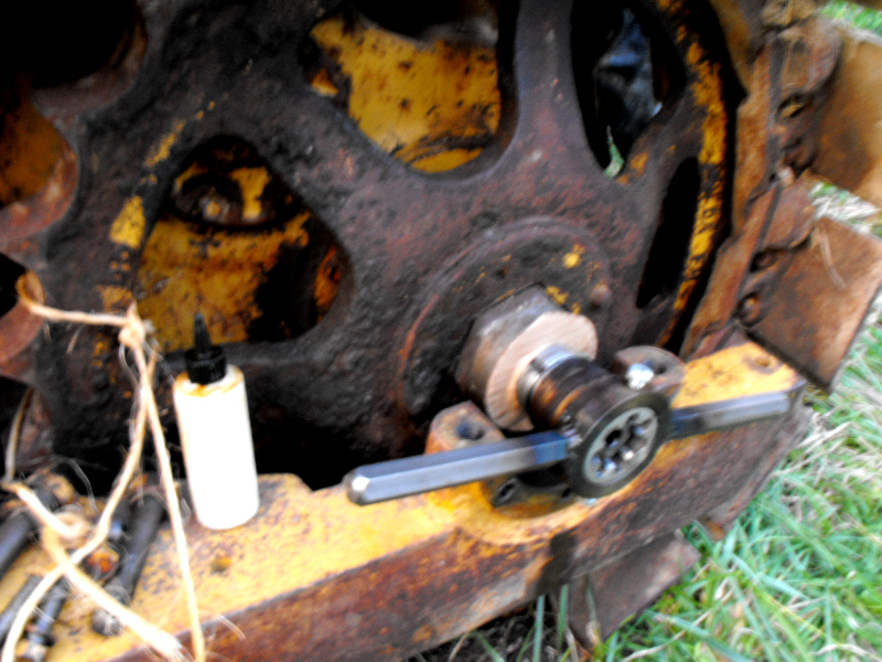

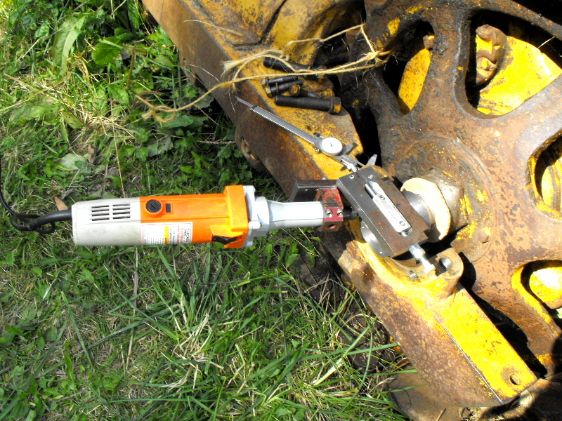

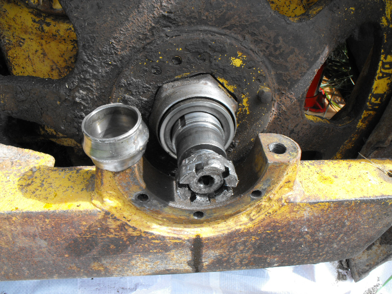

The repair is complete. I made a fixture that locates on the bearing surface and holds my diegrinder to cut the damaged threads down to a smaller sized thread. The fixture is adjustable for cutting the shaft diameter using a carbide burr. It is manually rotated and translated on the bearing surface.
The original 1 1/2-12 thread was recut 1 7/16-12. This is a standard size but I was unable to find one. I located the 1 7/16-12 tap and die on eBay. I made the special castle nut.
I made the die stock to locate on the bearing surface so that the thread would be aligned properly. I cut a 1/8 NPT thread in the bearing cap to pre lubricate the bearing. Thanks to everyone for comments.

I really like that ingenuity... Better hang that handy dandy tool up on the wall for the next time somebody has the same issue with theirs...  Then rent it out and make a fortune selling those "special nuts"
 I like the die grinder idea too, but I think I would have opted to have a carbide cutter to be put in the tool you made for cutting the threads down, then put the die in and finish the job... I applaud you in your success. Best part, you had pictures to show too...
