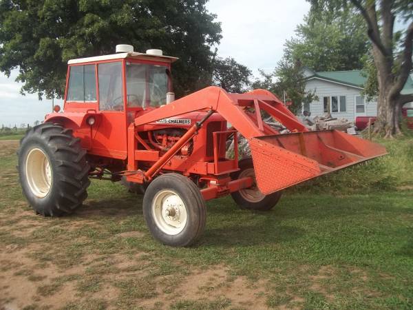

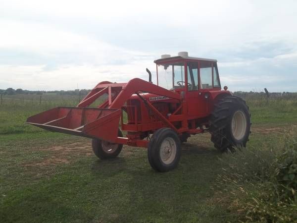

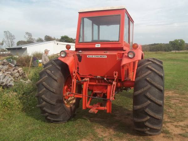

Help me out here guys, What is actually under the hood? I dont see anything other than the hood and grille that are actually WD, but what is it? Its got me puzzled. Here is the craigslist link.

Really don't look to bad, looks like a D19 motor, the fenders look very familiar but can't put my finger on it at the moment.

combine axle?? wd or 45 frame and hood maybe a diesel hood. d series rear end i think just from the first look

Yeah, bolt on rear wheels wouldnt be D19, maybe D17IV or ?? Like I said, its a puzzler... Thats why I called in the experts! I bet you whoever did the work was PROUD of it, and I cant blame them. From the pictures Ive seen a lot worse cobble jobs, and I bet it did just what he wanted!

look close it has drawbar and bail, pto, rock shaft and lift arms and center plate all 45 stuff. it is a 45 rear end. the 3 point is home grown. fenders look like they came across the pond either 50 something series allis or some other color that floated across and fuel tank made to look like a 190. steering probably hydro like numbered series allis or combine, loader is for sure a freeman made for allis with homemade bucket and engine appears to be buda 230 out of A combine or 262 out of 19 gas

the fenders are from comfort king case tractor 730-830

It is a WD with a 230-262 combine engine.    MACK

Looks like they used engine, steering and front axle from the combine, perhaps the cab as well, or perhaps cab and tank came from a hundred-series (170, 200, etc). The six is clearly not a Chev (manifolds on right, not left), so probably the Buda.
The three-point system has bars for ersatz draft-control, probably works fine for moving bales and running a box blade. Notice lower windows not present on cab... and only door on left side, so it's not same 'full vision' as mine. Notice that the front axle pivot leaves the frame area open- he's probably got the hydraulic pump mounted in there like I'm doing with Schwartz.
I like it- nicely done! I'd like to see how he did the controls... pedals, shifter, etc...

The tank definitely looks hundred series. Might the cab be a homemade or from another color? Either way I see some things I like and some I don't but it's different

The fuel tank is NOT at all like the tank on my 190.
It kind of looks like a transfer tank to me ..... don't know for sure

Looks nice, those are case fenders I believe

Fuel tank makes me think Ford 8000.
