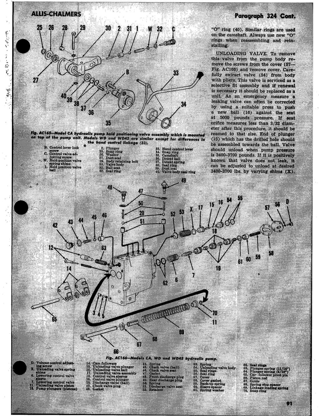

Where is the best place to get a diagram of my hydraulic pump for a 1958 allis chambers ca… mine is not working so I’m trying to repair it. Thanks

I just downloaded the PDF version, opened OK, very good zoomy of the pump.....
I KNOW that one of those 'ball bearing' check balls FLEW out at Warp7.5 one day and it tool me almost 2 HOURS to find it on the 'grey' concrete garage floor so....
#1 clear off the entire workbench
#2 lay down a nice white sheet( best BUY one.....)
#3 add LOTS of GOOD lighting
#4, take pictures 'along the way'.......
#5 clean all the passages 2-3 times (one was 'stubborn'......)
#6 clean out the 'hole' pump sits in 4-5 times(sludge in bottom...)
hope this helps

The operator's manual has a breakdown of the hydraulics and other components.
