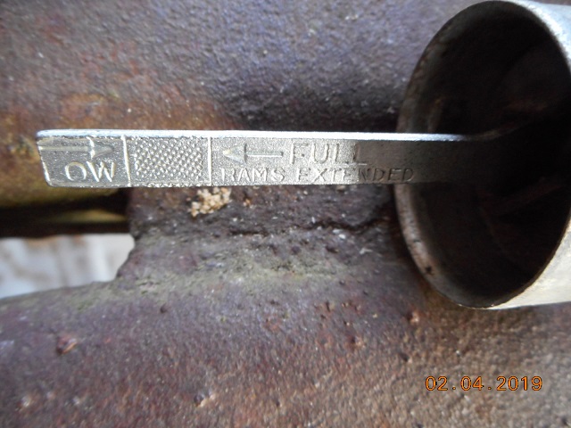

When do you take the reading on the dipstick that shows low and Rams fully extended?
Do I take the level with the dipstick screwed all the way down and tractor and PTO engaged or tractor off Rams fully extended?
Post Options Post Options   Thanks (0) Thanks(0)   Quote CTuckerNWIL Quote  Post ReplyReply Direct Link To This Post Posted: 04 Apr 2020 at 3:18pm
Rams extended, engine off, fill to full mark when dipstick is locked in.

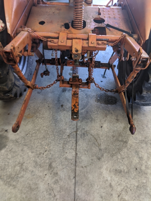

Ok, so when I install/run my trip loader bucket on the ca, I'll have to connect the cylinders into the rear axillary port.
How do I "lock out" the rear lift Rams so when I operate the front bucket the rear lift cylinders don't go up and down at the same time?

Post Options Post Options   Thanks (0) Thanks(0)   Quote CTuckerNWIL Quote  Post ReplyReply Direct Link To This Post Posted: 05 Apr 2020 at 8:17am
I never saw a CA without the lift arms and cylinders. I don't think there was a factory option to delete them.
 Yes your cylinders were factory installed, but no CA ever had a factory installed 3 point hitch.
 As far as using a loader and having the 3 point hitch separate, you will have to buy a diverter valve. Use only one source from the hydraulic pump, to supply the diverter, then connect both lift arms to one output, and your loader, or remote to the other output.
 On my 45, I removed all connections to the hydraulic valve, plugged 2 of them and ran the other to my add on valve. Both lift arms connected to one side, and the loader rams connected to the other.
 I can raise the lift arms with the blade on, flip the valve forward and use the loader, while keeping the blade up. Stop the loader at about 3 feet high and flip it back, and the lift arms are used while the loader is held up.

Sorry, I was thinking of the original style drawbar where the cylinders were unhooked from the lift arms, arms swung down and connected to the drawbar. Then cylinders were then pinned into different holes in the arms. Won't work with your 3 point. A diverter valve as CTuckerNWIL posted would be best, as then you can use either by changing the valve position.

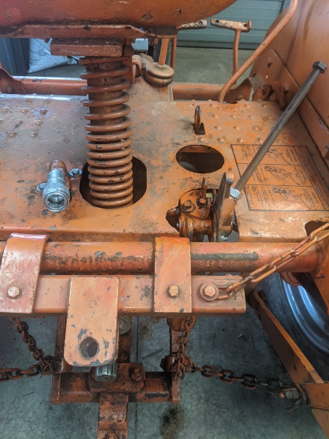

If I were to be in a pinch and connect the front loader via the silver quick connect on the left side of my picture, would the front loader still work (I know the rear would be going up and down at the same time but I just don't know if I have time to get into repiping and buying the material for the diverter right now...)
Edited by Hunt4Allis - 05 Apr 2020 at 11:56am

Yes, it would work, raise and lower using your tractor's existing valve. Does your loader have a control valve on it? Doesn't need one.

The only control that I have is the one coming directly out of the pump in the right side of the picture

That's good.
