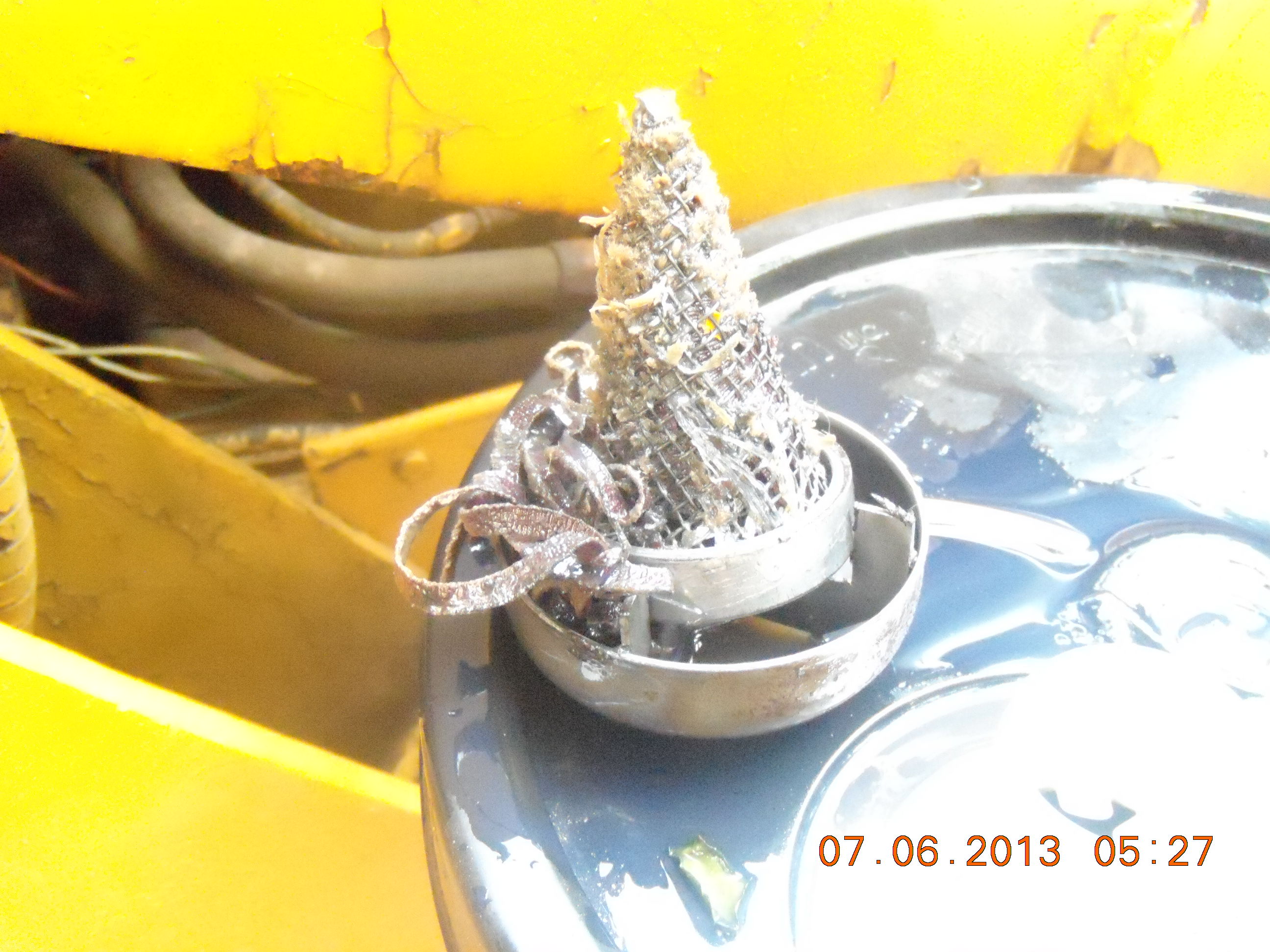

The only filter on this machine I never checked, until now. Geeeeez....

 Notice the baloney peel looking strips. Maybe the end packing of old filters?

 Well, I repacked all the rams yesterday. Pretty straightforward except the lift packings were TIGHT! But now, no more creep-down on the boom. I retested the backdragging and bulldozing holds and now I only have roll-over when dozing. That's why I always ended up digging holes instead of scraping dirt. I'm going to attack that dozing safety valve after I test it's yield pressure. I'm getting close to having this machine fully cured.
