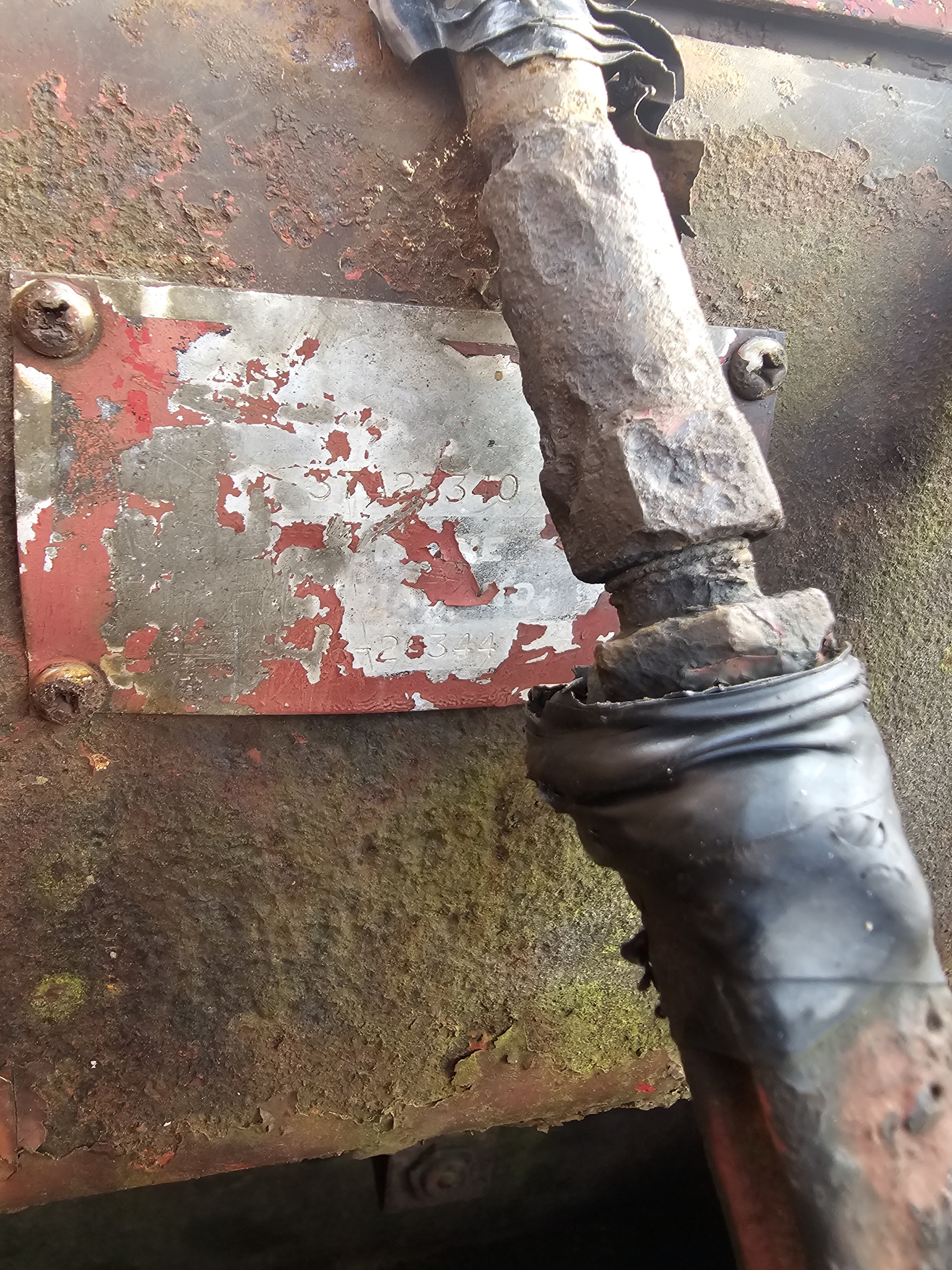

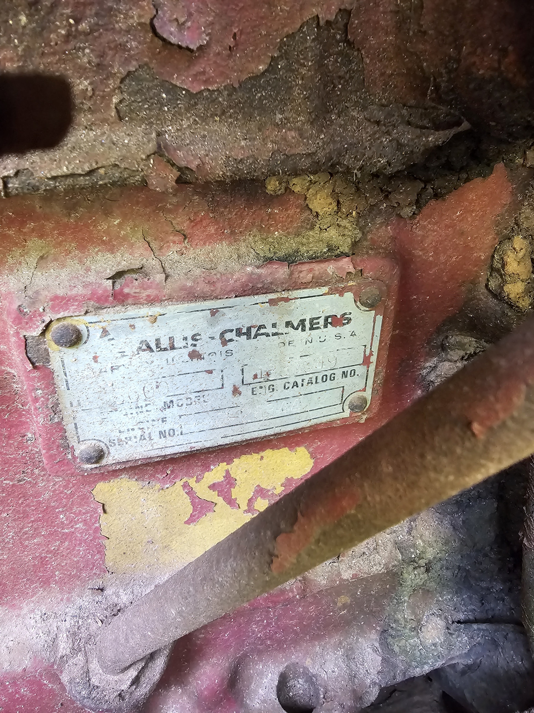

It's a 1962 model the places it says the serial number is it worn off

Post Options Post Options   Thanks (0) Thanks(0)   Quote Jhilton69 Quote  Post ReplyReply Direct Link To This Post Posted: 02 Aug 2023 at 6:01pm
These are the 2 plates that's supposed to have the serial numbers I see 1 of the numbers looks like it's on both plates. Is this the serial number

Post Options Post Options   Thanks (0) Thanks(0)   Quote doctorcorey Quote  Post ReplyReply Direct Link To This Post Posted: 02 Aug 2023 at 8:42pm
Originally posted by Jhilton69 Jhilton69 wrote:
Looks like 23xxx, so it is post split. Hoses go to same hydraulic tank ports on both early and late models
