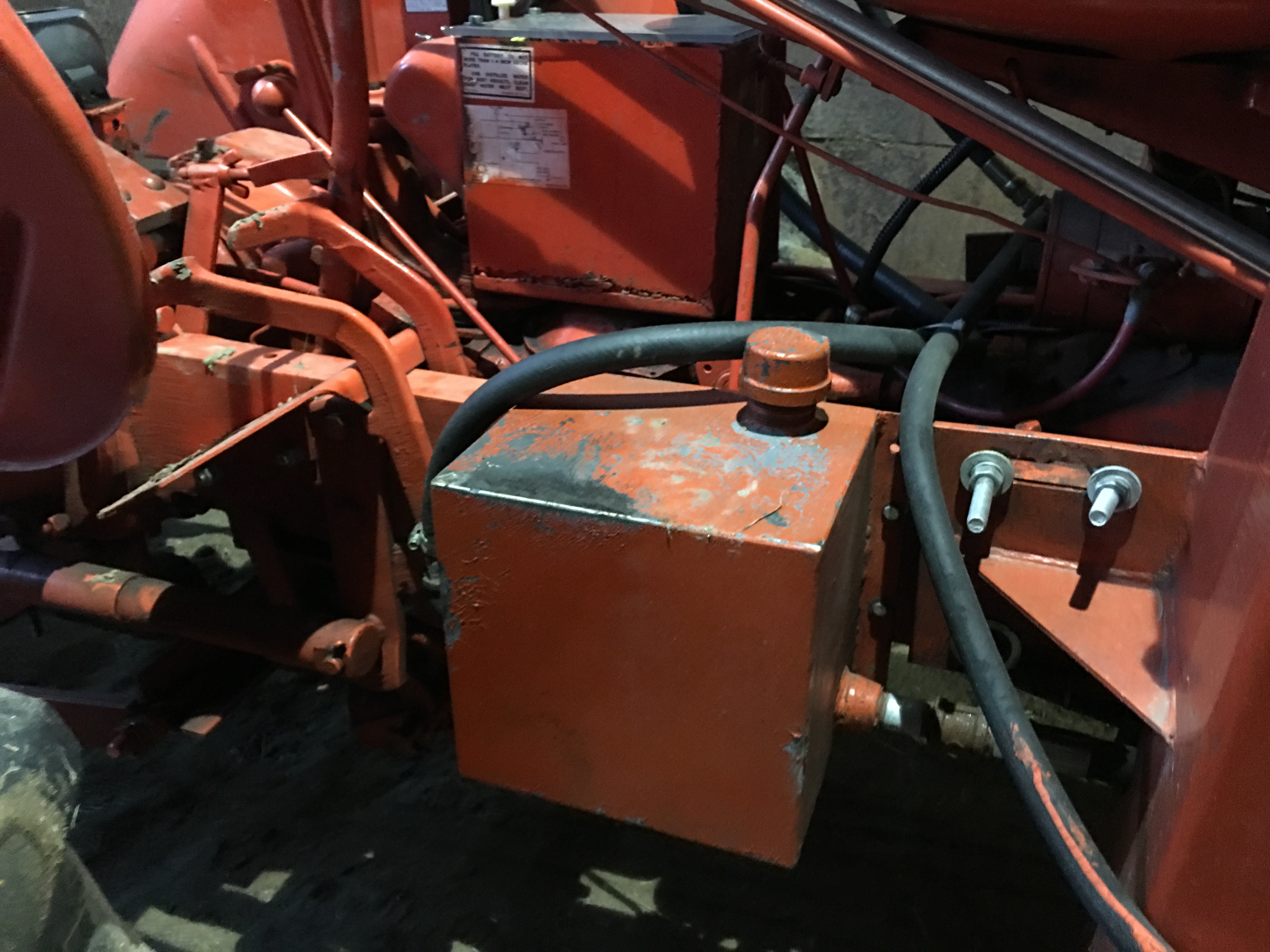

Hi all,
I just bought an Allis chalmers wd 1950's I believe which was converted to live hydraulics for the loader that is mounted.
I'm changing all of the fluids and I'm stuck at the hydraulic fluid. I don't know where the plug is to drain the hydraulic fluid. There's a box (reservoir) to the right of the tractor that holds the hydraulic fluid. It looks milky and low but there is no drain plug on the box (reservoir). If anyone could tell me how to drain the hydraulic fluid I'd appreciate it. Thanks in advance. IMG_9150_2017-08-30_08-19-42.JPG
Edited by D-Rock - 30 Aug 2017 at 8:19am

Well....how thick of material is the box?  You could drill a hole in it if it's thick enough to make a decent plug of some kind.
Or, you could siphon it out.  And no, you don't have to suck it into your mouth.  Take a hose long enough to put one end in the tank, and make a nice U shape in it where the top of the U is as tall as the tank.  Fill the hose with oil so that you fill the U.  Drop the end of the U down below the tank into a container, the falling oil will create enough vacuum to siphon out the tank.  You won't get every last drop, but it should be OK.

Thanks for the quick reply Tbone. I was wondering if I'd ha e to siphon it. The material should be thick enough to add a plug but for now I think I'll siphon it. Any idea on how full of hydraulic fluid the tank should be? Right now it's just above the hoses that run into the box, but the tank is only about 1/4 full.

Well Mr. Rock, to be completely honest, I have no clue.  Perhaps very incorrectly, I assumed your system you're asking about is a bit on the "home made" side.  If you could post a picture, maybe it's an aftermarket system somebody on here would be familiar with.  I was just trying to offer a little advice from "Get By Engineering Company"LOL
So, if you want me to keep guessing, how much oil, enough that it will fully raise the loader, and not so much that it overflows the tank when the loader touches the ground.  I'm not trying to be a smart aleck, just might take a little trial and error is all.

Welcome to the Forum. You could remove the reservoir and turn it upside down to drain it out of the fill opening but if you go that far you might as well weld in a drain plug for the nest time. With the loader cylinders collapsed fill it to within a few inches of the top especially if you plan to use the loader much.

Tbone, I also assume it's an aftermarket system. I appreciate your input! I'll try to post a pic but I tried earlier and I don't think the pic posted.
Hubert,
Thank you! I'll get around to adding a drain plug at some point. Thanks for letting me know how far to fill the tank. I will be using it frequently.
Here's the pic (if it works)
Points: 53979
Post Options Post Options   Thanks (0) Thanks(0)   Quote DiyDave Quote  Post ReplyReply Direct Link To This Post Posted: 30 Aug 2017 at 6:40pm
I'd use one of these, to get oil out:
Its a handy gadget to have, and mine has served me well.  Get the old stuff out, Then drill and tap in a pipe plug, on the bottom...
I would leave about 2" from the top, at least, when refilling, maybe more, if your area is hilly...Wink
Adter seeing the pic, I'd also drill and tap in a breather fitting, on the top of the tank, too. lets the fluid expand and contract, as volume changes, with temp...Wink

I ended up unbolting the tank from be frame and tipped the tank to empty the fluid like Hubert suggested. It worked great but took some time. I filled the tank with new fluid about 3/4 full since I my land is hilly in areas. Next time I change it I'll be adding a plug and I like the breather idea also.

All you need for a breather is cut slots in the threads on either the cap or the pipe it screws on just down deeper than the threads.
