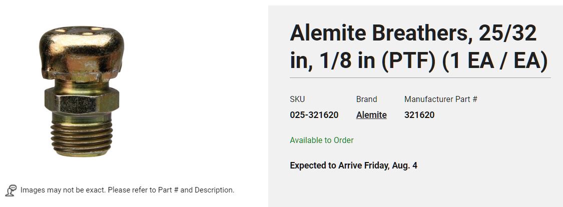

I use something like this.. Normally has a steel wool filter crammed in the end, and a loose cap to keep the dirt out... Like you put on the axle of a car to keep the differential from building up pressure as things warm up..... i have a couple on the wing cylinders of a BatWing mower.... POWER UP, and float down.. If you get any internal leakage past the piston seal, this will let it leak out.. Also lets air go in/ out as you raise/ lower.

Is a 'Bleed Valve' and a 'Breather' the same thing on a Hydraulic Cylinder ?

curious...., just HOW can you have a 'breather' on a cylinder ? You got 1500-3500PSI oil going to the cylinder ! A 'breather' is OPEN to the world, has a screen to keep bugs out.
 A bleeder valve could be there to 'purge' or remove the trapped air then closed off . A 'use once' proceedure.Wished I'd had that on my dump trailer...still trying to figure out how the builders 'purge' the system......
Breathers are very common in single acting cylinders. They disallow pressure build on the opposite side of the piston the hydraulic oil is pushing against. They then disallow any vacuum build as the cylinder retracts, or is pushed retracted by weight.
In the case of your dump trailer, there should be two hoses running to the cylinder that raise the bed but if only single acting, (meaning no down pressure) there may be a plug, or vent near the gland of the cylinder and only a single hydraulic line. You would remove, or loosen this plug, and stroke/extend the cylinder till only fluid escapes, then tighten the plug if present to purge the air. No real need to purge air if the trailer has hydraulic down pressure but a few full strokes of the hydraulic cylinder will expel the trapped air through the hydraulic reservoir.

I think of a bleed valve as the same thing as a petcock/draincock valve.  A breather valve is always open-ish.

No, breather and bleeder are not the same.  A breather is basically a vent.  A bleeder is basically a manual valve.  A breather is commonly used in the end of a double acting cylinder, when the cylinder is used for single action, and the non-pressurized end is not used as an oil reservoir.   Bleeders are generally used in specialized location, not commonly found on equipment.
