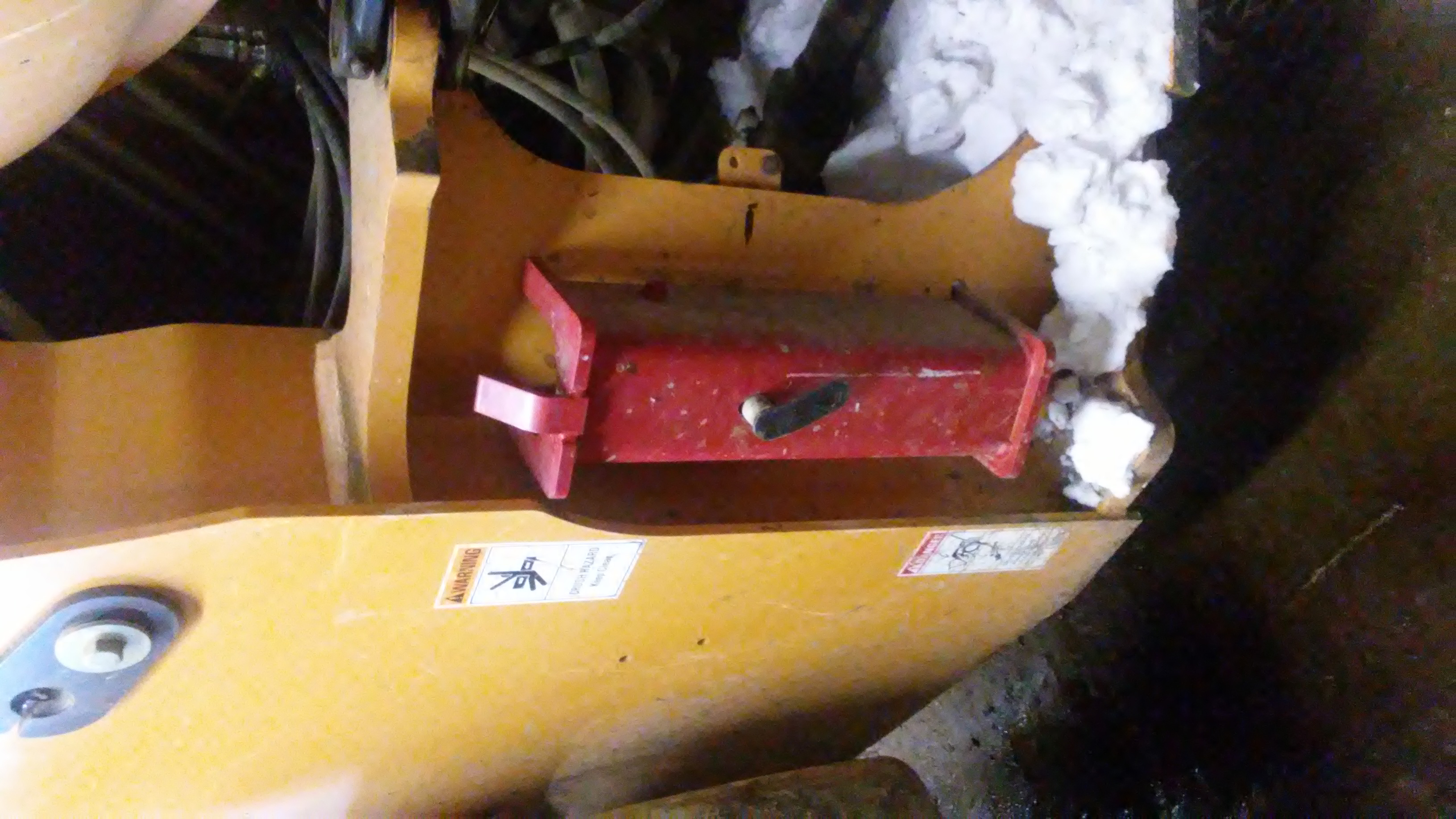

Post Options Post Options   Thanks (0) Thanks(0)   Quote truckerfarmer Quote  Post ReplyReply Direct Link To This Post Posted: 12 Jan 2019 at 9:48pm
Here's a picture of a cylinder support that is on one of our loaders at work. The black part is the bolt that holds it in place. Kinda hard to see, but if you can see the but welded on the top left, that is what holds it in place when in use.
Hmmm, for some reason pic is turned. Left is top.
Edited by truckerfarmer - 12 Jan 2019 at 9:50pm
