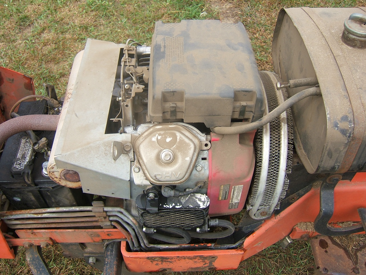

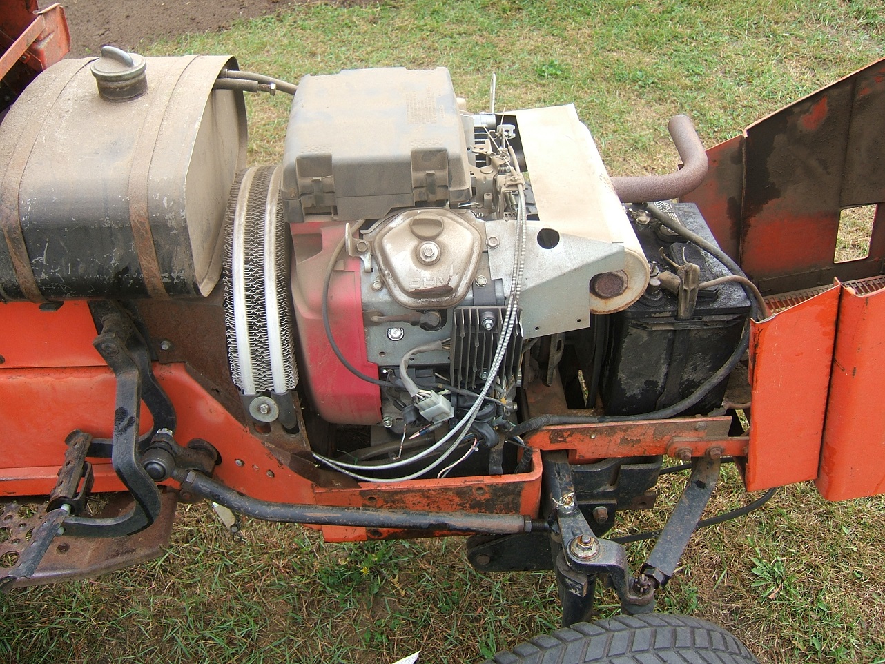

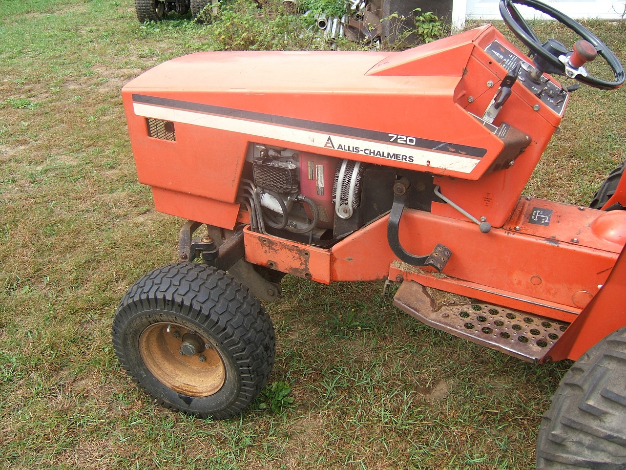

Fasstman, thanks for info. I was hoping someone would have pics of one being installed. Does anybody have a Briggs in one? Thanks Tracy

Post Options Post Options   Thanks (0) Thanks(0)   Quote fasstman Quote  Post ReplyReply Direct Link To This Post Posted: 06 Apr 2016 at 9:41pm

you can look at Dennis' post in this section to see the install of the Briggs
http://allischalmers.com/forum/forum_posts.asp?TID=115794&KW=DENNIS&PID=940342&title=finally-720-engine-swapmore-pictures-12-12-15#940342
