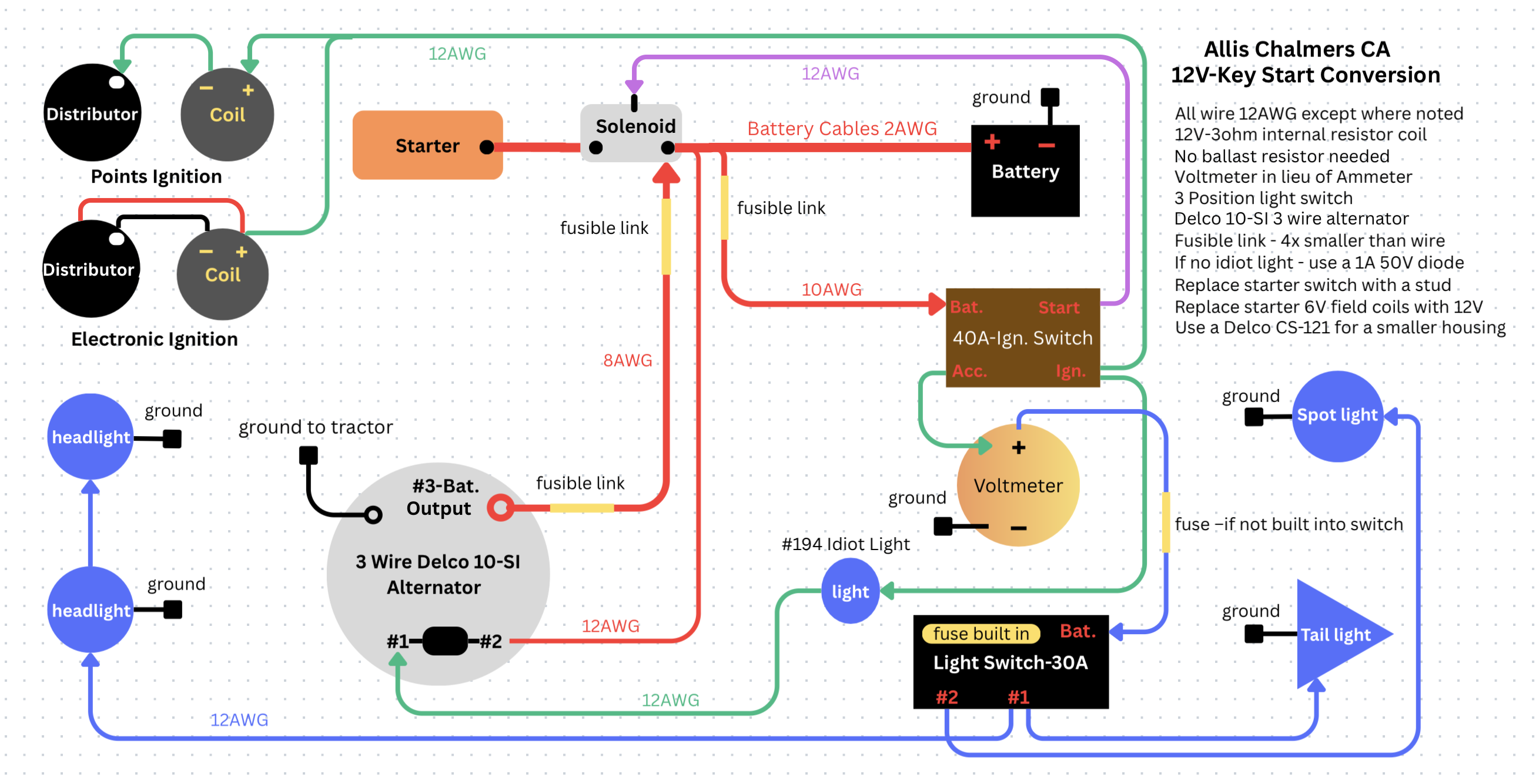

Here's my plan for wiring the CA

Any thoughts or advice...

I would just get a wiring harness from "The Brillman Co." Www.brillman.com Just tell them when ordering what alternator you wish to use and it will be plug and play. There's no need to make it any more complex than it needs to be.
Points: 90510
Post Options Post Options   Thanks (0) Thanks(0)   Quote steve(ill) Quote  Post ReplyReply Direct Link To This Post Posted: 14 Mar 2026 at 7:23pm
print looks good.. I think you got it....... I did the same thing 20 years ago... Made up 5 harnesses for "B" tractors...but i have toggle switch to turn ON.. then push button to START.... used them all.. Thumbs Up
Companies charge $160. just for the WIRES... then you need the switches and fuses if any.  Cost is minimal if you got the understanding of electricity..

Anyone who will put that much effort into a schematic will have no problem building a first-class harness. Big smile
I usually roll my own, but had Grandson do the wiring on the CA last year just for the education. Materials are getting quite spendy nowadays.

I wire all my tractors similar to this, 5 ACs, 4 Fords, 2 Farmalls, no factory harnesses. Troubleshooting should be easy, if they ever fail me....every one is 12 volt negative ground.

well, since you asked....
1) remove one of the fusible links in the alt-bat feed
2) install a +-40 amp ammeter
3) replace 10SI with the smaller CS-130 series or a Denso unit
4) install a 4 place fuse block instead of the  'power ' fusible link
5) one color per function
6) crimp,solder, heat shrink all end connectors
Edited by jaybmiller - 22 hours 47 minutes ago at 7:03am
Good points to consider.Smile
I much prefer a voltmeter rather than an ammeter, but I am too much of a cheapskate to remove a functional ammeter Tongue
I am not a fan of fusible links.
The 10SI alternator is indeed a tight fit on a Model CA as there is not much room for adjustment next to the steering arm, but it can be made to work so long as the adjustable pulley on the water pump isn't rusted tight.

voltmeter can lie, only shows the potential or possible energy
 whereas
an ammeter ACTUALLY shows electrons moving in and out of the battery.
'they' went from ammeters to voltmeters as a cheap cheat.. as they're easier to intall( cheap and universal).
