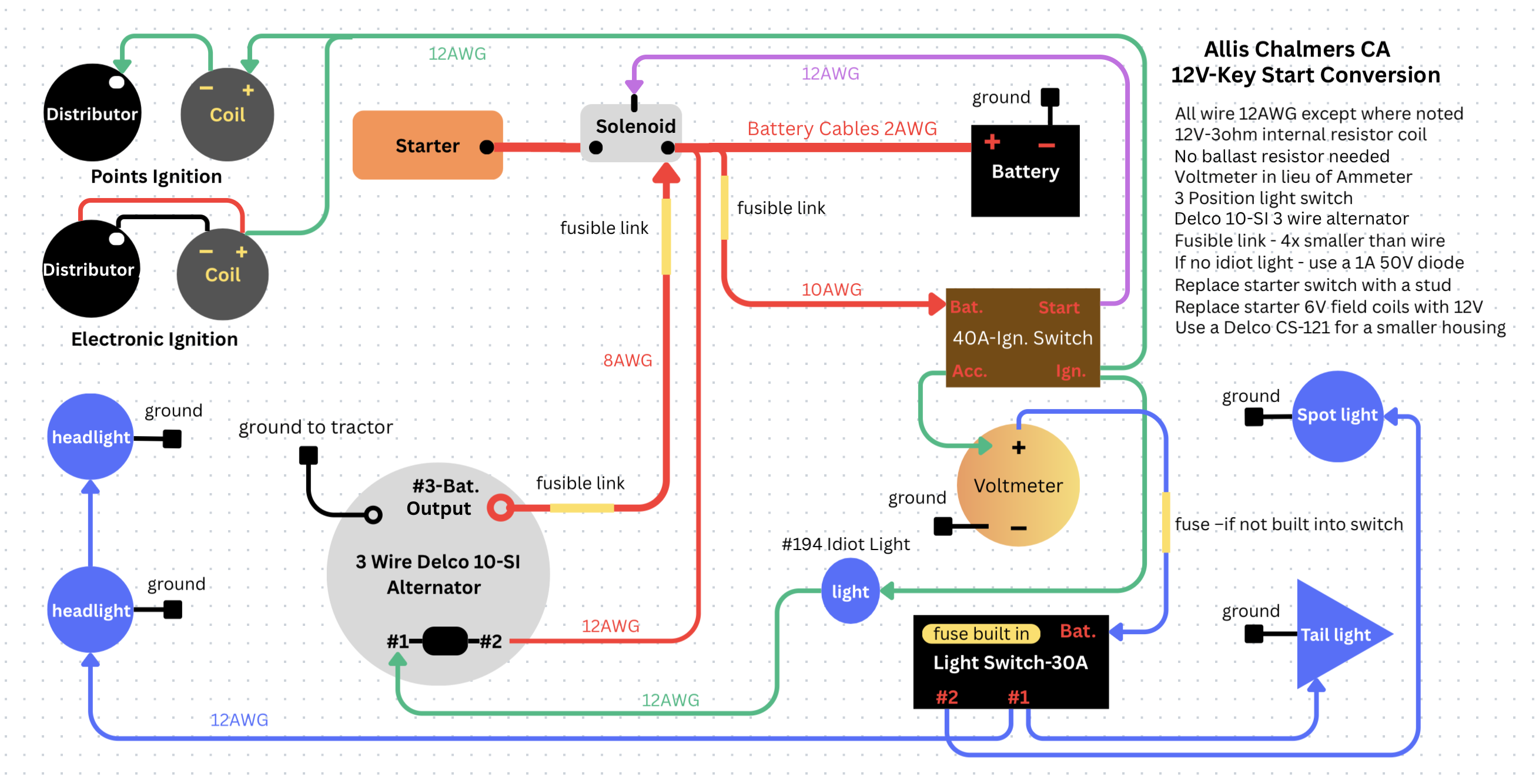

Here's my plan for wiring the CA

Any thoughts or advice...

Post Options Post Options   Thanks (0) Thanks(0)   Quote PaulB Quote  Post ReplyReply Direct Link To This Post Posted: 5 hours 4 minutes ago at 4:58pm
I would just get a wiring harness from "The Brillman Co." Www.brillman.com Just tell them when ordering what alternator you wish to use and it will be plug and play. There's no need to make it any more complex than it needs to be.

Post Options Post Options   Thanks (0) Thanks(0)   Quote steve(ill) Quote  Post ReplyReply Direct Link To This Post Posted: 2 hours 39 minutes ago at 7:23pm
print looks good.. I think you got it....... I did the same thing 20 years ago... Made up 5 harnesses for "B" tractors...but i have toggle switch to turn ON.. then push button to START.... used them all.. Thumbs Up
Companies charge $160. just for the WIRES... then you need the switches and fuses if any.  Cost is minimal if you got the understanding of electricity..

Post Options Post Options   Thanks (0) Thanks(0)   Quote Les Kerf Quote  Post ReplyReply Direct Link To This Post Posted: 1 hour 37 minutes ago at 8:25pm
Anyone who will put that much effort into a schematic will have no problem building a first-class harness. Big smile
I usually roll my own, but had Grandson do the wiring on the CA last year just for the education. Materials are getting quite spendy nowadays.
