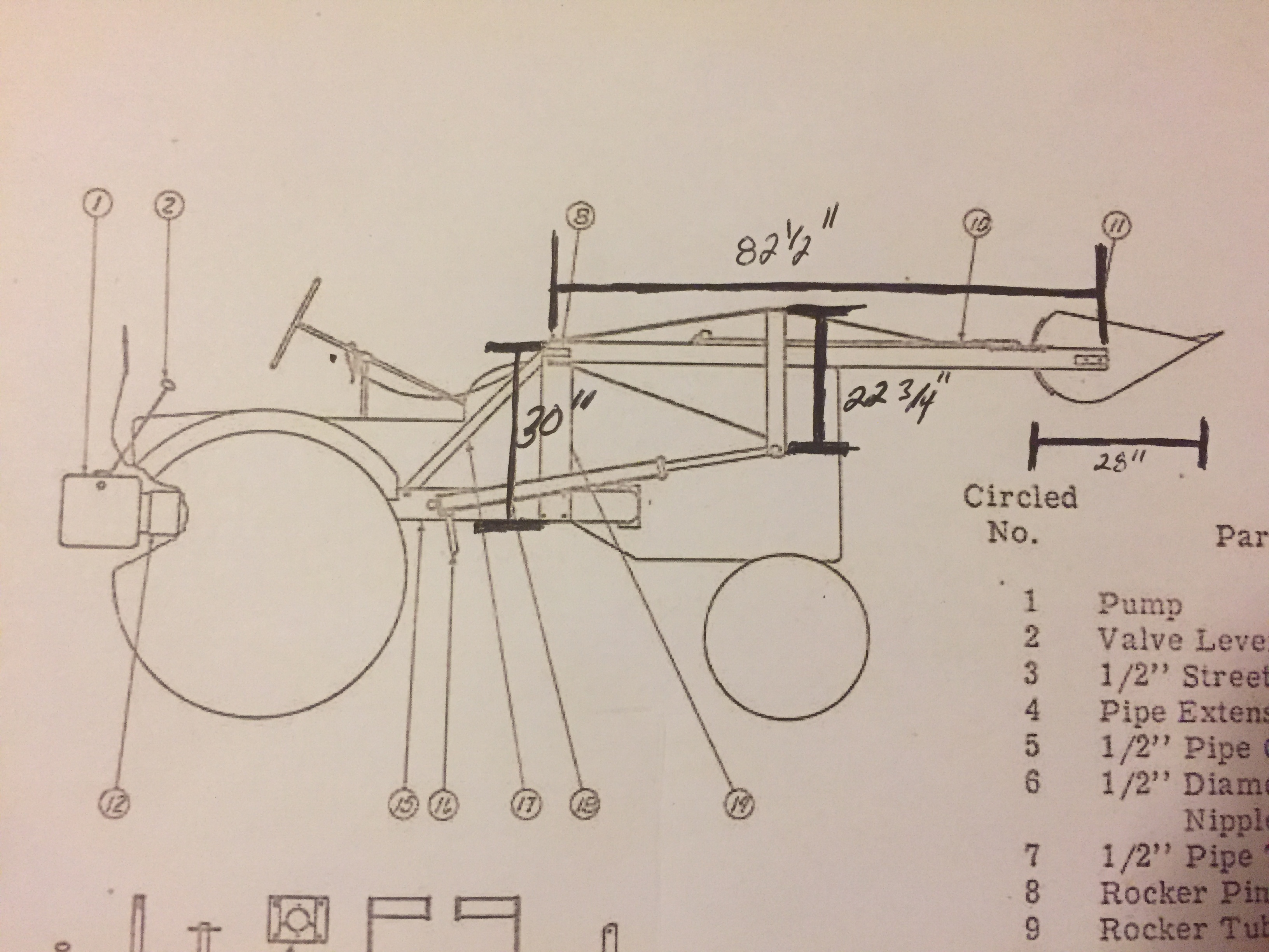

Would anyone with a Henderson Loader on their B be able to post the major dimensions for it?  Length of arms, width of frame and length of the support brackets on the tractor?  Looking for the dimensions of the one with the rectangle tubing rather than the round tubing.
Thanks!
Brad.

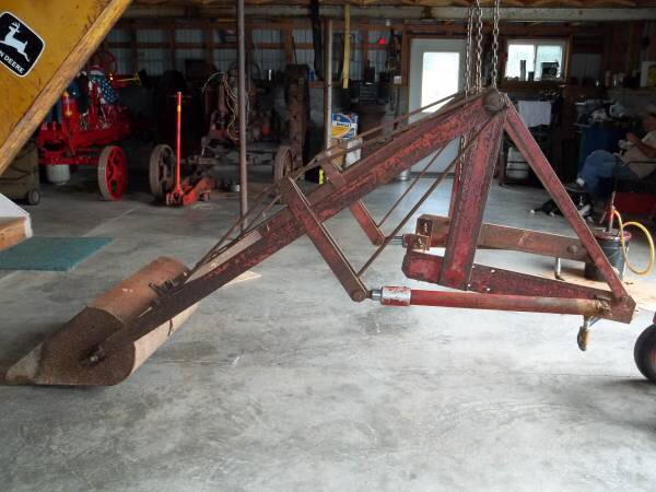

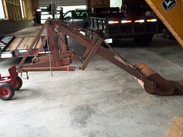

Is this the loader you are talking about? I can try to get some measurements when I get home from work tomorrow. I'm in the process of restoring a 39 B and this loader.

Post Options Post Options   Thanks (0) Thanks(0)   Quote meteorbrews Quote  Post ReplyReply Direct Link To This Post Posted: 02 Jan 2017 at 8:17pm
Yep, that's the one! That would be great, thanks!

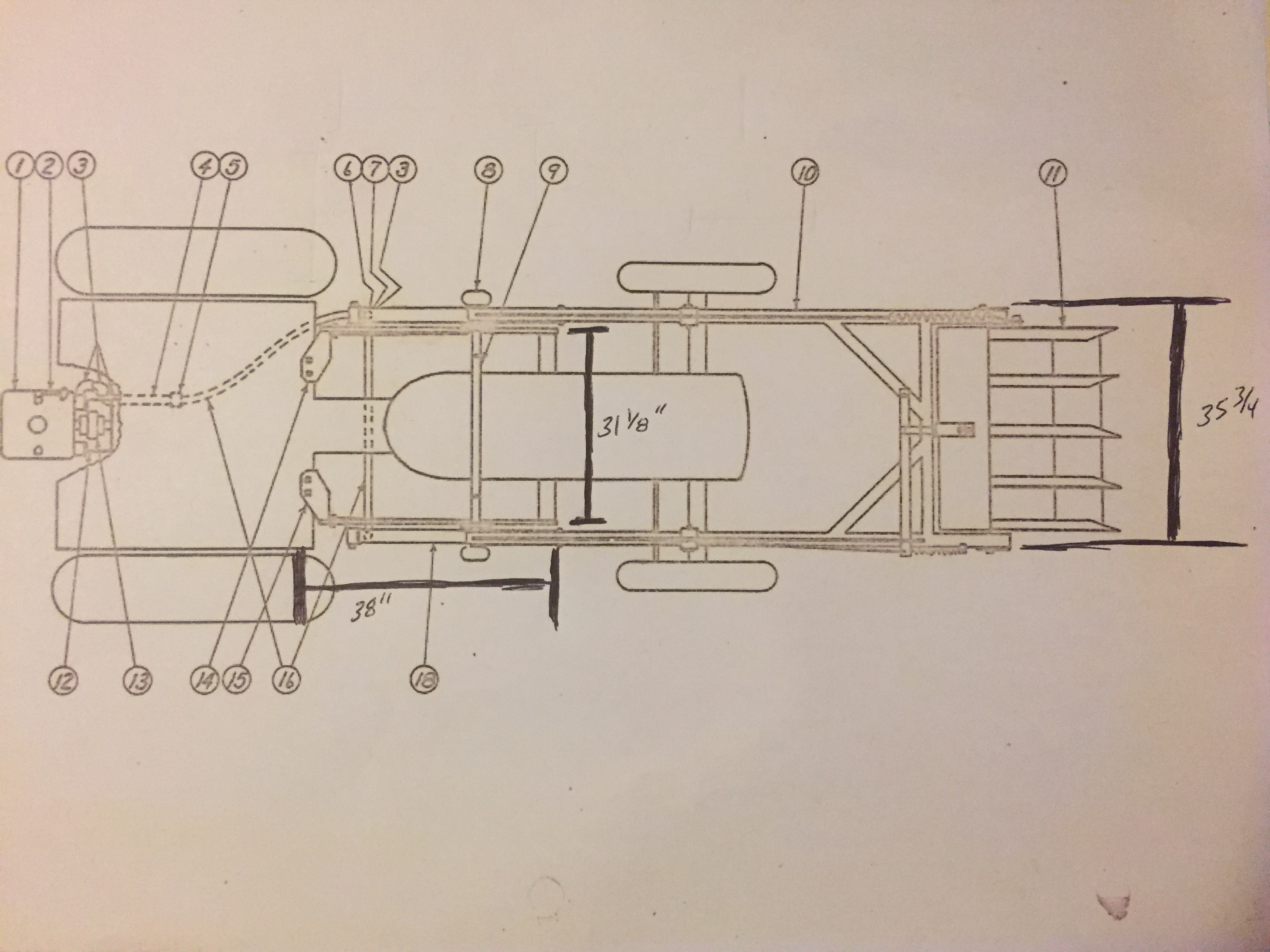

Post Options Post Options   Thanks (0) Thanks(0)   Quote Airing39B Quote  Post ReplyReply Direct Link To This Post Posted: 03 Jan 2017 at 4:37pm
I hope this helps. Let me know if you need anything else.

Post Options Post Options   Thanks (0) Thanks(0)   Quote meteorbrews Quote  Post ReplyReply Direct Link To This Post Posted: 03 Jan 2017 at 7:00pm
Thats perfect, thanks very much for that!
