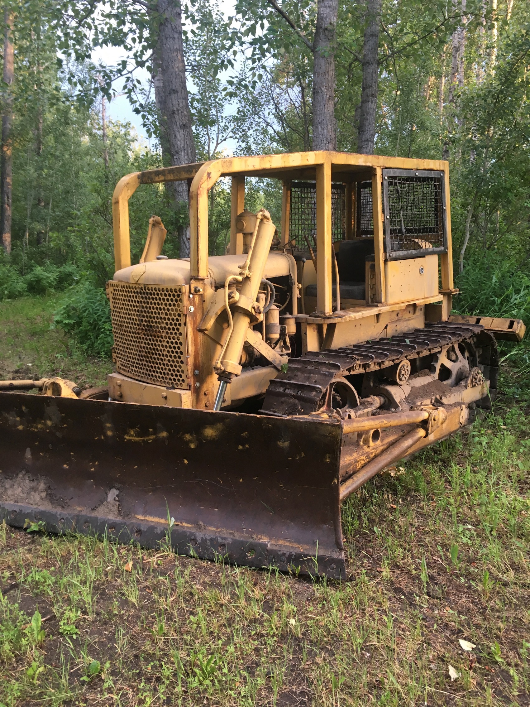

Hey folks im looking for little insight on a dozer i just picked up. its "1965 A-C HD5" although that doesn't sound right to me. it has a dozer blade, Ripper and a 2-71 engine., currently has no charging happening, i believe it has been refurbished and is swapped to 12v wiring. any help on what year, charging info, etc is greatly appreciated

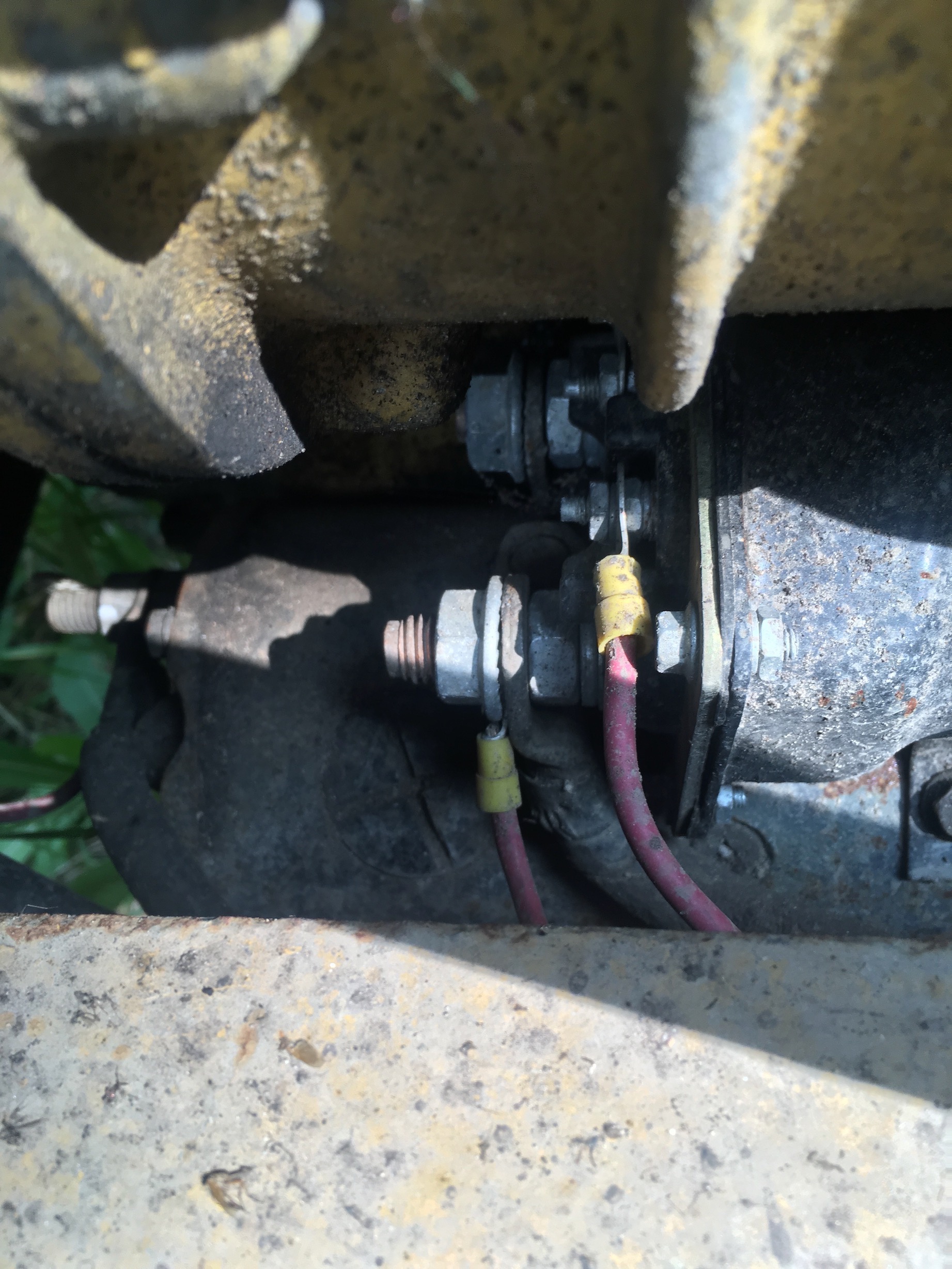

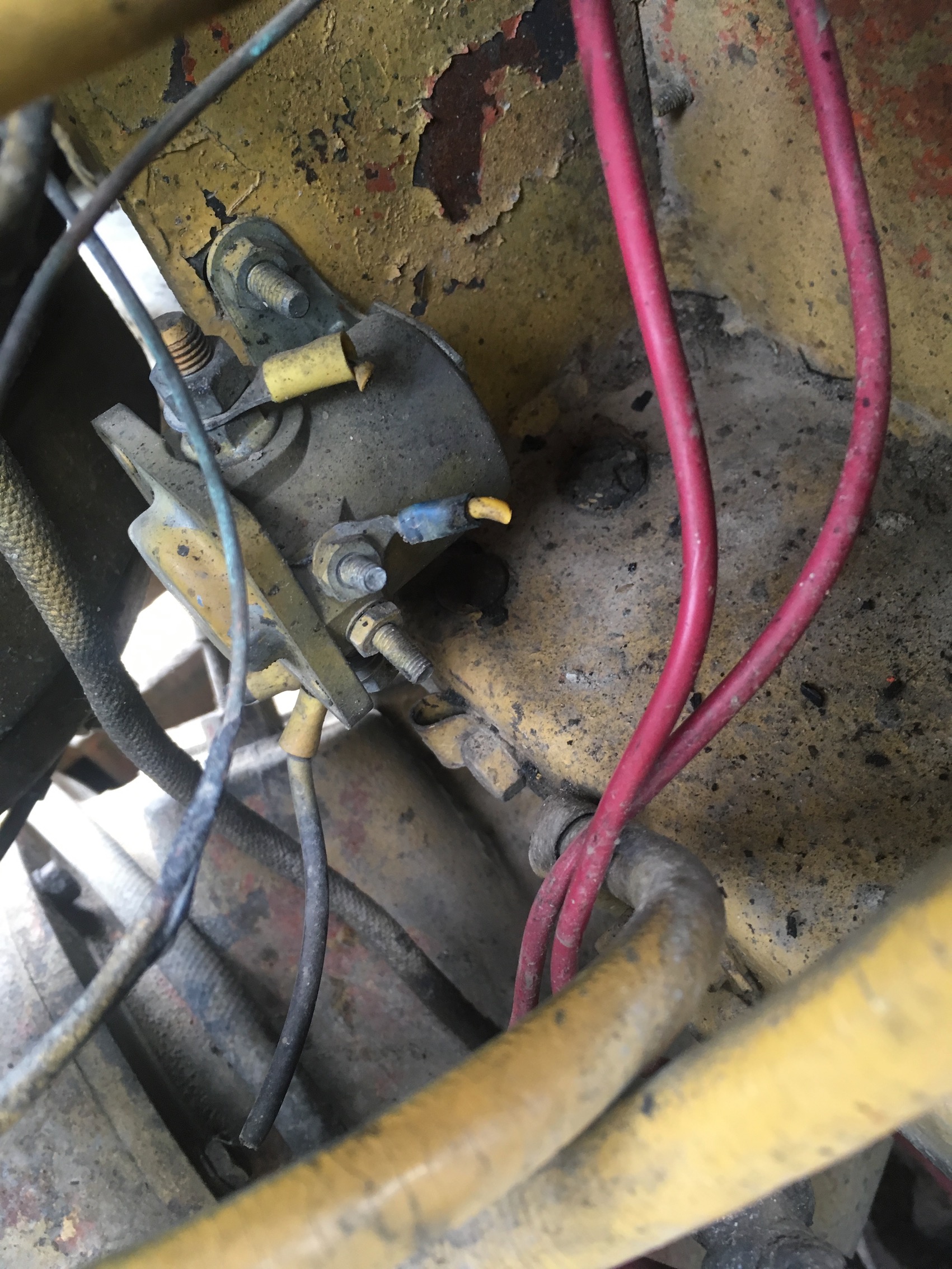

Looks like starter was changed to M42 late starter as they did not use a solonoid but a rod to a contact switch on starter

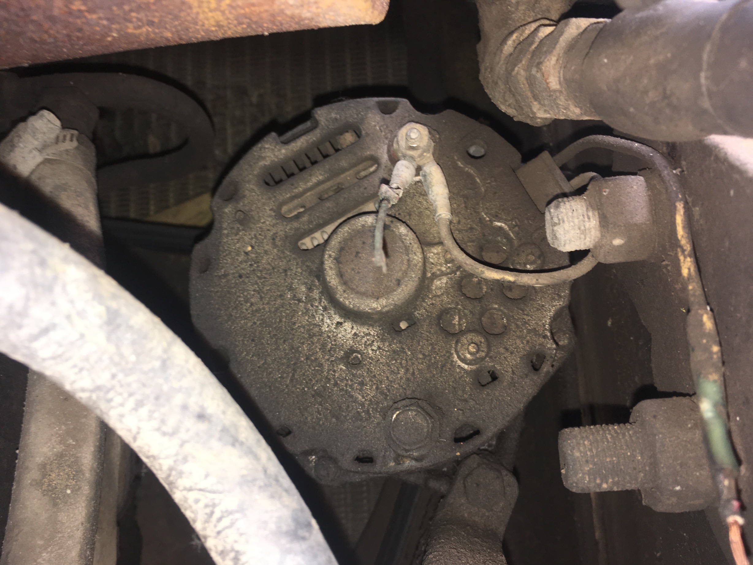

 Wiring diagram - depending on how unit is set up - using a 10SI alternator (1 wire) a hot lead would run from alternator to amp gauge then down to battery side of solonoid #10 wire - from that terminal to key switch or starter button a #16 wire would complete circuit to one terminal of solonoid to energise it .
 On 10SI a loop wire #16 goes from output terminal on back up to #1 on regulator block in alternator (this wire is sensing wire for regulator) this controls the charge by reading battery voltage,  from starter solonoid to starter is a heavy strap of copper - then from back of starter to frame a heavy ground wire is needed
 If the starter you have now is not a M42 and that solonoid shown control current to starter then foot operated rod must still be there to engage the starter drive .
 Think you have a mess that needs someone who is familiar with auto electric to help .
Coke-in-MN View Drop Down
Location: Afton MN
Points: 42262
Post Options Post Options   Thanks (1) Thanks(1)   Quote Coke-in-MN Quote  Post ReplyReply Direct Link To This Post Posted: 07 Jul 2018 at 7:12pm
Post a picture of the starter and can tell you more - as that solonoid hanging there is a completly foreign object to any AC or Delco system .

Nice setup
Did it come with ear plugs?
HD3
Post Options Post Options   Thanks (0) Thanks(0)   Quote shameless dude Quote  Post ReplyReply Direct Link To This Post Posted: 12 Jul 2018 at 1:24am
that's a nice looking unit! on my HD5, it would start without starting fluid down to about 10 degrees. I just had 1 12V battery on mine.

sorry for the delay... been super busy with house renos and all the fun stuff.
back to the stuff i think is fun, pushing trees over Big smile
here are some pictures of the starter and alternator

If the starter works fine by just pushing the button you won't need to do any more to it. At one time that solenoid was likely put in to give good current to the solenoid on the starter itself. I've had trucks with old Detroit power set up that way. It's just important that you have a heavy duty (push button) switch so there is no shortage of current going to the solenoid mounted on the starter. If you have insufficient amps hitting the solenoid, the starter motor is starved and will turn over slower than it should and may shorten starter life span. The red wires attached in the picture seem to be a good gauge for the job. If your alternator itself is good there is an easy way to wire it up for charging even if you don't have an ignition key/switch on your machine. Just let us know the current state of affairs... maybe you have it wired by now? I can tell you how to get it charging the Canadian way LOL. Another thing I would highly recommend you do is to put a real good quality battery disconnect switch on your machine. If anything goes wrong with wiring on an old machine and wires start shorting out and smoking... even starting a fire - you just flip the disconnect switch and save further damage. This may not apply to you but if kids get on the machine when parked and start playing around with switches and buttons you can prevent a lot of trouble by having no current in the system.

I have wired this type of alternator on tractors. the stud goes to the plug on the side of the alternator like it does but the cut wire goes to the battery. the other wire from the plug I wire to a light on the dash. you need a 2 wire light, not a self grounding light. the other side of the light gets wired to the ignition side of the key switch which should not have anything wired to it since it is a diesel, assuming you do not just have a momentary switch to engage the starter. when you turn the key on the light comes on and once you start the engine the light goes out once it is charging. sometimes you need to accelerate the engine to get the charging started. easy way to show it is charging. I then use a volt meter instead of an ammeter. to me I want to see it is putting out 13 volts or higher rather than how much it is charging. after a few minutes the ammeter will read about zero as it is not using any power. with a volt meter you can see charge is happening. on the starter, there are 2 smaller terminals. one goes to ground and the other goes to the start pole on the key switch. I would also put a fuse on the hot side of the key switch just in case. I hope that makes sense.

Eric B the starter works great with the push button the way it is set up right now. fires right up in a few seconds no problem. as for the alternator, im listening on how you would recommend to wire it up. it looks like the original wires were actually pinched in between the fuel filter and housing and that is how they burnt. i haven't wired it yet but i have put in a good battery disconnect as you mentioned. exactly for those kinds of reasons, and then i know if it sits for a bit there was now parasitic draw on the battery.

nice looking dozer. do you have an amp meter. I just put delco alternators on my dozers. put a diode in the discharge line and hook it to the amp meter. other wire goes to your switch so It only has charging power with the switch turned on. coat around 50 bucks here and sure saves on batterys enjoy your machine. my h4 is a 66 nd the h5 are older. 55 might be right.

In the event that your HD 5 does not have an ignition switch of any kind that you have to turn on before starting and off when shutting down, this is how you can have your alternator start charging by just pushing the starter button. Take the two wires on the alternator (in the little plug on the picture, field and regulator) and twist them together with one additional wire that can reach the "S" contact (the small stud) on your starter solenoid. Into this line you MUST splice in a 6 AMP diode so 12V can only flow to the pigtail on the alternator but not be able to come back from the alternator to the solenoid or else the starter won't quit when you let go of the button. You MUST make sure you have the diode facing the right direction by testing flow direction on a battery using a 12V light bulb. The idea here is that while the engine is turning over and starting, enough current goes up to those two terminals to excite charging mode. Charging works until you shut the engine off and this way there is no draw on your system after. The battery terminal on the alternator can go to the ammeter if you have one, if not just connect it to the stud on the starter that has the fat battery cable coming to it. If you don't have a working ammeter and you want to know if the alternator is charging just put a screw driver to the back of the centre bearing cap on the alternator, if you have magnetism and the screw driver sticks it's working... if the screw driver doesn't stick it's not charging.
Your nearest auto parts store should have a 6 AMP diode but don't pay any outrageous price for one because they're cheap from the right places.

Alright, i got the wiring working so when it gets enough oil pressure to the switch for the lights it will turn on the alternator, so it doesn't always kick on right on starting, but it will once you idle up. works fine for what I'm doing as the little 2-71 runs idled up pretty good when running anyway.
