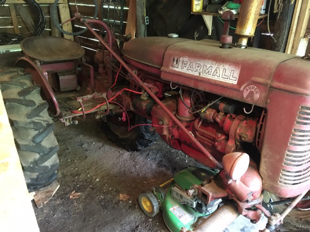

Have the chance to get a Farmall Super A.  I know this is the wrong website for red tractors.  Went and looked at it today.  Took carb apart and cleaned.  Took sediment bowl off and cleaned.  Drained tank.  Put in fresh gas.  Gas is flowing to carb. (looks like the same type as my D14m a Marvel Schreiber).  Has alternator on left side of tractor connected to fan (one like what you would see in a truck or a car).  On the right side by the distributor is a black solenoid (I think that is what it is called) that is labeled 6 volt connected to two wires. So I am assuming this is a 6 volt setup.  I put my 6 volt battery on (which has no problem starting my WD, plus I charged the battery over night).  It would barely even turn the tractor over.  Took a 12 volt battery out of the lawn mower that was sitting there.  It turned the tractor over pretty good but it did not even attempt to start.  Tried to take spark plugs out in order to dump some gas in each cylinder.  Did not have the right size plug wrench so I couldn't get them out for now.  (an hour away from home, and I never have enough or the right tools with me).
On the operator's planel of the tractor is a switch (push in to stop, pull out to run). It didn't move very well so I took the two wires off of the back cleaned them and connected the wires directly together (bypassing the switch).
There is also a round knob that turns from the Letters C, D, and B.  I have know clue what this is,  I am guessing C for charge,  B for battery  D?   It has wires running to the alternator and maybe meter, I cant remember). Any help on this?
There are a lot of wires with missing insulation.  Tractor is negative ground (I am pretty sure)  I can get tractor to turn over, but not start with negative ground.  When I switched to positive ground, I got all kinds of sparks at the battery terminals so I switched back to negative ground.   If I have negative battery post to ground and positive battery post directly to starter, what other essential wire(s) do I need? (another words, I am trying to bypass the entire existing wiring and get tractor to at least fire, hopefully even run).
The tractor has sat in a shed since last used. It was running in good shape when placed in there 15 years or so years ago.  When turning over with battery, the hydraulics were actually moving.  I lowered them, Pushed in the clutch and am holding it in with a block of wood figuring that if the clutch is in, there is less to turn, making it easier start.
Again, sorry for posting a "RED" question on an "ORANGE" site.   You guys have been very helpful in getting MY WD and my D14 going. Any help on this would be greatly appreciated.

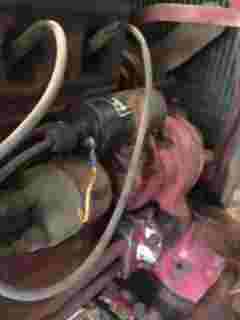

You want to make sure the wire going from the distributor to the coil is going to the negative post of the coil if the tractor is negative ground.
Other thing is make sure the points are good and set right. The gap when opened is 20 thousands.

I believe the wire from the "D" terminal goes to the positive terminal on the coil; there should be a wire from the neg terminal on the coil to the distributor.
Have you checked for 6 volt power at the coil terminals? If no power there, it won't fire. I'd also clean and gap the points as noted above. Have you pulled a spark plug and grounded it while turning the engine over to see if you are getting a spark?
If your battery is struggling to turn the engine over, there may not be enough juice left to provide a spark.....I'd want to know why the engine isn't turning over better before going too much further!

With an alternator the tractor is 12v, neg. ground.
Take the distributor cap off,
Remove the rotor and shield, (if installed) to expose the points.
Pull the coil wire out of the distributor cap but leave the other end firmly in the coil,
Pull out the ignition switch, (or jumper the wires together again),
Hold the end of the coil wir approximately 1/4" away from any bare metal tractor part.
With your other hand seperate the points and watch for spark from the coil wire to the metal. (should spark every time you seperate the points)
If you have spark first check the contacts on the under side of the distributor cap and rotor.
Next check would be plugs and plug wires.
If no spark, first try filing the points
If still no spark you will definately need a volt/ohm meter to check the system.

To check the coil, just put my volt meter on the two wires of the coil?

With wiring as you discribed and sitting that long I would disconect ALL existing wires and use temperary wire to the coil till you get it running. If you buy the tractor the first thing I would do after getting it home would be to replace all the wires.     As Sameful said priveous owner may have been in the process of 12 volt conversion.

Jump a wire from the positive side of the battery to the other terminal side of the coil on the left in your picture.
Next thing to do is to take off the disturber cap.
Turn the tractor over you should see the points should have spark.
The points will need to be cleaned if has been sitting that long in my opinion.

On your coil you should see the two small studs. One on each side of the plug wire. Run a positive wire from the battery to the positive stud on the coil. From the negative stud run a wire to the distributor. Make sure you make the connection at the battery so you can easily disconnect it in case things go bad.

So I should do the following to bypass existing wiring: use 12 volt battery with negative battery post to ground (bare metal on tractor)  positive battery post to 1 heavier gauge wire (6 or 4) to starter and 1 wire (12-10 gauge) to left side of coil above distributor while the right side of coil goes to side of distributor (as pictured above).
The above setup will give me everything I need to get a complete circuit to start the tractor?
I will also do the following:
1) I will check the points, make sure they close and open to 0.040.
2) I will check spark plug wires for spark.  7/8" socket
2) I will pull plugs, clean plugs (or replace), dump a little gas in each cylinder.
3) Maybe dump a little mystery oil in each cylinder if I think compression is a problem.
