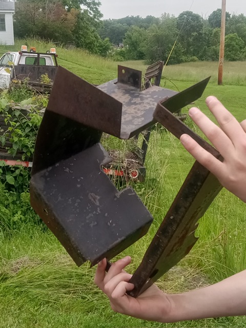

Post Options Post Options   Thanks (0) Thanks(0)   Quote Mikez Quote  Post ReplyReply Direct Link To This Post Posted: 16 Jun 2025 at 8:00am
Do you have a picture of heat shield. We have some kind of shield. Can’t remember if it was a 620 or 616
