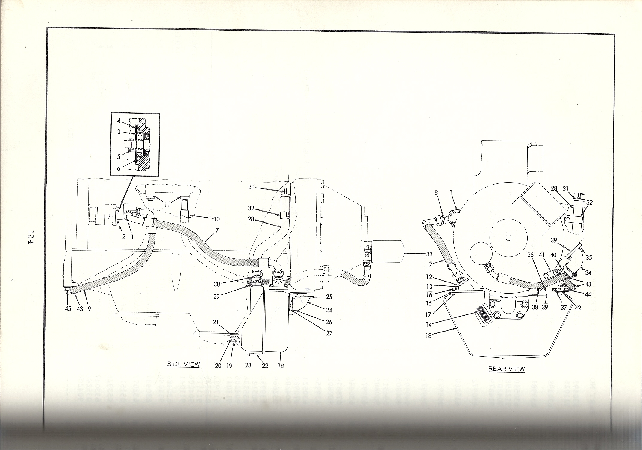

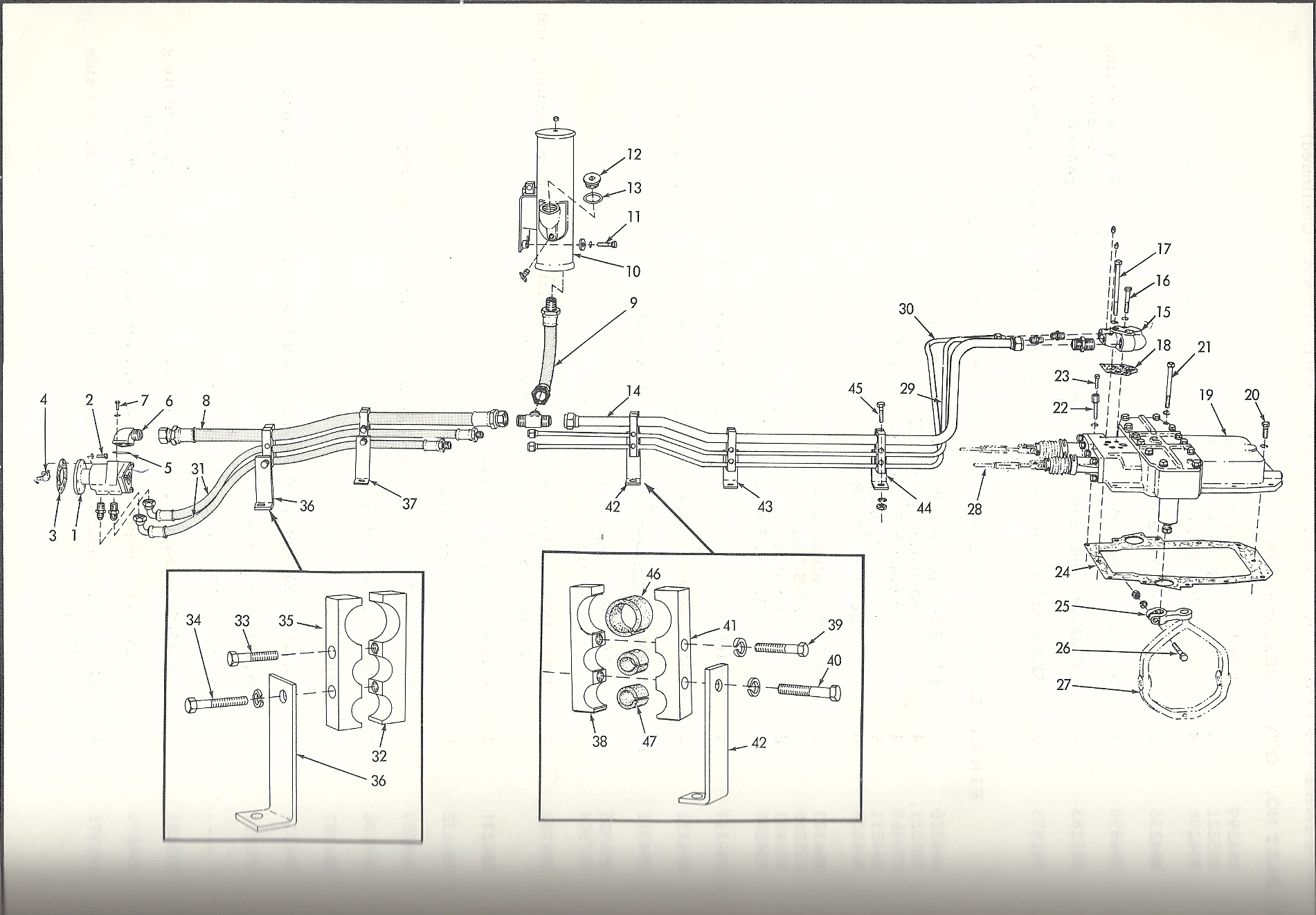

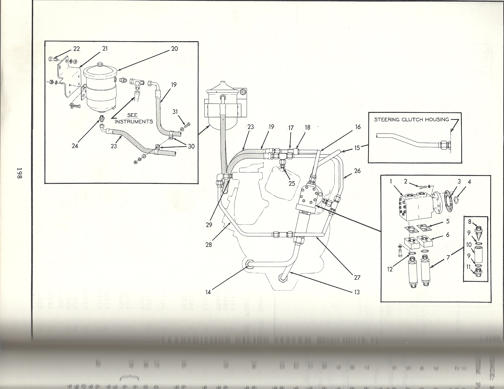

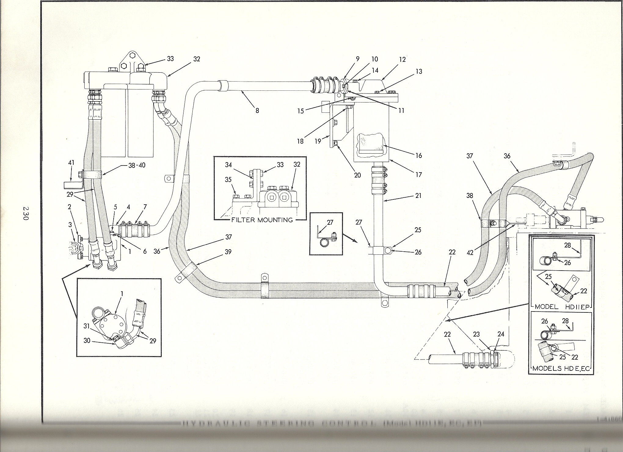

Models can vary, I have two ec models ,the later model machine has the  settup in the second picture and the other earlier machine has the settup in the last picture hope you can mach something up here with yours ,if you follow the oil lines should be able to work it out . steve

model b and e transmission lube pump from parts book shows two strainer filters at pump

Post Options Post Options   Thanks (0) Thanks(0)   Quote steve aust Quote  Post ReplyReply Direct Link To This Post Posted: 19 Oct 2010 at 6:16am
I think the last picture is what you were after ( when you said tandem pump thought you meant the one on the motor  that supplies oil to work the steering clutches .
I have only a parts book , i think there is only one dip stick and the pump takes oil from the botem of the trans in two places,

Post Options Post Options   Thanks (0) Thanks(0)   Quote steve aust Quote  Post ReplyReply Direct Link To This Post Posted: 19 Oct 2010 at 6:22am
also on the last picture lists item 7 as strainer assembly which can be pulled apart for cleaning.
