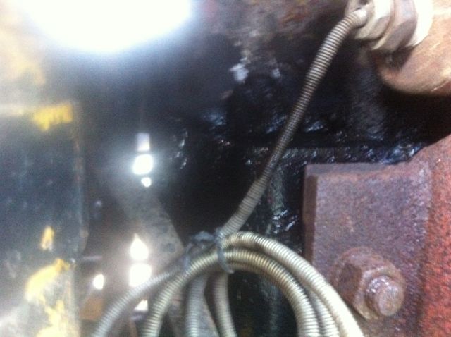

I do see a rubber gasket sticking out the left side of the block right behind the fuel filter. However, like I said before I'm no mechanic but there appears to be a plate of some sort with a couple bolts on it. Any ideas what that is?

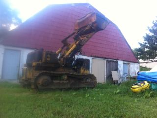

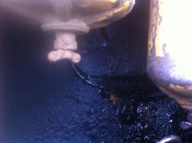

Well I don't think it's the head gasket. After closer inspection I found what appears to be an access panel popped lose. It's right behind the fuel filters so a bit of a pain to get to but better than the head gasket. Also, the white smoke wasn't coming from the exhaust pipe. It looks like my valve gasket has a leak and the oil was burning off. Here are some pics. Can anybody tell me what that access panel is for?uploads/14179/Access_Panel.jpg

First off, is your machine early or late? A late unit will have a Allis Buda engine 4 cylinder, early units had Detroit Diesel 3 cylinder engines.
Dozer View Drop Down
Joined: 16 Aug 2011
Location: SW New York
Points: 689
Post Options Post Options   Thanks (0) Thanks(0)   Quote Dozer Quote  Post ReplyReply Direct Link To This Post Posted: 19 Aug 2015 at 9:58am
HD7's have the 3 cylinder Detroit's
HD5's have the 2 cylinder Detroit's
Early HD6's have HD344 4 cylinder Buda made by AC
Late HD6's have Allis Chalmers 6000 motor (upgraded HD344)
HD7G's Have Allis Chalmers 7000 motor (turbocharged 6000 motor)
HD7GB's have a 6 cylinder version of the 7000 motor
Send a picture

Those are the valve lifter covers (2) To pop that gasket and move the dipstick you had crank case pressure. Refer to the 13 August post.
Identify the motor. If the injectors are under the rocker arm cover you have the 6000 motor. If the injectors are on the side of the cylinder head you have an HD344. There is also a plate below the fuel filter in your first picture that will identify the motor. There is also one on the dash. The HD344 has a flat top piston. The 6000 motors have deep dish and shallow dished pistons.
Talk with HD6Tom about purchasing a rod and piston assembly if you have the same motor type.
If the machine is still mobile drive it up on 2 or 3 2x12's to gain working space underneath. cut a piece of plywood to fit between the track if you don't have a smooth working surface underneath the machine. Block the bucket about 2 feet off the ground so you can get under the machine. This is SOP. Before disabling the machine position it preparing for the worst case repair.
Worst case you broke the pushrod on an exhaust valve and broke a piston.

Your HD6 have 2 cover on side block for checking the brackets valve lifters
