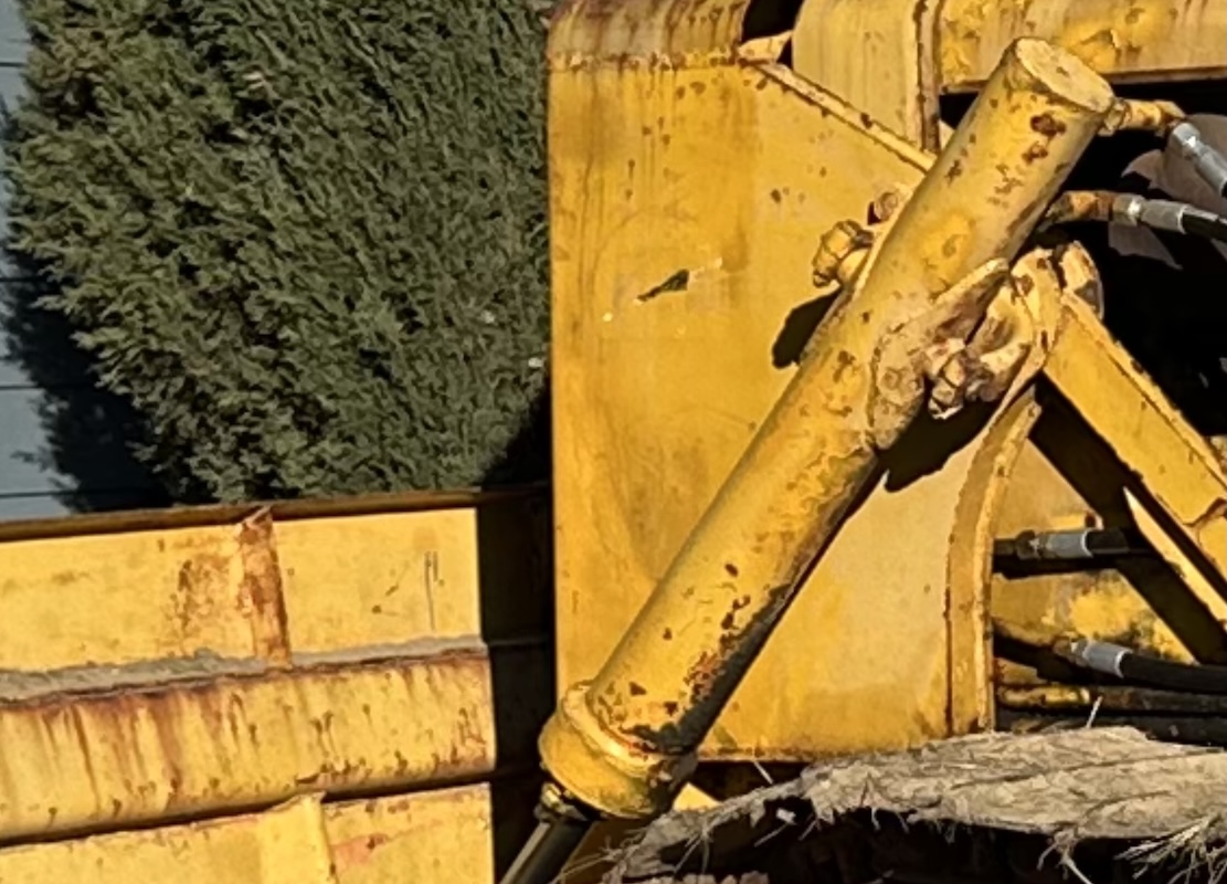

Hi all,
It's time to rebuild our HD9B GarWood blade's 2 hydraulic cylinders. Both are leaking internally so the front blade slowly drops on its own. One can actually hear the fluid moving past the internal hydraulic cylinder seals when the blade falls!
I'm clear on the process of replacing the cylinder seals, but I've not done it before. Are seal kits still available for these very old cylinders? Anyone know of a business in California that I may simply take the 2 cylinders to for a reasonable rebuild?
Thanks in advance for your feedback.
Jim

Hard to tell but looks like those would be old style and have V ring packing and cylinder piston V rings also .
 Not the latest type with square ring piston O ring type .
A hyd shop should have or be able to get what you need , the hard part is paying $150a hour or so for them to rebuild them
