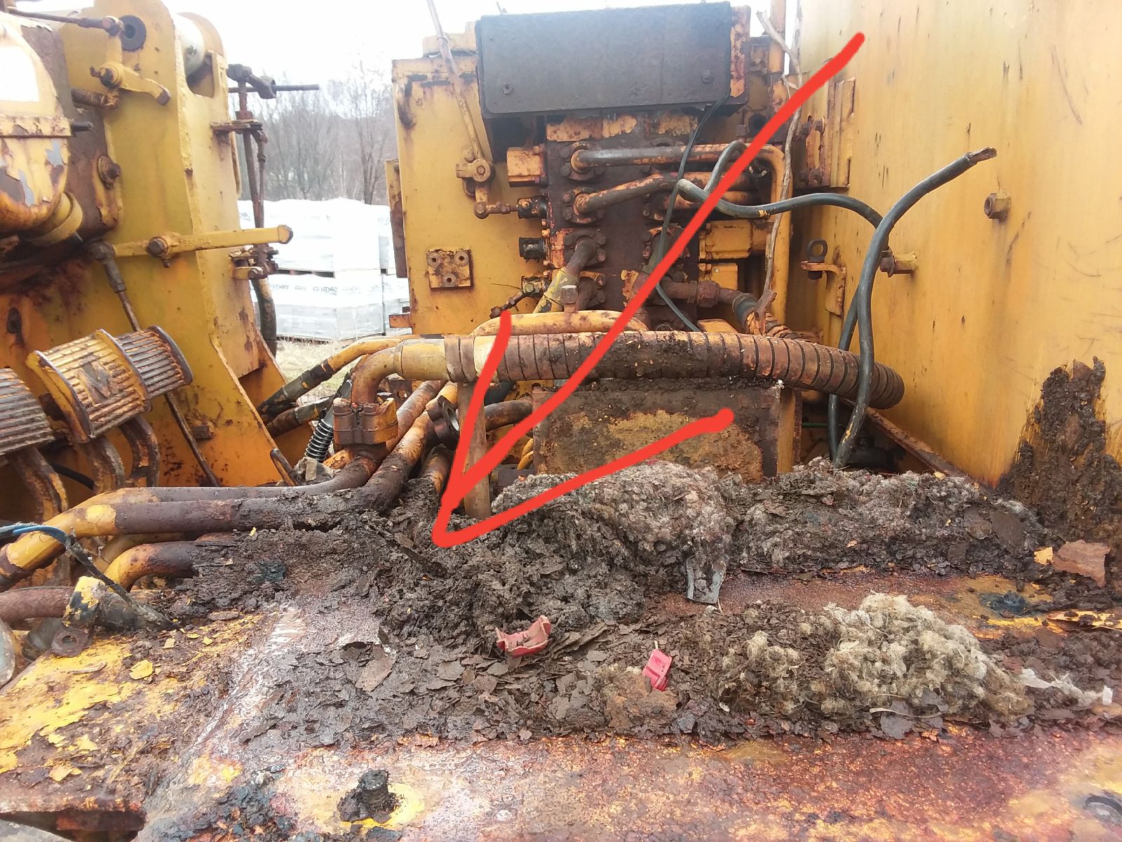

Anybody that has one of these better keep those hydraulic tubes clean where they run into the battery compartment area or saddle tank the other sides of the lines that are exposed in the open are clean as a whistle I bought some tubing pre bent on an angle and my Pro welder is splicing in new corners as we speak

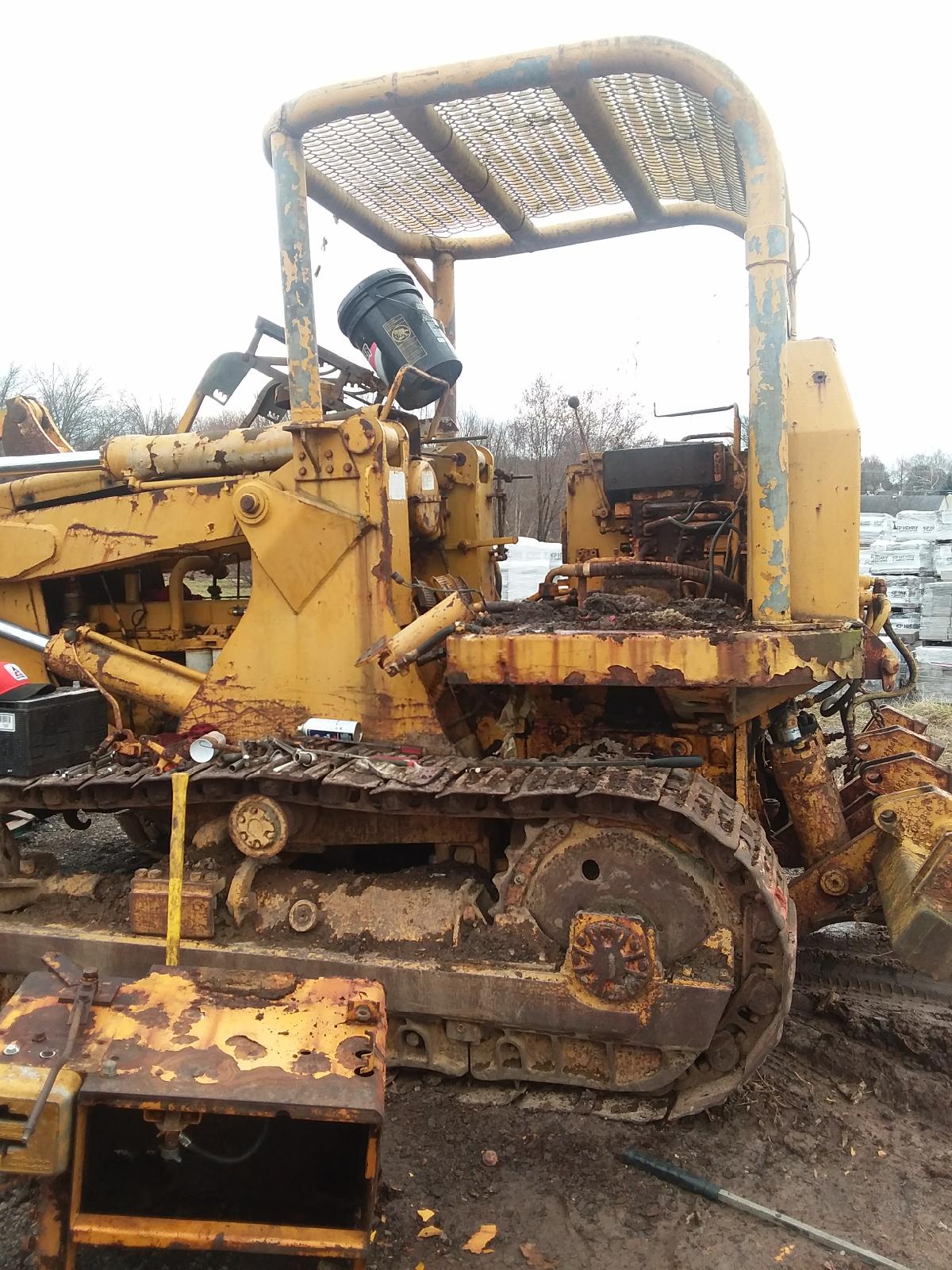

All the rust was air hammered and knocked off and being painted.
The shifter Tower is being rebuilt with some new pins and bushings they had a pretty high quality set up from the factory even some needle roller bearings and seals on shafts and Bell cranks very high tech, I've replaced with new oil impregnated bronze bushings and adding grease zerks

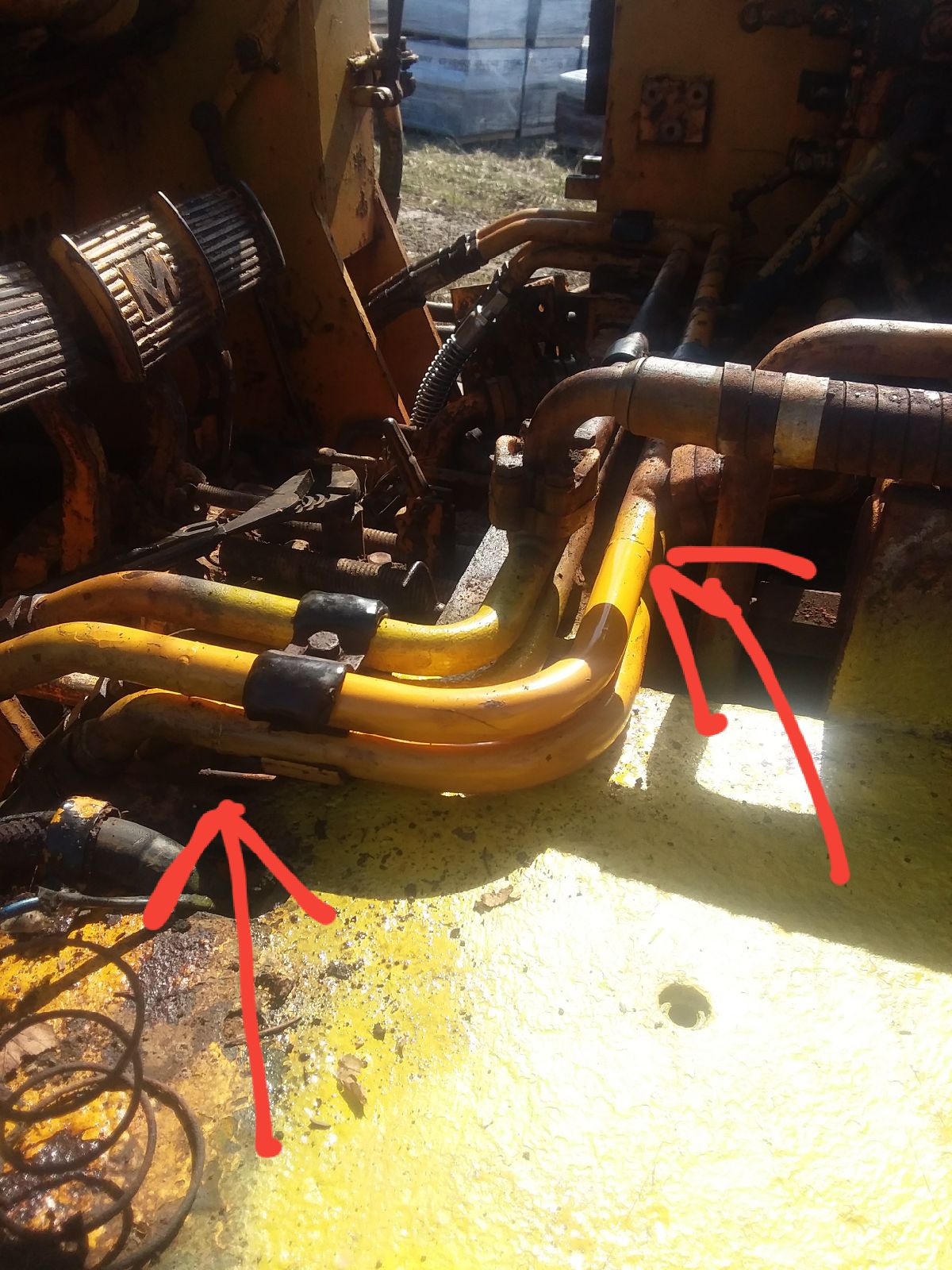

Update I had the lines repaired and I installed them. You can see the welds where new elbows were installed.

Does anybody have ideas how to keep mice out of those perfect areas for nesting?.. I was thinking about filling in the areas with that insulation in a can that expands or slopping lots of nasty grease in there

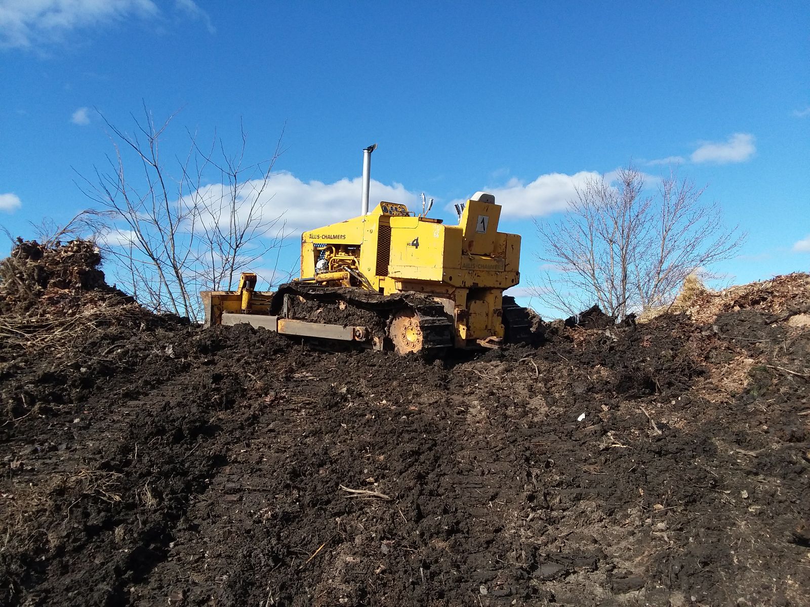

And then I celebrated by taking the hd4 for a spin 😥😂

Well placed often replaced moth balls

Segments look pretty solid, rails look pretty well used up as well the shoes on them. Be wary when turning if much slack in them as the old snaky rails like to roll off.

I saw some spray on foam at the local hardware store.  It had Jalipeno flavor it it which is supposed to repel mice and insects, unless, of course they are from Mexico...

DMilller yes the rails are lean and the pads are too but the sprockets are new as well as the pins and bushings

And I didn't know till now they did flavored expanding insulation in a can to deter chewing pests good information

Nice find. Birds nested in my cat 943 one time. snakes were on it after the bird eggs. Used it on a job and they were sticking their head out all over trying to get out. some got out through hole in belly pan while running it.

I like the HD4  thats a great photo
