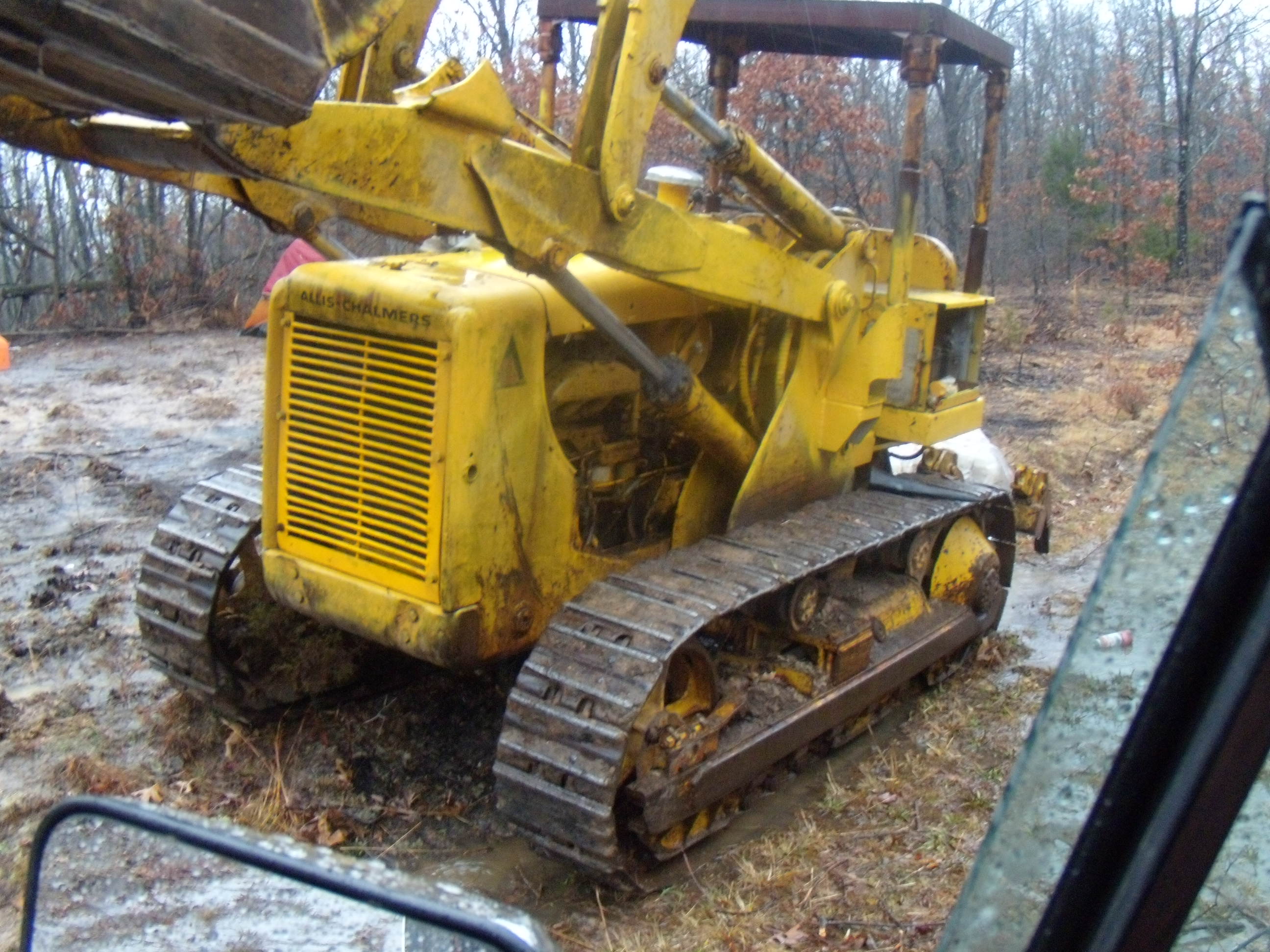

  Well, after laying in a stream of freezing water in a rainstorm, I changed my trans filter and checked the trans pump scavenge screen. Both looked clean and newer. I think it would take a pound of wood chips to clog that screen, it's so big! My trans readings on lube and main are just above the yellow, that is 120  on main and 5 lb on lube pressure. Now, if I engage the push start pump, pressures climb some into the greens, especially at a low idle. I didn't remove the main strainer as the weather made it impossible, it's a sob to reach. With the hose to pump disconnected, fluid pours out of the fitting. If p start pump uses same screen, then I wouldn't expect a pressure/flow rise by engaging it if the screen is clogged. Anyway, I'm changing to straight ATF versus the tractor hydraulic fluid: that could make some difference. What kind of dash gauge readings do you other 7G owners see? This is mid forties for temp, oil warm not hot.  BTW, main pressure doesn't drop when put in any gear. Lube pressure will drop when in gear. Tractor pulls hard and runs great. I appreciate your advice as always. Next weekend I'll have better weather and can do some pinpoint pressure checks.
