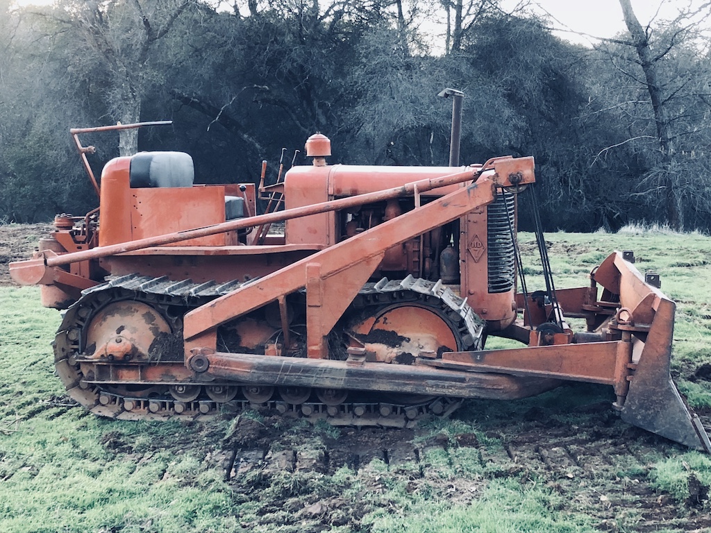

I'm trying to find the year of manufacture for my HD7 with the SN 17129. It has a pulley-driven dozer blade. Any help would be much appreciated.
Edited by Royal - 20 Jan 2018 at 9:42pm

Should be 1949

Nice looking unit! Looks to be in very good condition.

Good looking old girl.

Overall great condition but I'm having some steering issues now and not sure where to begin to look for parts. I suspect it's something to do with the clutch. When I drive it pulls to the right.
