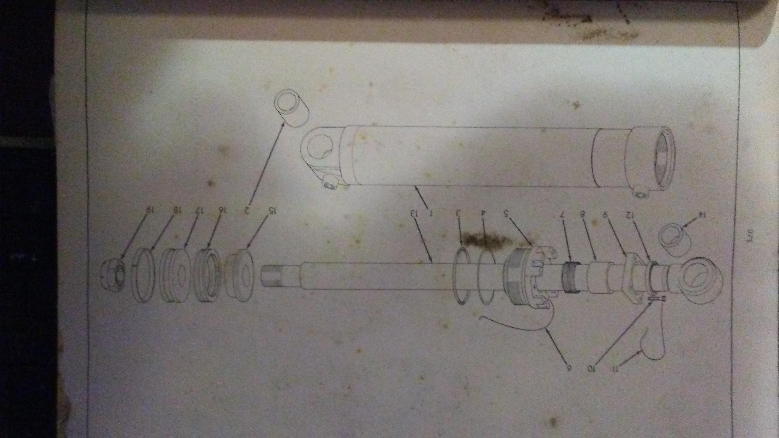

Any body have a diagram of the lift cylinders

Post Options Post Options   Thanks (0) Thanks(0)   Quote doctorcorey Quote  Post ReplyReply Direct Link To This Post Posted: 06 Aug 2017 at 8:25am
You're looking for a hydraulic schematic or a diagram of the actual cylinder?
Lewischaz1092 View Drop Down
Joined: 16 Jul 2017
Points: 20
Post Options Post Options   Thanks (0) Thanks(0)   Quote Lewischaz1092 Quote  Post ReplyReply Direct Link To This Post Posted: 06 Aug 2017 at 8:39am
Diagram of the cylinder itself got a seal leaking
doctorcorey View Drop Down
Joined: 17 Jul 2011
Location: S. KC Missouri
Points: 589
Post Options Post Options   Thanks (0) Thanks(0)   Quote doctorcorey Quote  Post ReplyReply Direct Link To This Post Posted: 06 Aug 2017 at 12:26pm
Dozer View Drop Down
Joined: 16 Aug 2011
Location: SW New York
Points: 689
Post Options Post Options   Thanks (0) Thanks(0)   Quote Dozer Quote  Post ReplyReply Direct Link To This Post Posted: 06 Aug 2017 at 12:30pm
The rod seal has (4) chevron seals. Tighten the (4) 3/8-16 cap screws to reduce the leak. If that doesn't stop the leak replace the seals and the rod bearing.

Originally posted by doctorcorey doctorcorey wrote:
Is your leak internal or external?
Joined: 16 Jul 2017
Points: 20
Post Options Post Options   Thanks (0) Thanks(0)   Quote Lewischaz1092 Quote  Post ReplyReply Direct Link To This Post Posted: 06 Aug 2017 at 12:44pm
Thanks for the pic it's right were number 5 is in the diagram previous owner over torqued it an pushed the seal out

Post Options Post Options   Thanks (0) Thanks(0)   Quote Lewischaz1092 Quote  Post ReplyReply Direct Link To This Post Posted: 06 Aug 2017 at 1:08pm
Do you have a part number for pieces 3/4
Joined: 17 Jul 2011
Points: 589
Post Options Post Options   Thanks (0) Thanks(0)   Quote doctorcorey Quote  Post ReplyReply Direct Link To This Post Posted: 06 Aug 2017 at 1:15pm
sorry wrong part list. #3 is 3013389 Oring, cylinder head. #4 is 301338 Ring-Back up.

Post Options Post Options   Thanks (0) Thanks(0)   Quote Lewischaz1092 Quote  Post ReplyReply Direct Link To This Post Posted: 06 Aug 2017 at 2:21pm
Thanks really appreciate it I'll see if can get them ordered
