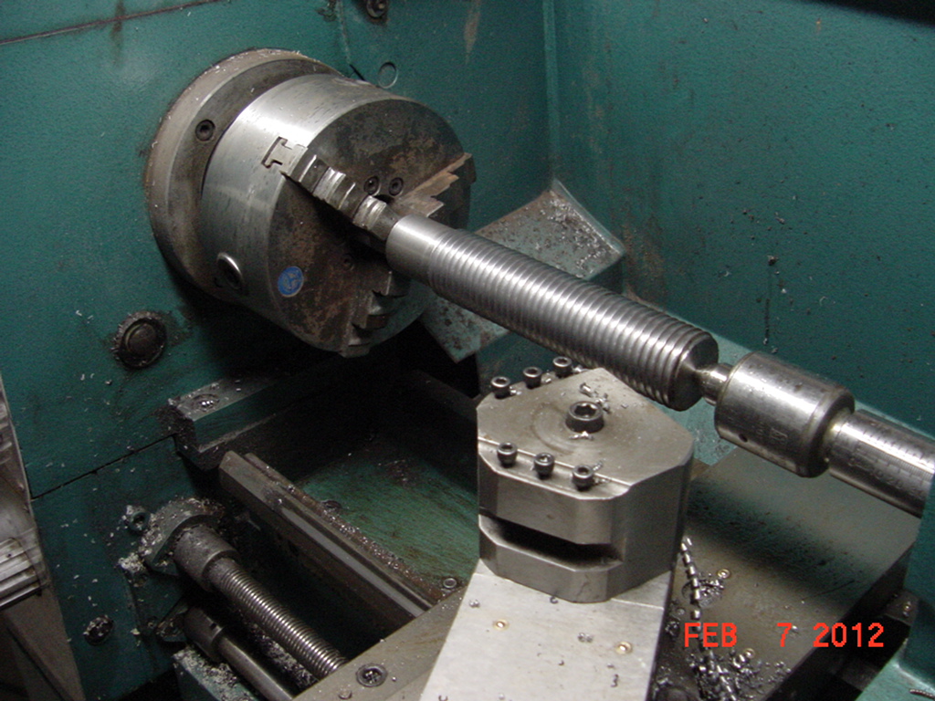

I just finished cutting the thread for my HD6G track adjuster.
1.600 x 5 1/2 TPI Perhaps it is a metric crossover but it fits into my yoke. It is not a 1 5/8 thread. I turned the shaft to 1.590 before I cut the thread. I'm going to weld it onto the old hex adjuster.

P.S.  Hey Dozer,
Your adjuster looks so short? Any idea how long they should be for a 6G?

Responding to Jay Tyrrell
The total length of the track adjuster on an HD6G is28.62". What you see in my lathe is the threaded part. I will weld this to the hex part.
The thread that fits in my yoke measures 1.60 x 5 1/2 TPI
If this is supposed to be a metric thread it would be M40x4.6
This is not a normal metric thread either. It is interesting that to be an SAE thread it would be 1.625 diameter. To be a metric 40mm threat it would have to be 1.575 diameter. In each case it is 0.025 off. I'm considering getting some tool steel and making a tap
1 5/8 x 5.5 TPI to clean out the yoke threads.
