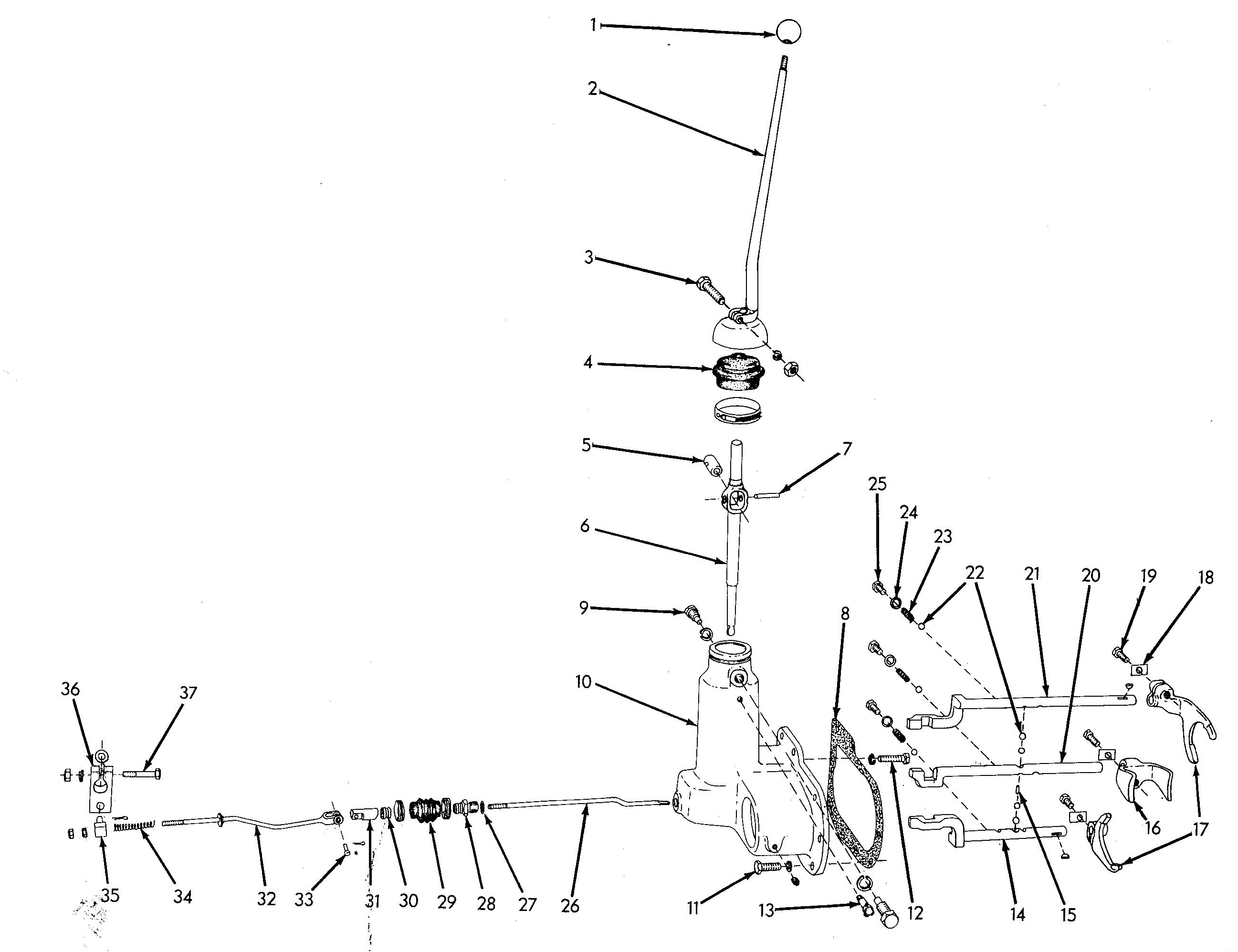

Post Options Post Options   Thanks (0) Thanks(0)   Quote Dozer Quote  Post ReplyReply Direct Link To This Post Posted: 29 Dec 2014 at 9:07am
I have not done this but it looks like you do not have to remove the transmission to get the forks out.

Post Options Post Options   Thanks (0) Thanks(0)   Quote Dozer Quote  Post ReplyReply Direct Link To This Post Posted: 29 Dec 2014 at 9:16am
Sorry It looks like I uploaded a large picture The interesting part is
bottom right.

Post Options Post Options   Thanks (0) Thanks(0)   Quote Coke-in-MN Quote  Post ReplyReply Direct Link To This Post Posted: 29 Dec 2014 at 10:30am
fixing 5 , 7 , 9 and building up end of 6 solved my problems and that of 3 other machines I worked on .
 The 5B I had the lever was straight and less wear than the 5G with offset lever

Post Options Post Options   Thanks (0) Thanks(0)   Quote gemdozer Quote  Post ReplyReply Direct Link To This Post Posted: 29 Dec 2014 at 4:08pm
The lever shift  086705 is straight and the one on photo is the rod locking plunger
