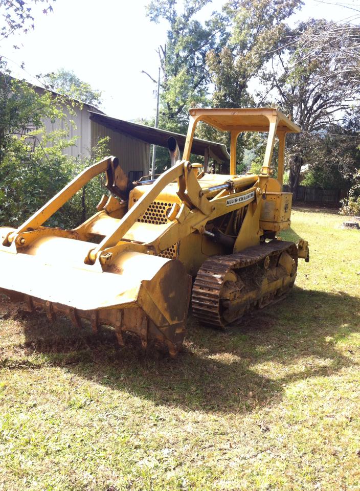

I am new to the forum. I have a 1971? HD6G-21196. Every thing was running strong and now when I engage the Engine clutch operating lever, it will barely move or not move at all (in forward or reverse). I am not very familiar with the machine. Any ideas on what could be wrong, what I need to look for. what can be done to fix it. Any help would be great.

If I am understanding you,you have a clutch and not a power shift. If my assumption is correct you need to adjust the clutch. Those better than I at explaining can tell you how to adjust it.A operators manual would be very helpful.

I believe it would be a clutch. From research it is either a "Rockford" engine clutch or an "Auburn" engine clutch. I am not sure what the difference is or how to know which I have. I am praying that is just needs adjustment. But it is all new to me and any suggestions/recommendations/tips would be greatly appreciated. Allis_Chalmers_HD6G.jpg
