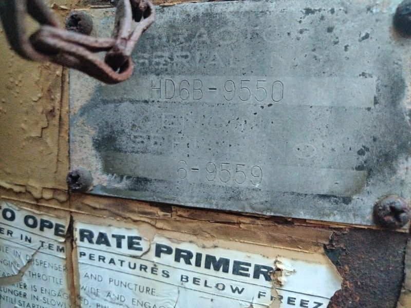

I am trying to confirm the year that my HD6B as manufactured to obtain the service manuals for it and the parts catalog. I was told that this was a '64, however the serial number on the tag indicates that it is much earlier than that.
The tag on the instrument panel was highly corroded and barely readable. I have photos of the tag before I cleaned it off with steel wool to verify the serial number.
Tractor: 6-9550
Engine :6-9559
Engine Tag:
Instrument Panel Tag:

your HD6B is 1958 build with the HD344 Buda design, indirect injection engine
tits tyres and tracks
they all cost you money
