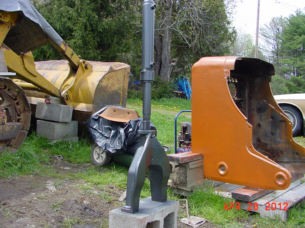

Is it possible to convert screw track adjuster to hydraulic and how did you do it. Thanks.

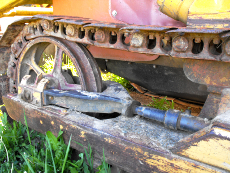

Yes My HD6G has one screw type adjuster and one hydraulic adjuster that I made.
I have a better design If I ever do it again. I would consider selling this one.

Post Options Post Options   Thanks (0) Thanks(0)   Quote Dozer Quote  Post ReplyReply Direct Link To This Post Posted: 31 Aug 2017 at 4:54pm
I designed it in autocad. I can mail a copy of the drawing I worked from if you have access to a machine shop. PM your address. I used 2" ID 0.250 wall DOM tubing 15" long. The thread on the AC adjuster is 1.600 OD 5.5 threads per inch.
Like I said I made it. The rod diameter I used is 1.750 Dia. A purchased hydraulic cylinder would not be up to the task.

Post Options Post Options   Thanks (0) Thanks(0)   Quote LeonR2013 Quote  Post ReplyReply Direct Link To This Post Posted: 02 Sep 2017 at 6:14am
Very neat job. One good thing I noticed was it still has the place to use the wrench on.

Post Options Post Options   Thanks (0) Thanks(0)   Quote Dozer Quote  Post ReplyReply Direct Link To This Post Posted: 02 Sep 2017 at 7:59am
Also note that I drilled and tapped (2) places on the yoke for grease fittings. The original screw adjuster was rusted in place. I drilled these holes to lubricate the screw so I could remove it.
