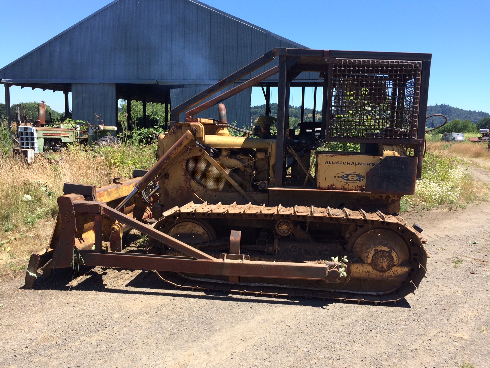

The HD6B / AG I am buying seems to be a mutt of sorts.  It has the HD6AG engine with turbo and all the associated correct appearing according to others who have seen the pictures, but it is a 1965 HD6B according to serial number.  Does have 5 roller track frames.  It needs some work before I can use it, runs fine but left steering clutch is slipping badly.  Not sure if it is worn or contaminated with something.  Planning on fixing that as soon as I get it home early next year.  I had a thread on correct Carco winch for it.  Alternatively interested in just a plain old AG style 540rpm PTO output.  Not sure what I need to achieve that.  Also possibly hydraulic remote.  Just some curiosities of things I could do with it provided I could add some other options to it.

Definite aftermarket or custom made blade, nice cage.

Tracks look good and tight. Darrel

I would think the track is to tight, unless the last movement was in revers and all slack is on the bottom(old auction trick ,back it into place on the line). And by position of blade cannot see if there is adjustment left in track. But it looks like rail and sprocket may have life left. To many things keep from ever having photos tell to much about undercarriage in my experience.
Gear units to make 540 pto are rather rear, so that could be a big hunt unless your real lucky. Hopefully the current hydraulic valve is not in the tank, then just change it out to have another set of outlets for rear tools. Most of the old rear mounted hydraulic units are to low of pressure to be of use with modern equipment.
But all in all not a bad looking machine. If your lucky adjustment of clutch may fix the steering.
