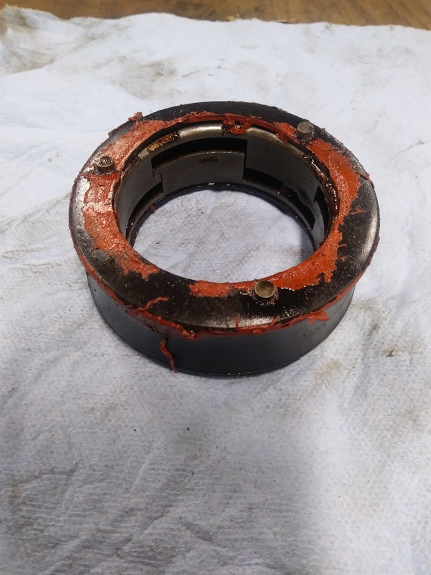

The Previous Owner apparently used the wrong adhesive on the final drive outboard bearing seals. It didn't stay 'stuck' Cry It appears to be some sort of silicone as it is still somewhat 'rubbery'. The seal surfaces are still good, and the seal could probably be re-used if it could be adequately de-greased to accept a proper adhesive.
Damage to bearing housing:
The 'unstuck' seal appears to have rotated in the housing; two of the pins were found on the other side of this bulkhead nestled in the groove behind the bearing. The bearing itself appears to still be serviceable, but I have no idea as to how to salvage the race that is still inside the housing without damaging it.
We are in need of a serviceable bearing housing if anyone knows of a source.

Update:
Having read through 164 pages of posts on the Construction forum I remembered seeing this thread by dadsdozerhd5b https://www.allischalmers.com/forum/hd5-outboard-seals_topic133302_post1101878.html?KW=HD5+seal#1101878
He reported having 0.035" gap at the seal faces; I have found ours to be ~0.100" gap. This thing was never even close to being sealed up when it was last assembled.
I am not sure which axle we have as I cannot see the splines to get a count.The axle nut is the type having the cup as referenced in my manual as the "Second-Type".
I am contemplating making a spacer and gluing it in with epoxy to cover the damaged area and also take up the gap.
How much should the seal assembly be compressed to achieve proper sealing?

Does anyone know what the actual difference is between the First Type seal (KIT NUMBER 073763) and the Second-Type seal (KIT NUMBER 088665)?
I suspect that the Second-Type is longer to make up for some other difference between the old and the newer. There certainly seems to be a significant tolerance difference as noted by dadsdozerhd5b and myself.
Does anyone know of a source for the production drawings of our machines?

My Daughter mixed up a batch of homemade playdough for me to play with (the grandkids got the remainder when I was done).
I stuffed a wad of playdough into the space where the axle seal goes, then set the bearing housing in place to see how much clearance there is. The camera angle isn't quite perfect, but it shows about 2 1/16" (2.06") space that needs to be filled by the seal pack just to take up the space with no compression of the spring assembly
The new seal pack assembly measures just under 1 13/16" (1.8")
That leaves a fat 1/4" of gap before the seals even make contact. The spring assembly can compress ~1/4" before bottoming out, so a 3/8" inch spacer should leave the spring assembly at about mid-range of travel.
I need a window in the bearing housing to see where it all fits when everything is bolted down tight.
Edit: I believe the gap will be a bit less than stated above after the axle nut is tight. But how much?

The sprocket compresses the seal package as install it
Need to remember that point in your measurements.
There is the specific glue for these still available, from Diving Shops, neoprene cement. Silicones or other materials do not bond well either to the cast or the neoprene rubber seal bellows.

The length of the sprocket spline less the tightened gap of spline to the shaft spline where first removed the nut is the depth the back of the sprocket will be relative to the housing. Was a spec in my 7G service manual as to that depth of spline but my manual is gone. If your sprocket had no clearance of end of shaft spline to outer face of sprocket it will not ever tighten up or will compress too far into that seal if make a spacer for behind the nut.

If I can add to DMiller's post do use a cement for "Neoprene rubber" and ensure all mating parts are clean and oil free. Solvent, and acetone are your friends here.
I've chased a lot of leaks in years gone by on finals thanks to Permatex, (and the like) silicone usage where a neoprene rated cement was needed.

UPDATE:
After taking dozens of measurements, making drawings, and much deliberation I ended up by making a 1/4" spacer for the right-hand side and a 3/16" spacer for the left-hand side. I made alignment pins out of drill stock and epoxied the pins and spacers into the housings.
New seals were purchased from General Gear in Boise, Idaho and we then glued them in place using the prescribed neoprene cement made by 3M ( we now have enough of that stuff to last many lifetimes).
It has all been back together for 6+ weeks now and my Son-in-law has put 5-6 operating hours on it with no leaks yet. If it is still good at this time next year I will call it a success.
I thank everyone for their help and input, I would have been lost without this forum for guidance on this project.
