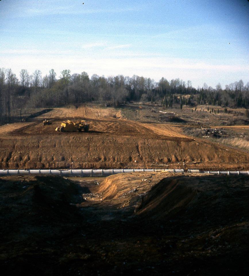

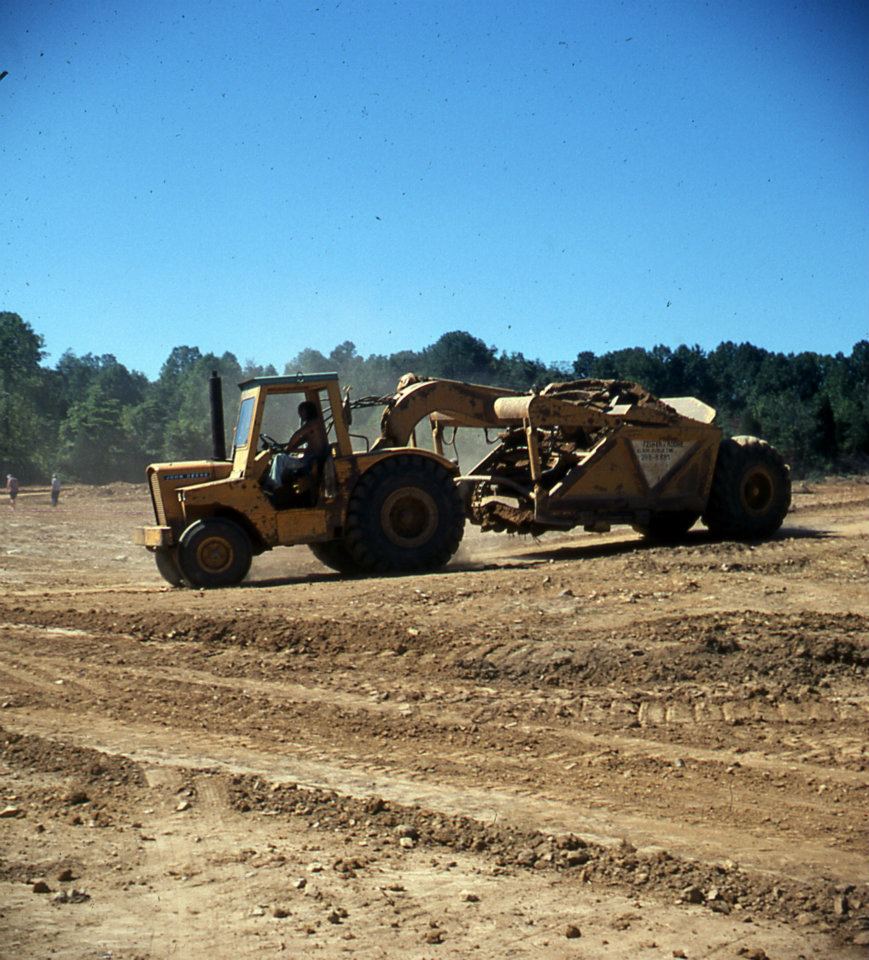

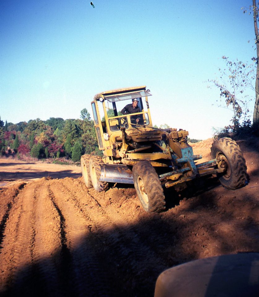

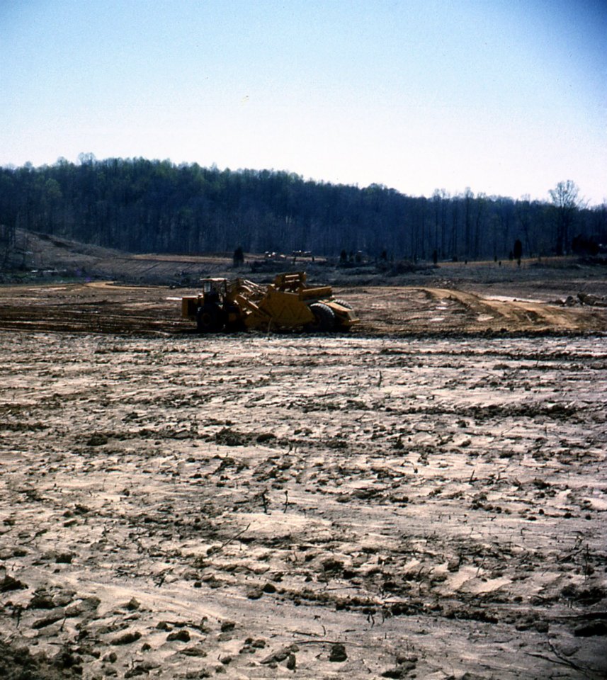

Here is the Allis Chalmers 260 Pan/Earth Mover. That was my machine. I loved running that dinosaur. After I spent the winter welding and helping rebuild the HD11 they laid me off. But I got lucky because they had an equipment operator that quit, he was running this small John Deere Pan. I had run a few old farm tractors when I worked on some dairy farms in Wisconsin but always had the attitude that I could do anything. So when this guy quit I stepped up and said I could run it. Once they explained the controls it only took a couple runs and I was in. I ran it 8 hours a day and another guy run it 8 hours. I loved running it except one thing, it would beat you to death especially on the haul road to and from the dam. I think we ran that machine 2 summers and the dam seemed like it was going no where. Especially the base being so long and wide. But then they bought the AC 260 which held 3 times the dirt. At first the other guy, Jim, ran the AC 260 and I ran the John Deere. Then we started seeing some progress. After a few months they decided to hire a couple more guys to run both machines 2 shifts a day. I got promoted to the AC and I got my young er brother hired on and taught him to run the John Deere. AH, the AC was so much better to run and easier on the body. Air Ride seat plus those monster tires made it feel like it was riding on cushions. With both machines running daylight to after dark is when the dam finally started taking shape. It was like you could see it everyday. Altogether I think it took 5 years to finish the dam. We spent the winters working on equipment and clearing the shore line. I cut down many, many trees which later on provided another source of income for me, firewood. Can't tell you how much firewood I sold. Here are couple other machines we used. This compactor being pulled by an old Case tractor.
This is a Caterpillar.
View of the dam, it was 1/4 mile long. there is a road across the top now as well as many homes built around the lake. the county agreed to pave and maintain the road in return for access through the lake property which covers 600 acres. I missed it when I was young and dumb. Lake lots went for $6000 with waterfront. all others were $4000 One undeveloped lot recently sold for $57000. Although I live only 10 miles from the lake I'm not allowed on it, lol. Aint that a kick in the pants. private lake and access to lot owners or with lot owners. a girl of one owner caught an Indiana State Record Bass from there.
The old Case tractor with my ex-mother-in-law. another reason I have no access. I went astray after a pretty little blond that caught my eye. Oh well, my ex's father used to tell her there are more fish in the sea (besides me). I say, oh well, there are more lakes in the state, not just as close.
Hope you enjoy, someone mentioned that you all like photos. I have many.
