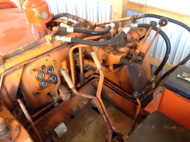

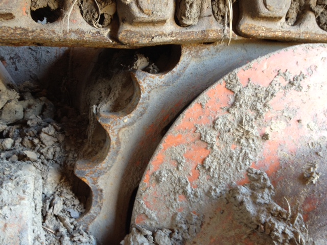

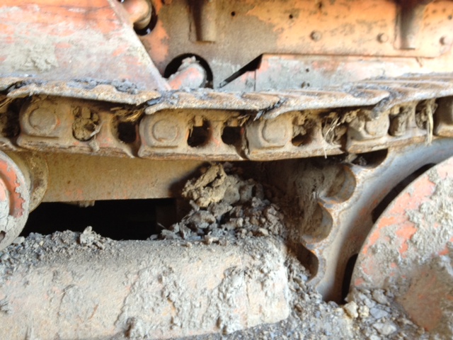

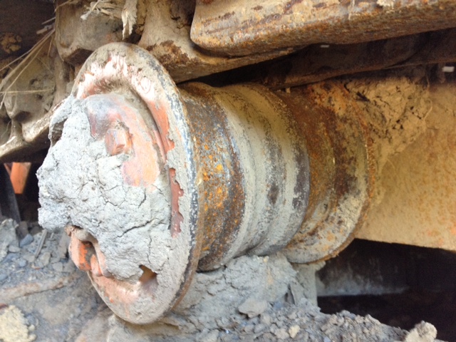

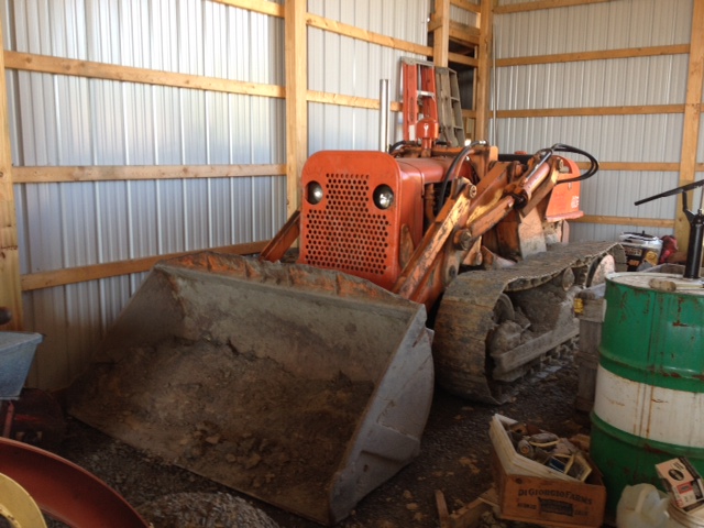

Hi, I was looking for some advise from the experts as to the condition of the undercarriage of this hd5g loader. I'm not very familiar with track machines and saw this one for sale, It runs and steers fine but i'm weary of the tracks and rollers and such as I know that this is what is most crucial. Is there any life left in these tracks / rollers or are they not far from shot? Was going to use it to clear some heavy brush and for limited use around a farm. They are asking 4500. Any opinions are appreciated-Thank you

The rails and sprocket look good but you don't have a picture of the bushings which could still have ware on them. Also looks like the pin boss maybe rubbing on the roller flanges which could mean the rollers maybe getting down. But hopefully I am seeing shadows and everything is good.For some reason tracks seem to stay on HD5 better than some other machines.I have a HD5B that the tracks have not been that good in 40 years and only when they are way out of adjustment(none left) do they want to come off.

   Sprockets and rails look good. Could be somebody put on new ones or turned the pins and bushings but did not do anything to the rollers. Like Ray said the roller flanges look like they are hitting the pin boss.  Have seen some people trim off about 3/8 or so off the flanges with a torch and run the rollers to destruction. Never really had much luck rebuilding rollers by welding them up as the bearing bores would shrink and if not machined out to correct specs they never seemed to last. Also if the rollers are worn down some it will make the tractor ride hard on the sprockets.  This can be helped by reversing the blocks that hold rollers on to the frame.  If you look carefuly the blocks are thicker on one side than the other. Or could add a 3/8 piece of plate with holes drilled to fit to lower rollers.  Be careful when removing rollers as they are held to frame with a short threaded piece of iron inside of track frame. Works good to remove rock guards and replace bolts holding guards before removing rollers. This will hold rollers in their correct place, if not at least use a square to line up rollers so they are square to track frame or it will tend to roll track off to the side.If it was mine I think I would just trim some off the roller flanges and run it if the pins look good.  Clean looking HD 5, you did good.

4500 seems high but I would want more than that for mine ..
rollers use timken bearings and not bushings in them , the shells can be welded up to spec by submerged arc by track shop.
 Some hit on end of rail pin boss but seems about normal as some will happen when turning . measure the distance between end of pin across 3 links to see internal wear on bushing surface of track
 Looks like it needs some new hoses on loader lift cylinders. Check the pin at the cylinder trunion also for wear . Unsure if late Srl# machine , cant see the loader frame behind bucket or to see if it has the long pin boss on the dump cylinder mounting point.
 Single speed reverse or 2 speed?
Check shift tower for sloppy lever feel as the cross pin wears and allows the shift ball to wear and jump past rail slots if to worn.( easy repair but necessary)

4500 seems a little high but if it steers correctly, runs and not too many leaks, it would be mine. worth 2000-2500 in scrap. weighs about 18000 if i remember right. go for it is my vote.Tongue
