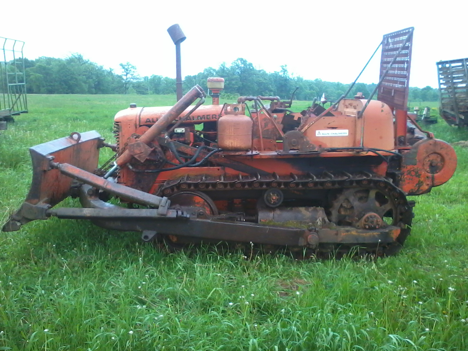

 I have a little 7+ton HD5 dozer with winch
 Tracks are not the greatest... Heres a pic.
 Must be the new style see thru bushings? LOL
 Think a simple pin and bushing turning would do it?  LOL

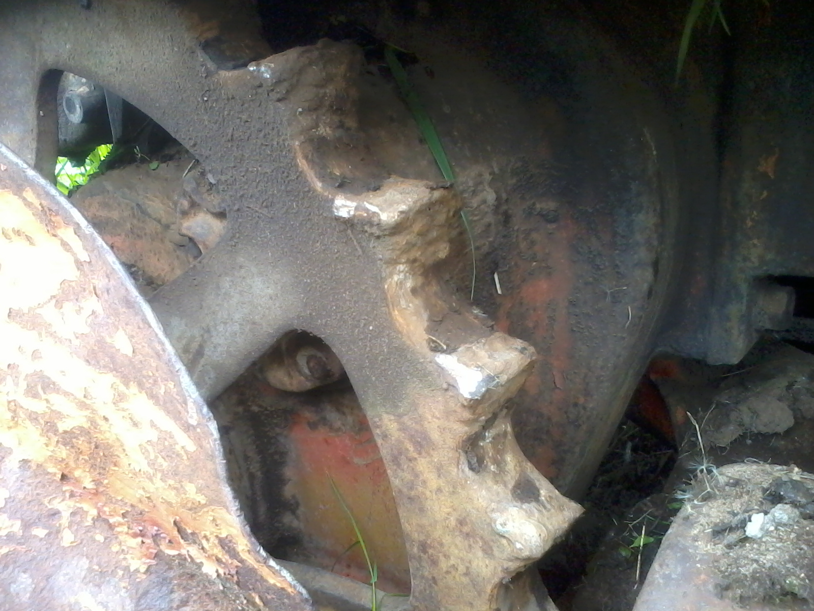

 Here is pic of worse side.
Think this sprocket is cherry?
 cut off/weld on or find nos ine piece sprockets?

The HD5 new links tightness are 3.687" and what I can see you need pine,boushing and sprocket and for the whinch you should have a lever for the brake and second for reverse and forward

Gemdozer, I think I need 66 pins and bushings, 33 of them for sure.
  Are whole or weld on sprockets available yet?
  Maybe have to set up on a jig and weld up and grind down the teeth and then heat treat?

There are parts on eBay located in Maryland. Weld on sprocket rings are available. There are 2 different sprocket splines.

I've got 2 sets of good tracks and sprocket rims for HD-5B... Located in San Diego (long way from Wisconsin).....

the winch levers: one is for forward/reverse, the other lever is for engage/freewheel. there is not brake on these winches. cables usually freeze up and do not work properly. I have a used set of tracks, the pins and bushings need to be turned, inside wear more than outside wear. rails are decent, slightly rounded on the outside edges but still useable. I think berco still has the weld on sprockets but not sure. pm me if interested. located in pa, a good ride from Wisconsin.
