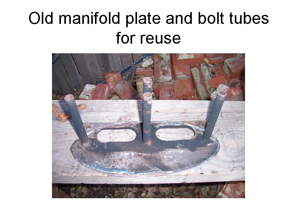

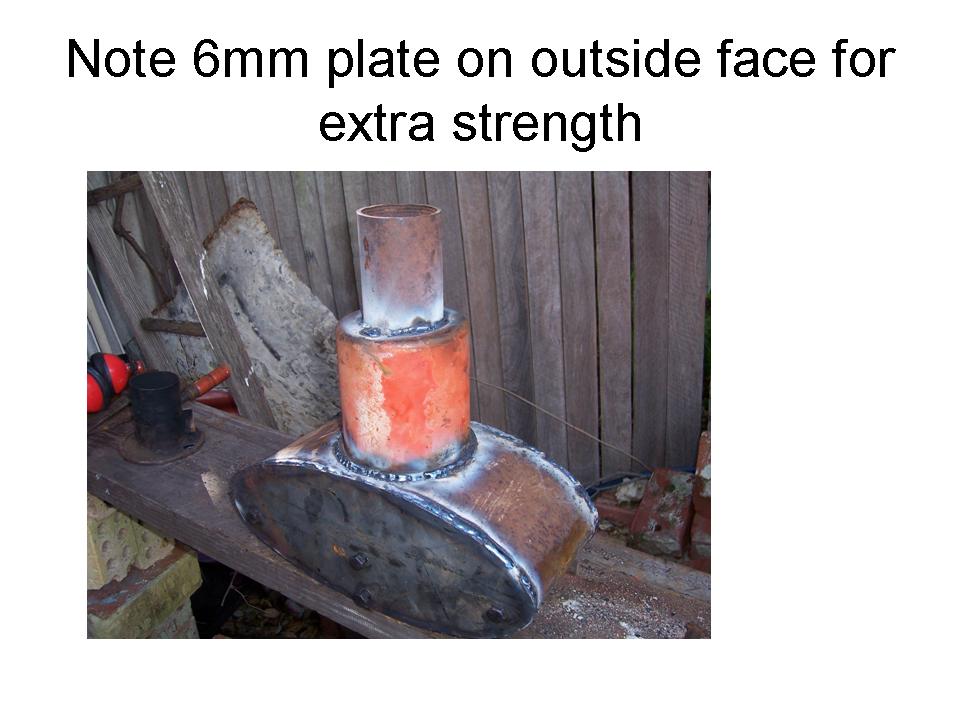

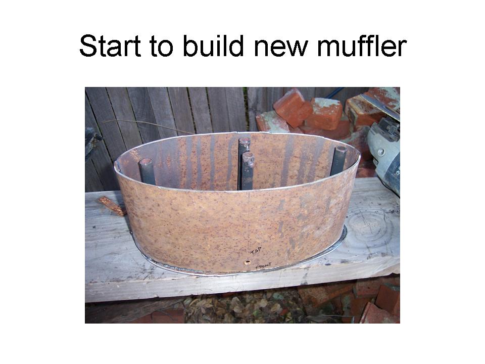

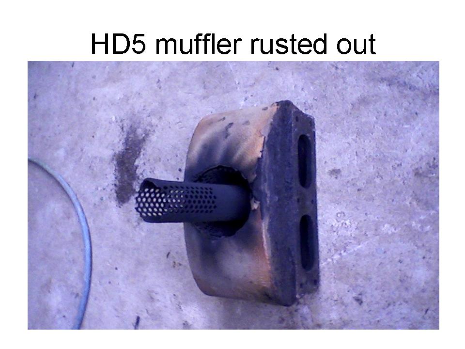

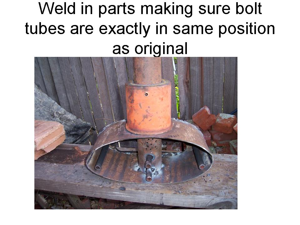

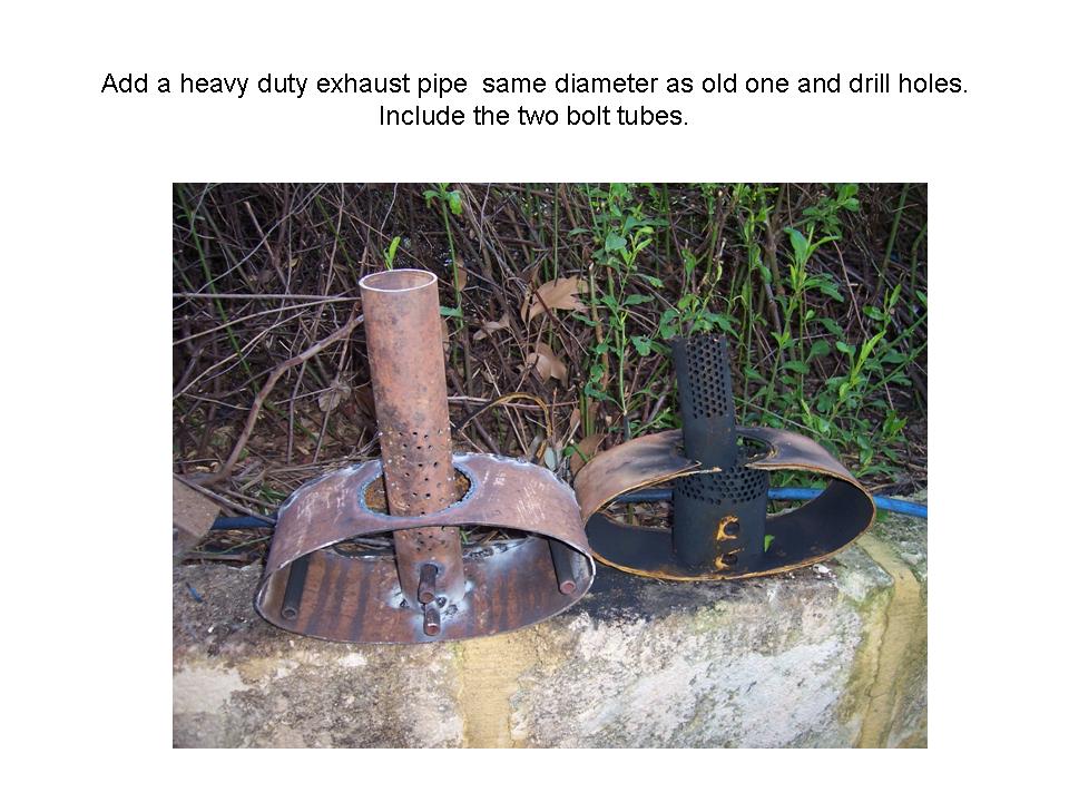

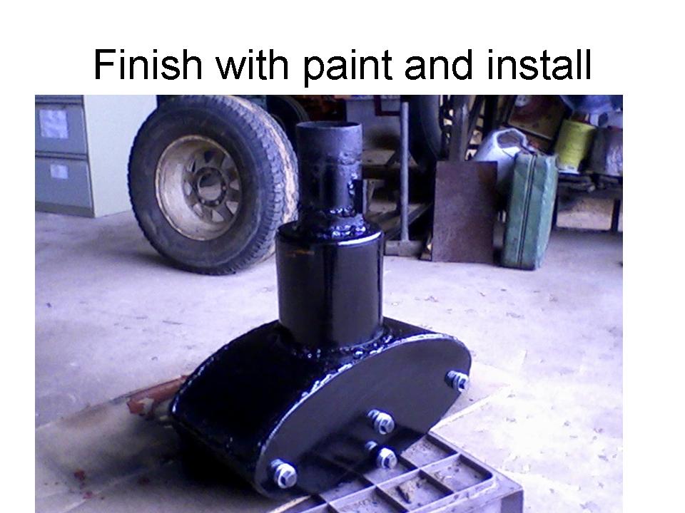

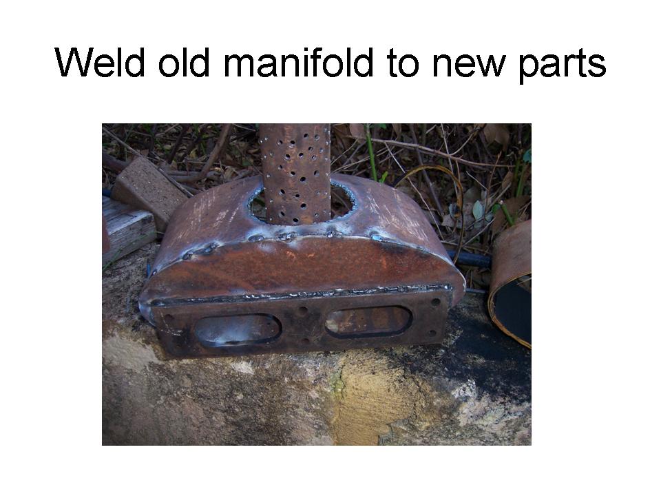

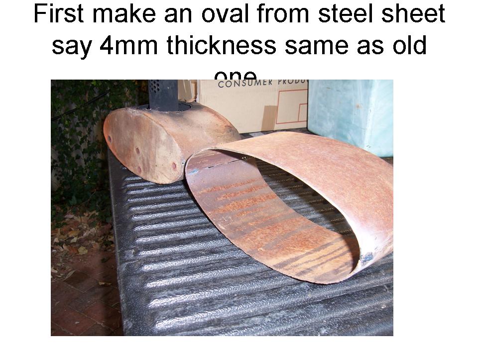

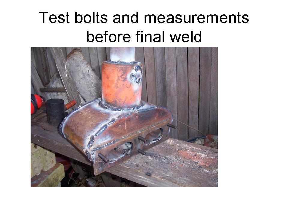

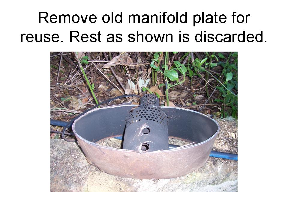

anyone interested in buidling a new oval mufffler for a hd5 see my pics on this thread.

 I built my own out of 4" driveshaft tube, using the back plate from origonal muffler as patter for mounting to engine. I used a vertical tube to attach a IH 10/14 tractor muffler .
 The muffler for the 2-71 generator is round unit and on one machine i sold that was muffler on it , worked good also.

Post Options Post Options   Thanks (0) Thanks(0)   Quote derekhopkins Quote  Post ReplyReply Direct Link To This Post Posted: 01 Jun 2016 at 10:51pm
pics no longer on image shack but are shown below

nice work!   we need to do something on dads HD15 with the 6-71 but its a few more cylinders

I have seen a home built and it was rectangular.Never saw it being used so do not know if not being rounded makes any difference or not.
I have added new skin to the one on my tractor several times. Of course it ends up being bigger each time. Out of room to do this again so next time will have to do it right like you have done it.
