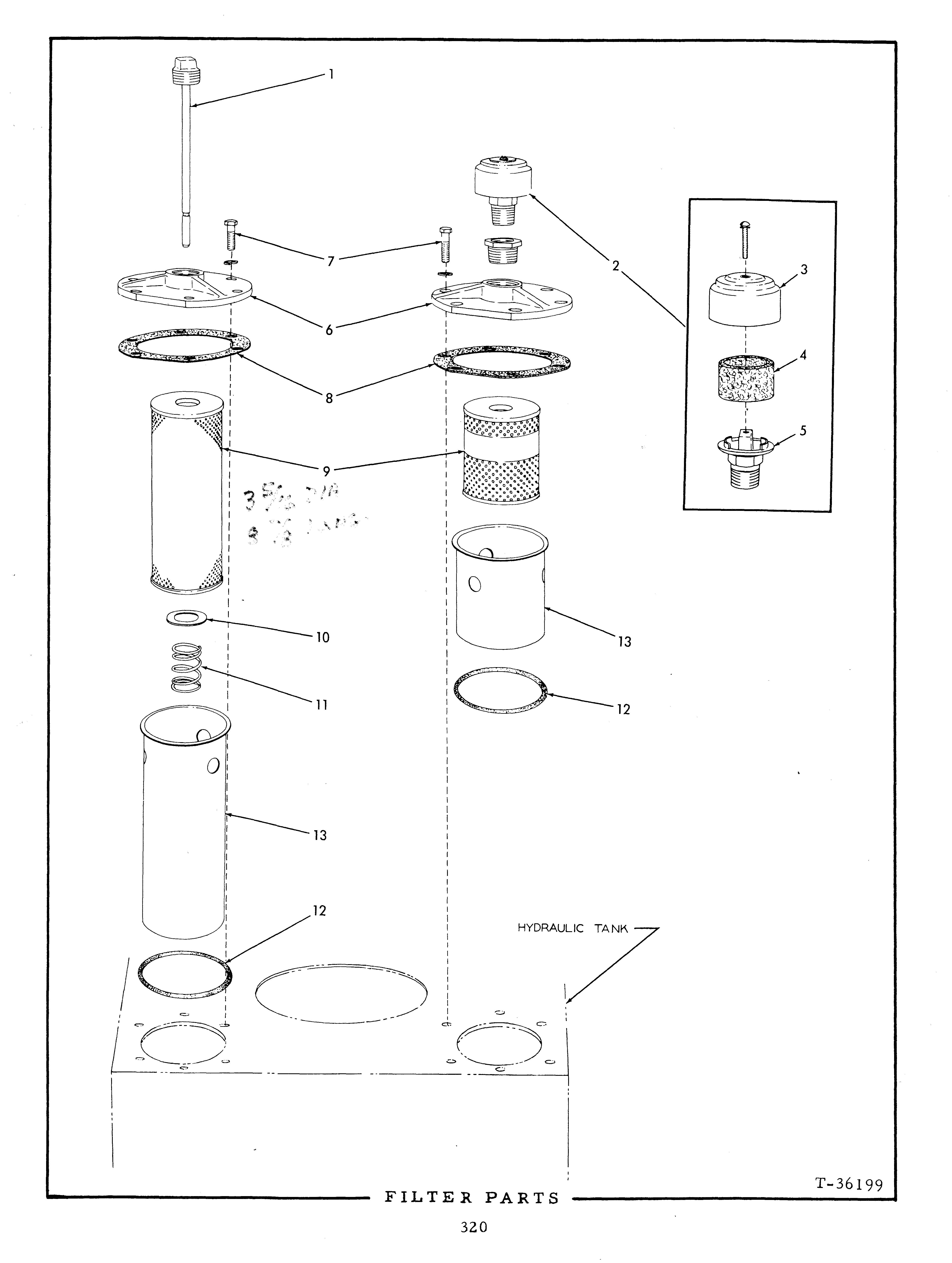

I need the aluminum hydraulic filter case # 3016079 for my HD6G. The picture in my parts book
shows the hydraulic filter as the longer case #13 Both of my HD6G's have what appears to be only the top of the filter case. A filter would fall to the bottom of the filter tank. Question: Is there more than one style of filter case for the hydraulic tank of the HD6G? My HD6G's are
1956 models. Suggestions as to where I can get (2) of these filter cases
Dozer View Drop Down
Joined: 16 Aug 2011
Location: SW New York
Points: 689
Post Options Post Options   Thanks (0) Thanks(0)   Quote Dozer Quote  Post ReplyReply Direct Link To This Post Posted: 28 Oct 2015 at 11:23am
Sorry about the picture. It looked OK on my computer before I posted it.
