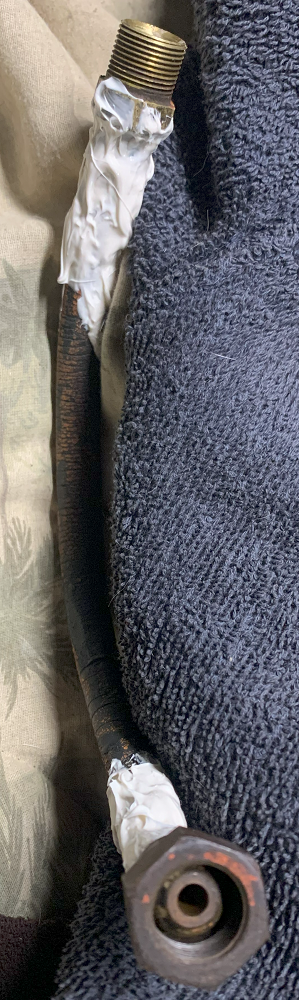

    Posted: 18 Oct 2023 at 12:02am
Trying to find a replacement hose, 059266 from original parts manual, the 11" hose the connects first stage fuel filter to tank. HD5G Detroit 271.  Temporarily trying hoping to get by with rtv silicone wrapped in tape.

Post Options Post Options   Thanks (0) Thanks(0)   Quote Codger Quote  Post ReplyReply Direct Link To This Post Posted: 18 Oct 2023 at 6:14am
Those are inverted flare fittings. I would change them both at the filter housing, and the fuel tank bung to NPT fittings barbed hose fittings and replace the hose with standard fuel line. This hose in hydraulic terms is SAE100R7 hose. Or, at the auto parts store, fuel line hose fitting the barb size you select, (usually 3/8").

Post Options Post Options   Thanks (1) Thanks(1)   Quote Coke-in-MN Quote  Post ReplyReply Direct Link To This Post Posted: 18 Oct 2023 at 11:03am
Start fresh with new fittings to replace the old hose . I replaced all hoses including the one to the bypass filter for engine oil - just had to make a restrictor to control the flow , and on the line to fuel gauge pressuer install a snubber to limit pulsation of gauge .
