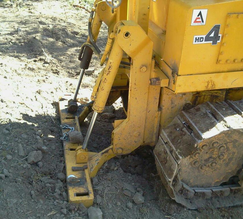

I would guess the shuttle pack on reverse gear is not holding. The shuttle changes the direction of driven gears in torque tube housing. I would first start there. Probably the cylinder that activates is is losing pressure on reverse side. I don't have my manual here at home. I would like pics of your ripper and the cylinders.I wonder which variation you have. Thanks Tracy Martin

Tracy here is the ripper set up. Tore the side cover off the converter resevior and only had 1 out of 3 o-rings on the lines there and a glob of blue silicone. Thought i might have found my problem. Put it back together and it worked for a second the no more reverse again. guess i will be back at it when it stops snowing.

am I seeing something like the the track is on wrong direction - grouser on back side of track and open side of track is forward. ????
