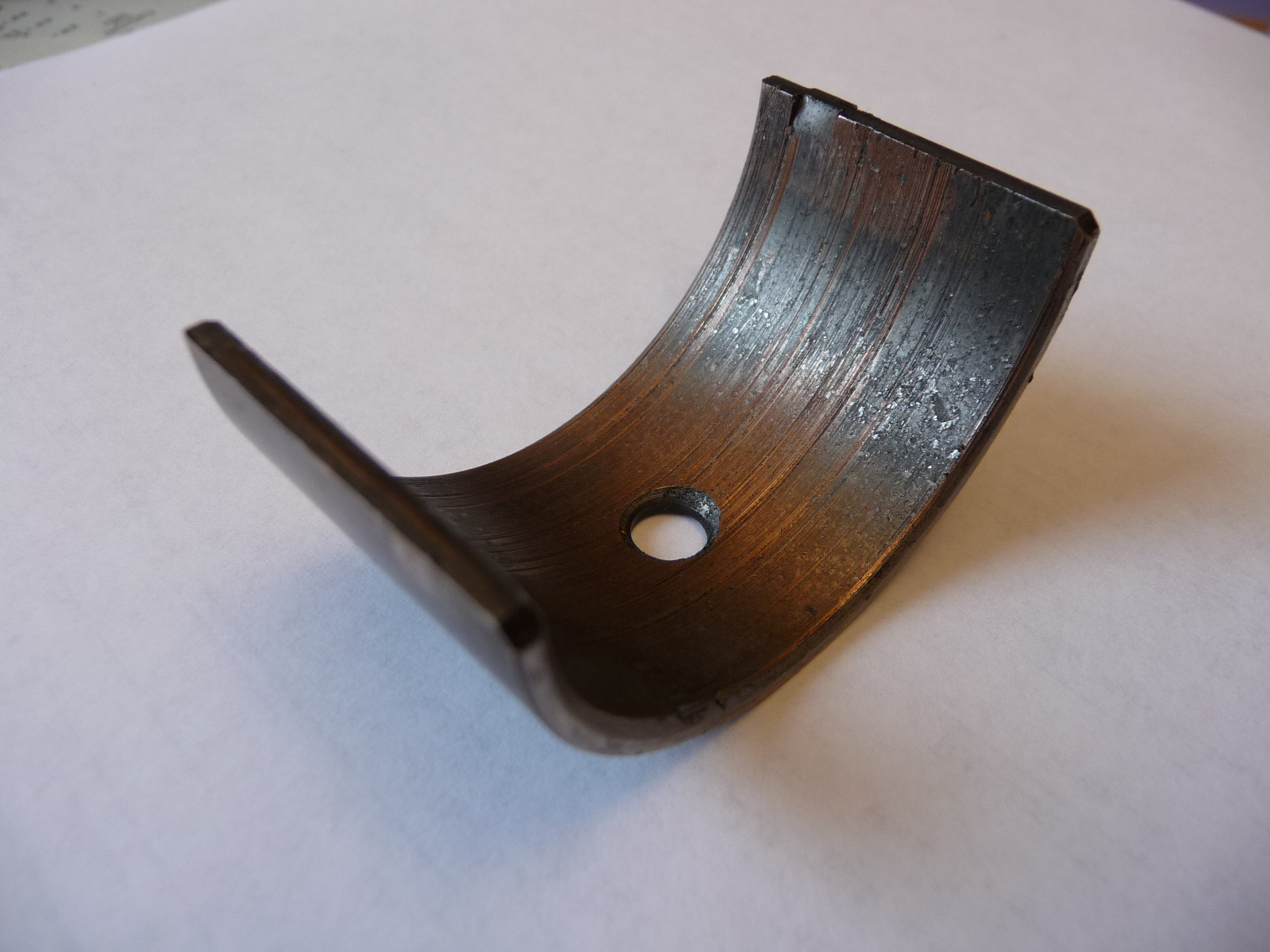

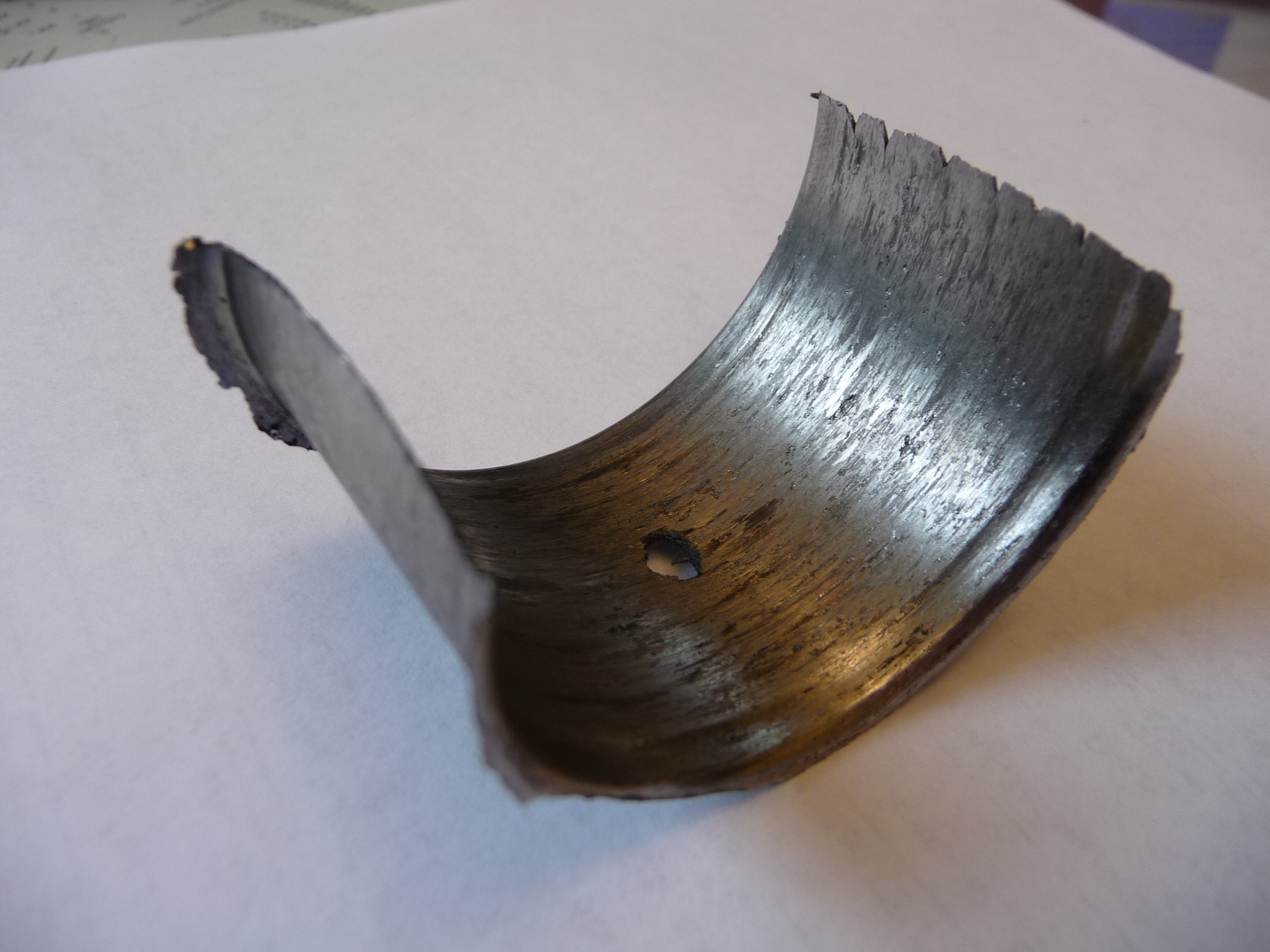

The old girl needs a rebuild. I tore it down and found the head was cracked in several places but it can be pinned. The engine also began knocking fairly loud and I suspected a spun bearing or something worse.
I have most all the parts I need for the rebuild except a gasket set. I bought a crank, cam, pistons, sleeves, bearings, etc. I also picked up a fresh rebuilt head for a fair price. I'll post pictures as I complete it.
Once I'm done with the engine, the only thing left will be the pins and bushings. It's been an enjoyable project. These machines are really easy to work on; heavy but easy.
The first couple photos are of the old rod bearings. The best looking bearing was from #1 cylinder. The spun bearing was on #4.
