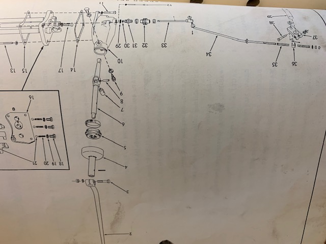

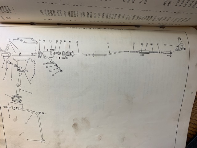

Jesse....Yes I concur with Cal....very common problem with any of those tractors that have been sitting. There is a linkage for both transmission levers on each side of the clutch yoke shaft. the linkage yoke clevis pins will freeze up and not turn....if the springs in the linkage are in good shape...they will let the clutch lever work and in gauge normally while the safety lock rods will not move. Don't know if you have a manual to look at ....but this is what they look like....maybe take the floorboards off...WD40 and a hammer usually does the trick.

Ok thanks for your help i will give that a try. Thanks for posting the parts diagram very helpful. I don't currently have the manual but have one on the way. I will let you guys know how it goes and post a few pictures of the old girl

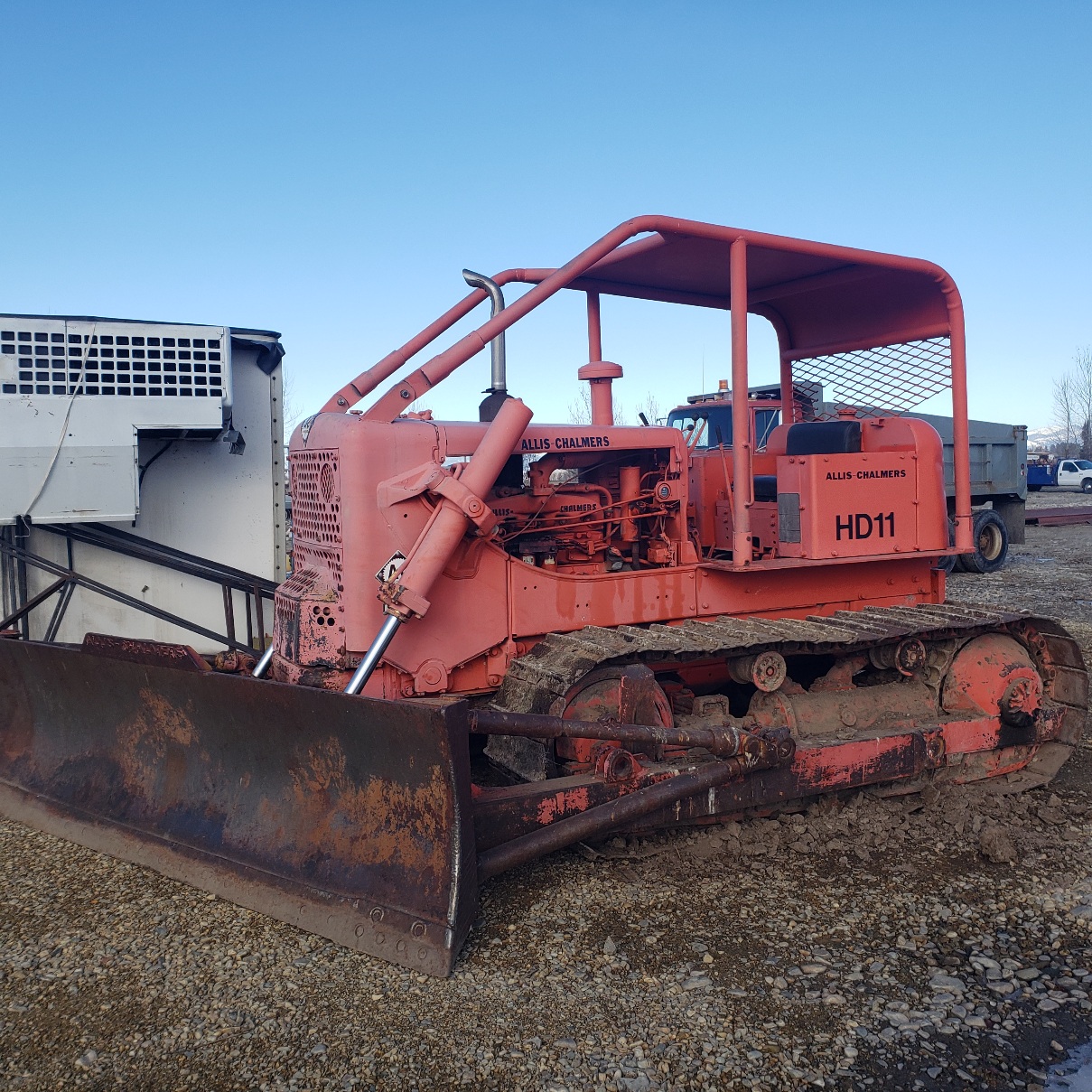

Post Options Post Options   Thanks (0) Thanks(0)   Quote JW Reeves Quote  Post ReplyReply Direct Link To This Post Posted: 26 Feb 2023 at 8:36am
Ray54 View Drop Down
Location: Paso Robles, Ca
Points: 4871
Post Options Post Options   Thanks (0) Thanks(0)   Quote Ray54 Quote  Post ReplyReply Direct Link To This Post Posted: 26 Feb 2023 at 7:23pm
Good looking tractor. I ran a HD 9 with the same dozer, always like running it.  But that was 30 years ago, so not remembering the exact brake adjusting job. But in this case make sure all linkage is moving, no lost pins or rustand not moving and such. Once brake band is moving may need adjustment, or replacement of lining.

Post Options Post Options   Thanks (0) Thanks(0)   Quote wjohn Quote  Post ReplyReply Direct Link To This Post Posted: 26 Feb 2023 at 8:46pm
I agree - good looking machine.

Post Options Post Options   Thanks (0) Thanks(0)   Quote AC Mel Quote  Post ReplyReply Direct Link To This Post Posted: 26 Feb 2023 at 9:28pm
WOW! Nice specimen...I like it!...So as Ray says.Are you sure you have all the linkages freed up? More WD40.  So you say "the left brake will not engage"...again are we talking about possible linkages that are stuck.....or does the brake pedal work freely? How much travel does the brake pedal have? Or is it a steering clutch problem? Does it engage and the brake doesn't work? Or does the steering clutch not engage...and the brake won't help turn? The brakes are pretty easy to adjust....unless the lining is worn...and or some of those linkages could be froze up from sitting for at least 10 years.

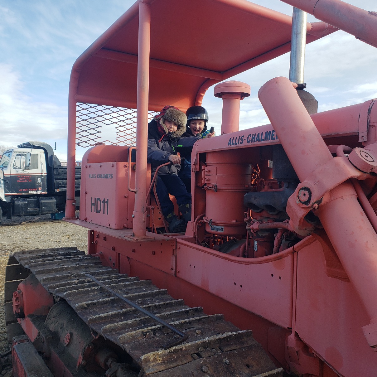

   Looks like it was cold when you took that picture.
