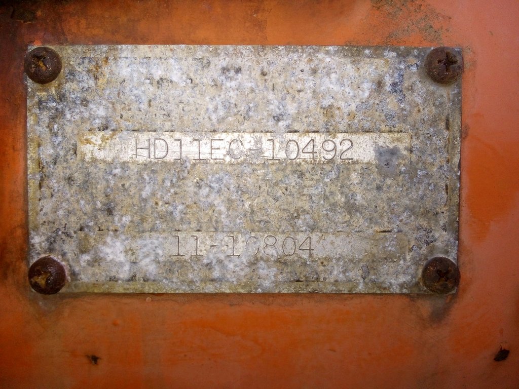

this machine currently is in a snowbank. does anyone know where the machine serial number is located? would save a ton of digging for me.

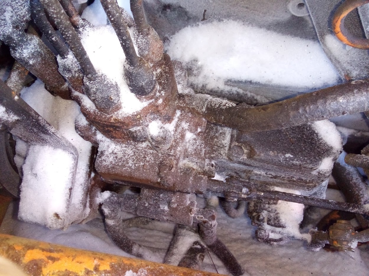

So I have more info- it's a 1964 HD11EC with a psb Bosch pump. I need to know the model pump Im looking for as the shops can't help me until I can provide them with that info. Any Ideas?
handytravis
Bronze Level Joined: 25 Feb 2020 Location: Alaska Points: 25 |
Post Options
Thanks(0)
picture of the pump on the machine. It's still in the snowbank

injpumpEd
Orange Level Access Joined: 13 Sep 2009 Location: Walnut IL Points: 4781 |
Post Options
Thanks(0)
The pump name tag is on the side of the governor housing right by the throttle rod in the picture. The PSB6AXXXXXXXX is the number any pump shop will need. The core I have here is PSB6A-100EH5278A4 with an AC number of 433783? can't read last digit. Good luck!
