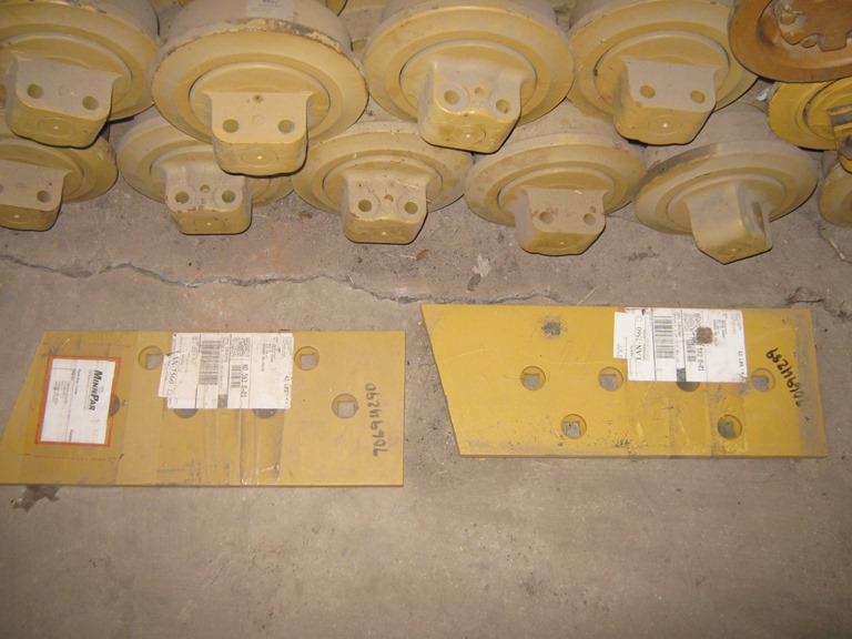

70691684- straight bits
70694289- LH (for angle dozer, also fits straight dozer)
70694290- RH

This is what the angle bits look like.  Some guys put them on the straight dozer for rooting- some even put longer ones on.

Nice pile of 'Spares' you have there!

I'm collecting for my next project...Big smile  Keeping my eye out for a good 11-B with bad undercarriage so I can use my pile.

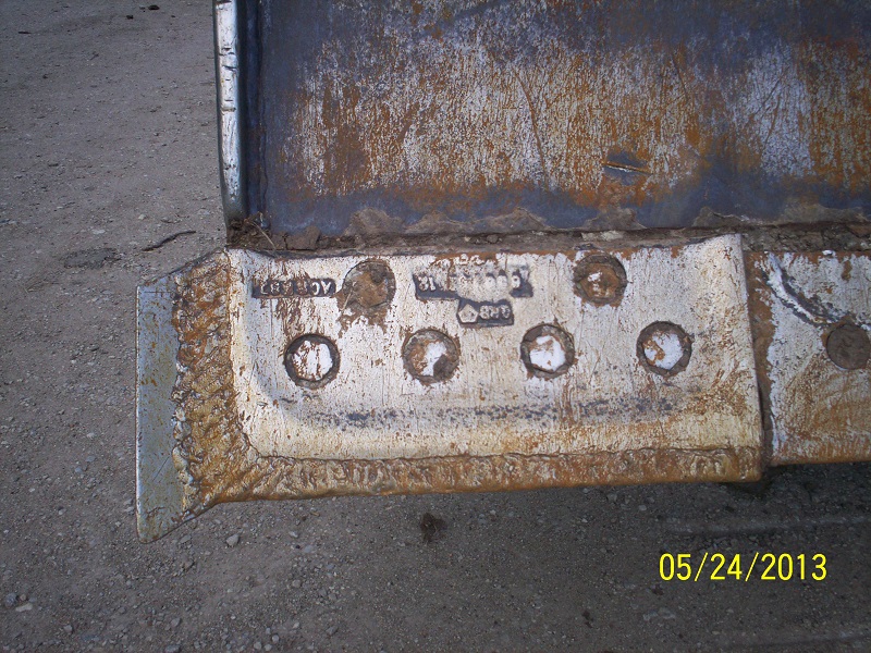

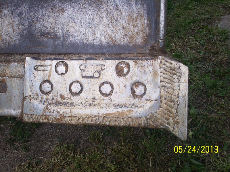

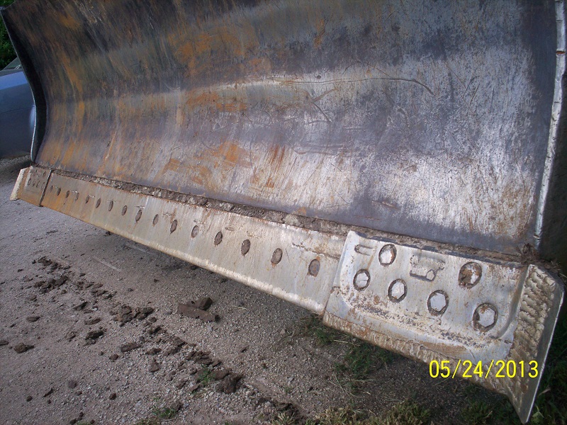

how hard you gonna use it?  you could do this.  5 lbs rod each side and some cutting edge
