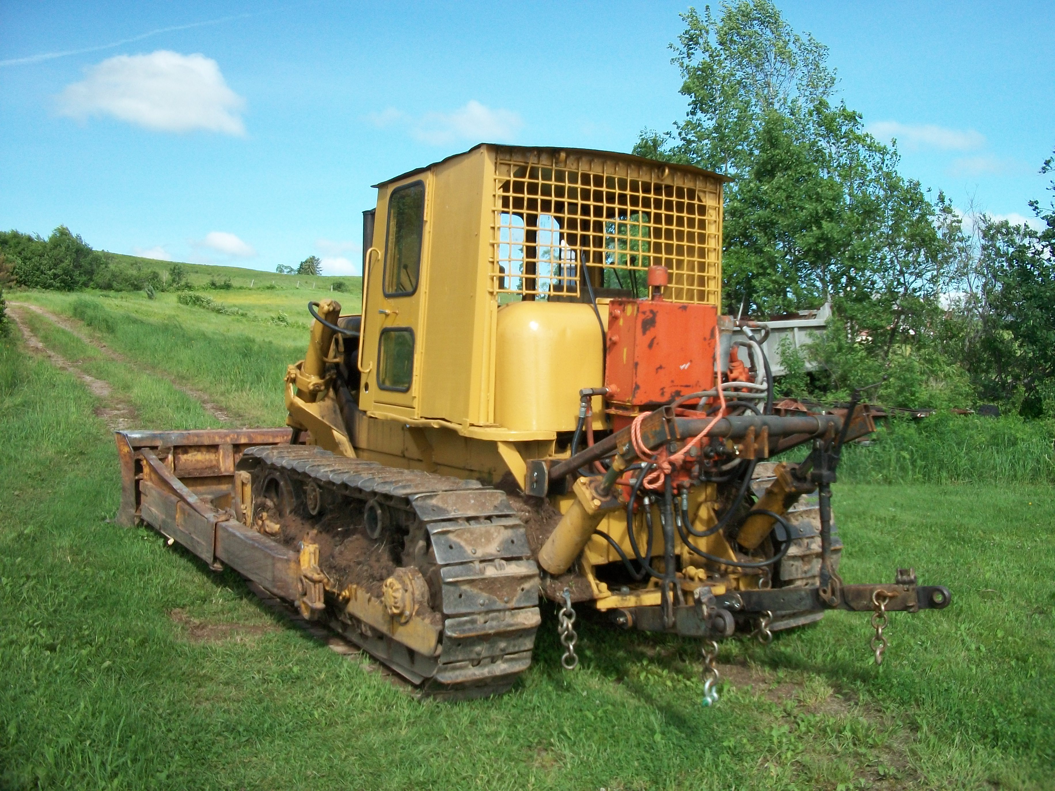

I INSTALLED HYDRALICS ON BACK OF MY HD9 LAST WINTER. PURCHASED A UNIT  OFF BACK OF HD11 FROM GENERAL GEAR. I NOW HAVE THREE REMOTES. ONE I USE TO OPERATE THREE POINT HITCH I BUILT FOR TRACTOR. PURCHASED A FOUR FURROW SEMI MOUNT PLOUGH ; USING SECOND ONE TO OPERATE BACK OF PLOUGH. TRYING TO POST PICTURE BUT NOT MUCH LUCK.

Post Options Post Options   Thanks (0) Thanks(0)   Quote R.KYLE Quote  Post ReplyReply Direct Link To This Post Posted: 17 Jun 2014 at 9:01pm
Andrew_D View Drop Down
Joined: 28 May 2013
Location: Newdale,MB,Can
Points: 148
Post Options Post Options   Thanks (0) Thanks(0)   Quote Andrew_D Quote  Post ReplyReply Direct Link To This Post Posted: 17 Jun 2014 at 9:37pm
That's quite the setup on the back of there!! Would love to see more pics of the entire machine!
