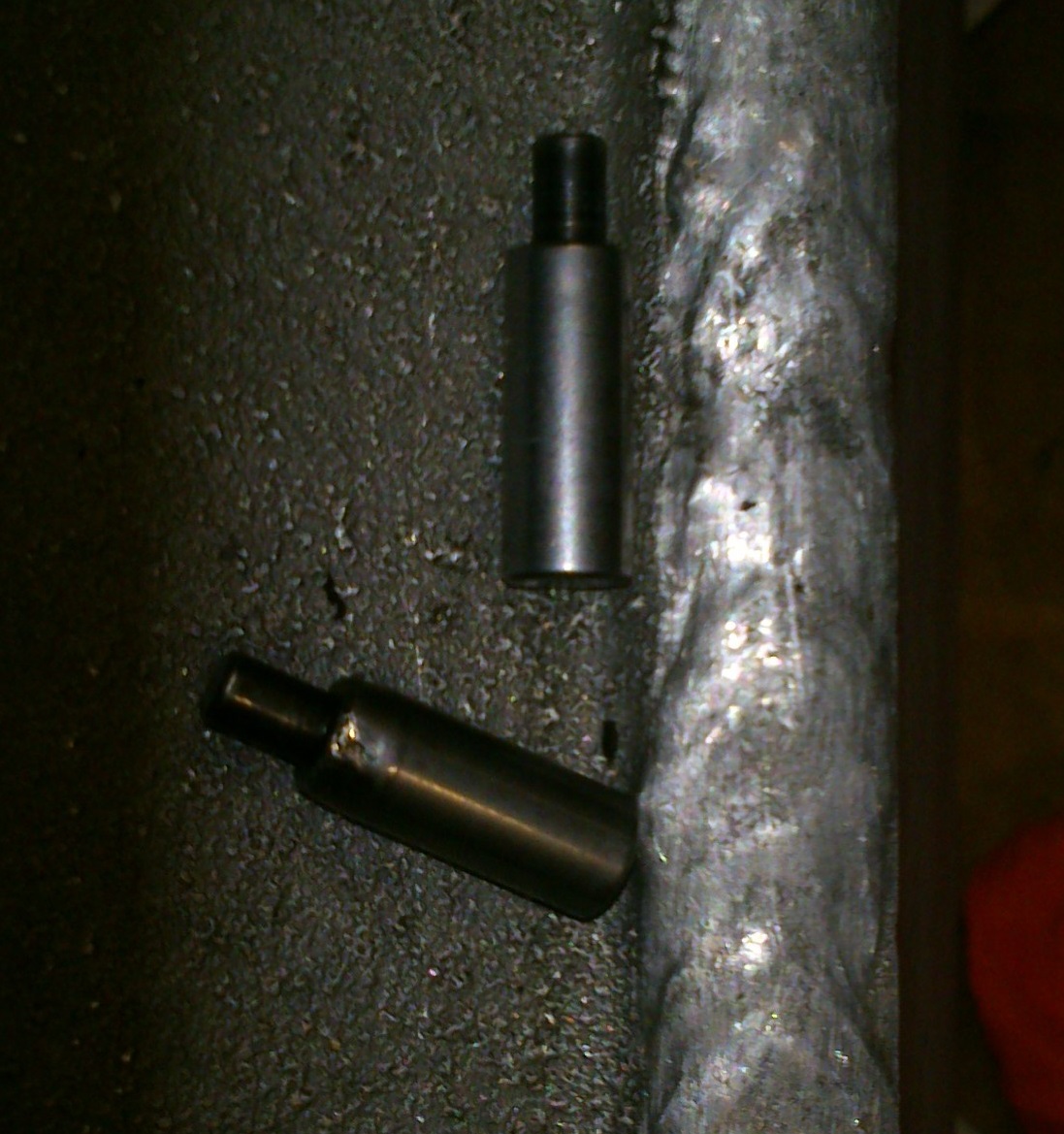

We are doing some overhaul on our HD11ec Engine and the "projekt" is going fine.
It is a hobby and i like old allis bulldozers.
My son was cleaning the turbine/converter oil tank under the bellhousing, crankcase. And he found two rolls ?
the clutch turbine is still bolted to the Engine .
They look like they came out of a straight roller bearing but they are having a small end at one side !
dia is 1/4" Length is 5/8" plus a small dia 1/8" at one end ?
My hope is that it might be left overs from earlier failiure of starter.
I have never seen this kind of rolls in a bearing, and it dont seems to have been"two" small ends ( i thought they might have been broken of ).
But there is no cracked area or so, smoth and grinded !
Can it be some guide pins or something like that?
I dont want to tear down the whole thing to have a check (but i guess i have to! ).
Any ideas of what or were they are or is suposed to be ?

If you don't have a parts manual, you can find them at Minnpar.com.  Sounds like they could be dowels....

Hi !
I Think you are right, i tested with a fine rasp and they were not hard.
But were do they came from. i dont have any book yet.
thanks for replying , i find this forum interesting to read and follow different projekts !

These look like roller over-running cluch

Christer
A roller from a overrun clutch would be hardened. I think it is part of the spring seal assembly.

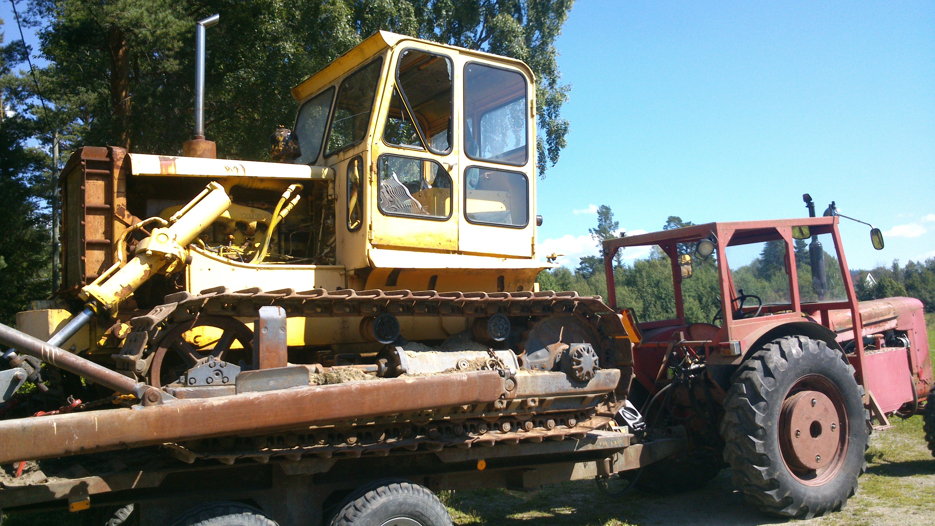

Post Options Post Options   Thanks (0) Thanks(0)   Quote allismannen Quote  Post ReplyReply Direct Link To This Post Posted: 13 Jan 2015 at 11:37am
Hi George !
And a happy new year !
And the Picture !
So you Think it belong to sealing ? (rollers/pins)
It make sence,
I did drive it but only 30meters if working ok ? can not say, otherwise that it seemed to bee working ok.
thanks for all input !
christer

Dozer View Drop Down
Joined: 16 Aug 2011
Location: SW New York
Points: 689
Post Options Post Options   Thanks (0) Thanks(0)   Quote Dozer Quote  Post ReplyReply Direct Link To This Post Posted: 13 Jan 2015 at 5:05pm
Christer has a video of this rig on the highway. I was impressed
I resized the image so it will fit better. I hope I did it correctly. I tried to resize it to 8.5 x 11 inches.

My youngest son would say those are "wiggling pins", they go in the "wobbling shaft",
