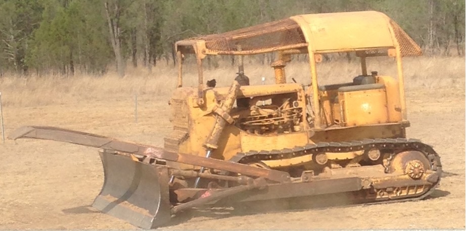

Hi,
I have a HD11E serial 8321
After some pushing i noticed it started to not push as hard, so i decided to head back to the shed so if it had any issues it can be fixed at the shed rather than in the middle of a paddock.
I made it back to the shed just in time as when i arrived it lost forward and back motion.
Im wondering if its just the clutch/transmission or has anyone had this happen to them ?
I had to tighten the clutch with a long pry bar, to make it back so i assume its clutch only.

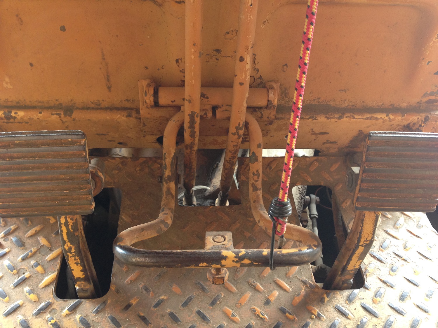

Another issue that happened a while ago was that the de revving pedal had lost its spring so i had to jerry rig a bungee strap to give it back its spring, how would i fix this ?
I am located in Australia, any help would be appreciated.
See some images below of the unit.

Do you have a wet or dry master cluch and removd the floor plate and check the drive shaft is turning  when you say he is't moving

Post Options Post Options   Thanks (0) Thanks(0)   Quote jchance Quote  Post ReplyReply Direct Link To This Post Posted: 26 Jan 2016 at 5:01am
yep the drive shaft is spinning, i think its a dry clutch

CAL(KS) View Drop Down
Joined: 18 Sep 2009
Location: Chapman, KS
Points: 3804
Post Options Post Options   Thanks (0) Thanks(0)   Quote CAL(KS) Quote  Post ReplyReply Direct Link To This Post Posted: 26 Jan 2016 at 3:30pm
very odd to have both steering clutches out.  i think you have something else going on
According to parts book you should have oil clutch unless special ordered with dry clutch
ENGINE CLUTCH AND HOUSING
(Oil Clutch)
USAGE: Models HD11B, E,ES,S, F. Standard on tractors serial No. 6911 and up
(Dry Clutch)
USAGE: Model HD11B,E,ES,S,F tractors prior to serial No. 10001. Standard on units prior
to serial No. 6911; optional thereafter
Edited by CAL(KS) - 26 Jan 2016 at 3:47pm

Post Options Post Options   Thanks (0) Thanks(0)   Quote jchance Quote  Post ReplyReply Direct Link To This Post Posted: 26 Jan 2016 at 3:31pm
yeah im thinking it has anything to do with steering clutches

your tractor is 8321
HD11E
41-link standard track, wrap-around radiator guard,
mechanical drive, naturally-aspirated diesel engine
10000 engine
(Tr.#6427 thru #10000)
with mechanical machine  slippage is only possible in engine clutch or steering clutch.  and since it would be seriously strange to have two steering clutches out at once unless you have oil leaking into BOTH sides, i would still suspect engine clutch.
im betting engine clutch since you said you had to adjust.  put blade in ground and try to push and see if drive shaft turns.  it will spin with tractor in neutral.

Post Options Post Options   Thanks (0) Thanks(0)   Quote CAL(KS) Quote  Post ReplyReply Direct Link To This Post Posted: 26 Jan 2016 at 4:16pm
im guessing item 14 (spring) on your decellerator issue

Post Options Post Options   Thanks (0) Thanks(0)   Quote donoman Quote  Post ReplyReply Direct Link To This Post Posted: 27 Jan 2016 at 8:25pm
The transmission screen housing is visible in the photo,you would have a wet backend and an oil clutch, there should be a dip stick on the right hand side coming out of the clutch housing , the clutch is adjusted by removing the top inspection plate, spin the engine by just touching the starter till the lock plate comes around slacking the 2 lock bolts and slide the lock plate out of the grove and with a big screwdriver or pry bar lever the inner clutch assembly around till the pull on the clutch lever at the bottom of the handle is 40LBS, lock the bolts up. Check the clutch pump is operating,loosing the outlet pipe and spin engine to see if oil is flowing. they are very good clutches as long as they have oil, adjust when it takes less than 30 LBS to pull overcentre.
