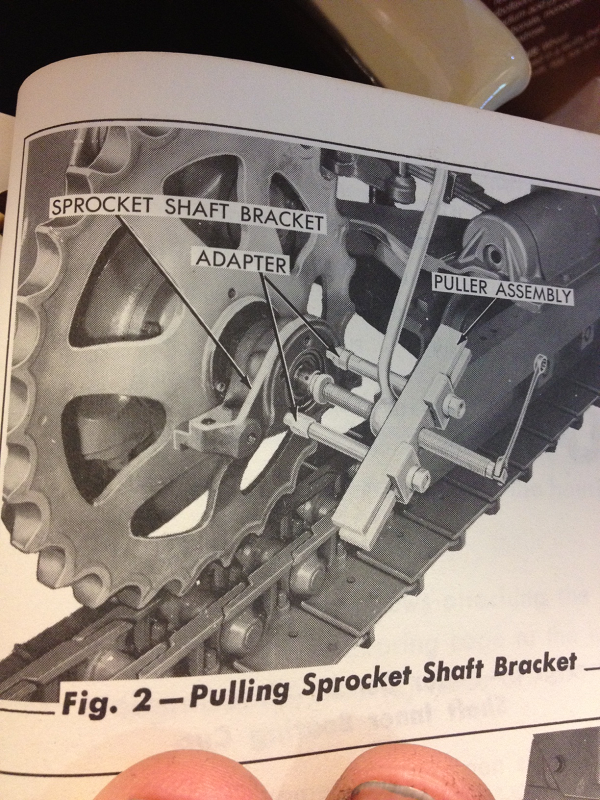

i hope this helps. it is from a hd5 service manual burt they are the same bearing and housing. good luck

Does anyone have a picture of the puller used to get the outdrive bearing off of the shaft on the final drive? the one mounted to the truck frame outside the sproket. Thanks
