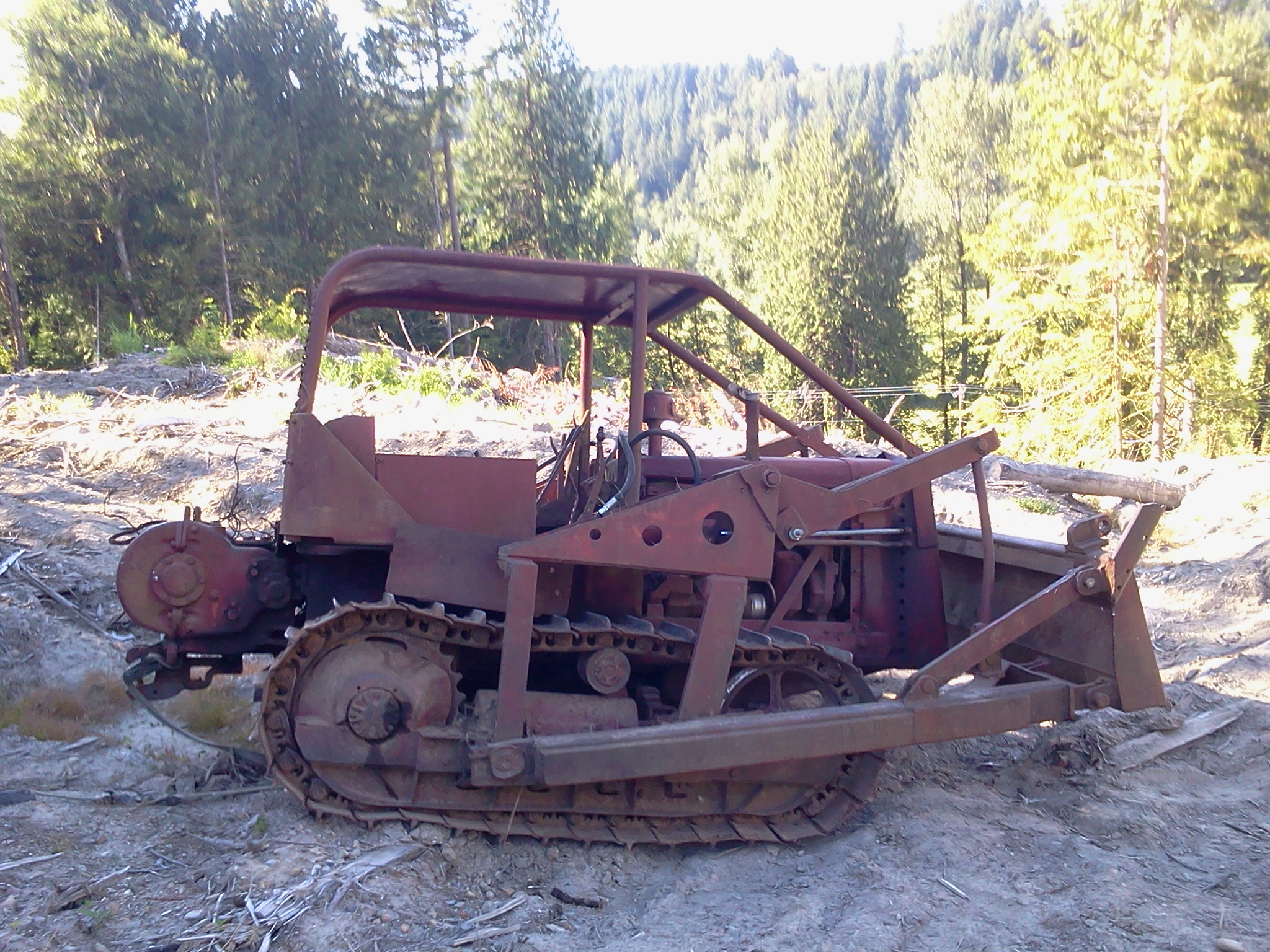

I read in another post that the 24v starter requires two 24v batteries is that a type"o" or is there two 24v batteries hooked in parallel

Right and I did hook two twelve volt batteries in series to bench test the starter the shaft turned about a 1/4 rotation both batteries were fully charged the post I read on this Web site said it was a 24 volt starter powered by 2 24 volt batteries never heard   of a system being hooked up like this? Anybody have a manual that confirms this? I just bought this machine a week ago don't
Know much about it HD 6 is about the only thing I could make out on the data plate. The blade set up looks like an HD 5 any ideas on a possible year? New to a/c any info would be helpful thank you!
